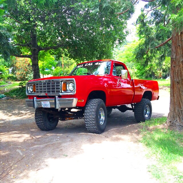

Yeah I wanna stick with the W100/W150 because of the smaller wheelbase. I love that look of a short wheelbase shortbed with a small lift, much more than a longbed. Much like this one (but maybe with an inch or two less lift, and a few inches smaller tire size).
If the functional difference is mainly springs then I'd just find some heavier-duty springs to swap in.
About a foot to tall for me.

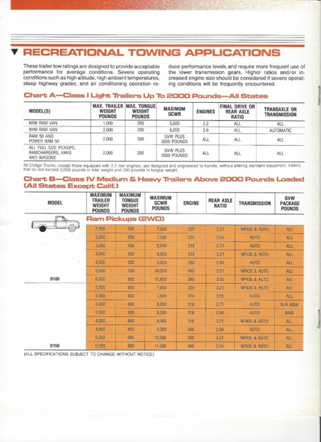

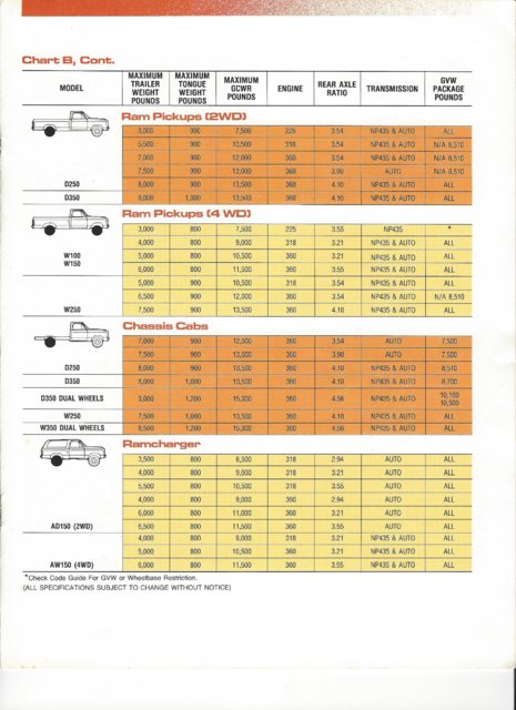

Initially, to my understanding, it was done for some emissions variance - they classed the D150 as heavier duty so it didn't have to meet "passenger" vehicle emission standards. Not quite sure how they made that differentiation, especially if you check the scans below from the 86 Dodge factory towing information sheet. They also split out California vehicles, (didn't scan CA specs), but from a quick spot check I didn't see any big difference in load capacities or anything else although I did see one truck went from a 3.54 axle to a 3.55 in the chart.
I don't know what emissions variance there would have been the 82 D150 miser /6, 4 spd od, lean burn, air pump and cat. Not sure what else for emissions would have been required for a non-Cal truck.
View attachment 12069 View attachment 12070 View attachment 12071 View attachment 12072
Yeah the chart shows the W100 and W150 pooled together, so doesn't look like TOO MUCH variance between em. The different load ratings seem to mainly pertain to the engine and axle ratio. The 318 they're saying is only good for 9000lbs GCWR, but I'm bettin that's based on a bone stock 318 turnin that somewhat-higher 3.21 ratio(did they have the 8.25" rear axle? I might've asked before but that was about the D100). Obviously I'm planning a twin turbo 318 build, plus here's a fun fact about the 318: it's the same block essentially as the 340 and 360, just lower-flow heads and smaller bore and shorter crank throw just doesn't travel full cylinder (leaving extra cylinder volume in addition to the combustion chamber, of course that's gonna lower compression). The 318 should be ready for mild forced induction, just need to swap the heads out.

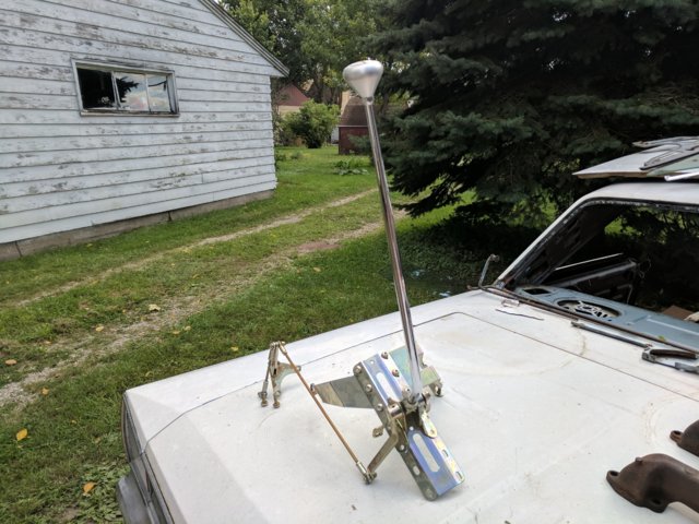

Ah so go for a manual and try to swap in an auto steering column?
I have a Lokar shifter I'd sell ya for a good price, only been mounted, never in a vehicle.
If you didn't want to source a column, and felt like putting another hole in the floor! (Handle is backwards in the pic.)
