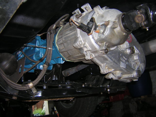

Im just glad the 518s have a lockup option, now just hoping they fit a power wagon tunnel.
they should fit they were in RAMCHARGER as well and they 've got the same floor pan.

Buddy of mine done the conversion in a 1979 RAMCHARGER years ago it's why i know tranny fit .
He was involved with a crossmember swap as i remember because of the size of 518/np241 not big deal if you have the right crossmember and front / rear shaft from the donor vehicle.
Nope just a Ramcharger the crossmember was swapped because the truck was 2wd
