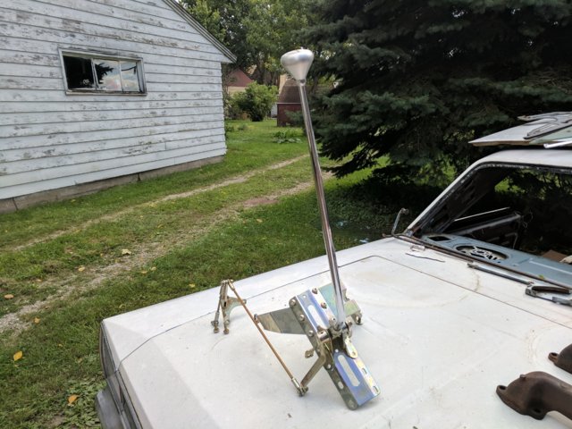

I have a Lokar shifter I'd sell ya for a good price, only been mounted, never in a vehicle.
If you didn't want to source a column, and felt like putting another hole in the floor! (Handle is backwards in the pic.)
I appreciate the offer, butI'll stick with the column shifter for stock appeal (and yes I known I'm voiding that by swapping powertrain

That's fine, I'm just a smarmy salesman at heart! I thought I'd use it, but I don't want to modify the truck that way, interior-wise, I'm just swapping seats, and maybe the dash. Otherwise it's so spartan I just need to redo the color of the panels.

Yeah besides a halfway decent stereo, shifter for 4x4, and switch for OD unit I'd wanna keep the interior stock as well, so that it looks like an old-school rig but has the newer gear in it to make it efficient and more powerful plant. If that lokar was shorter and could be used in place of the 4wd shifter then I'd take you up on it
It's only 16" tall! It shirts ohhhhh sooooo smmooootthhhlllyyyy... :hungry:
I went back and forth a few times, trying to determine if I'd use it or not. If no one buys it, it might find it's way into the truck, I don't ever plan on someone sitting in the middle. But I do like the openness of the one shifter- just had a thought. What if I used the lokar for the 4wd selector? That could be cool! Not as tough as that short little stick, but I wouldn't have to bend over so far. I might be onto something.

Yep that's what I was sayin, may look a bit outta place for the regular shifter (on an auto) but it'd look pretty good as a 4wd selector. If someone does sit in the middle, just make sure theyre skinny!
