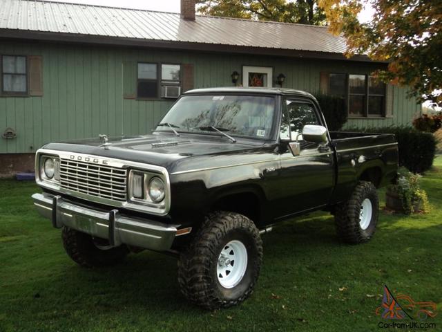

See I figured that when trying to carry over my 4WD transmission, it might fit in a legit 4WD platform instead of 2WD, so why not shift the goal to a 4x4 platform? Have that 4WD for winter/offroad plus a heavier base for occasional towing. What ratio are those 77-78 W100 axles usually geared to? They came with anything from the slant 6 to the 360, and the 318 would be right in that ballpark, so the axle would imaginably be geared for that, but I'm still curious.
