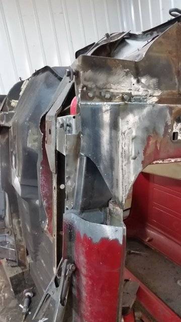

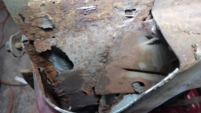

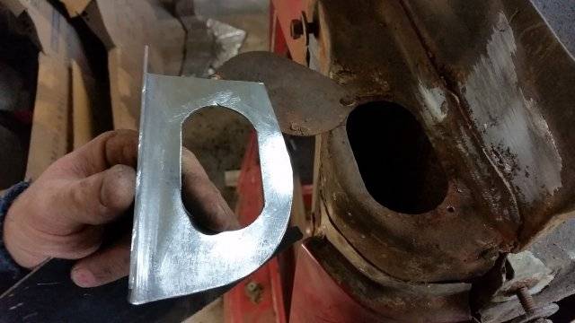

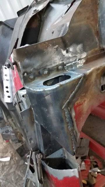

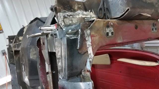

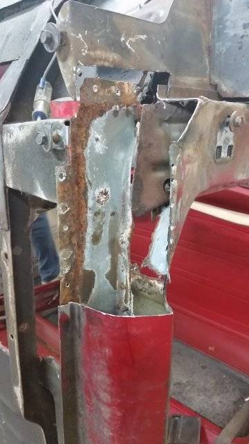

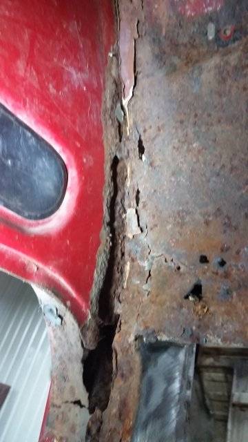

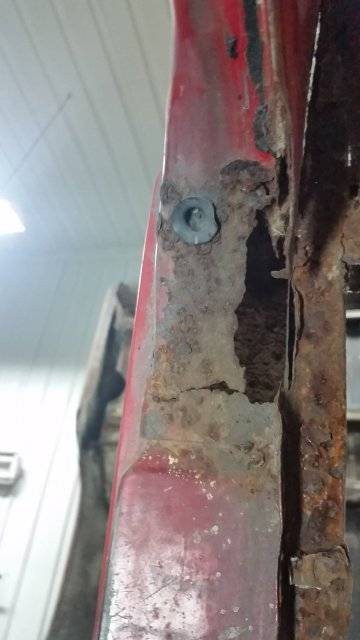

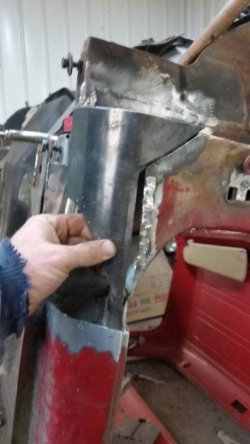

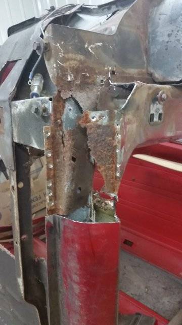

What a mess, after allot of thinking it was obvious that I had to cut a perfectly good outer rocker off to get to the layers of rot. Not fun making patterns off of metal in that bad of shape but I think I got it all fixed, still need to weld the outer rocker on but ran out of welf threw primer but that's a 5 minute job so no biggy.
Waiting for a little welding but that's it, this was the worst spot on the truck so I'm glad to put a fork in it.

NIICE work on the body you got going there!!!!!

Nice fab work on the panel's "747mopar" ! And I 100 % agree on your ideas about motors . I like the way you think ! I see us getting along "real" good ! :D
