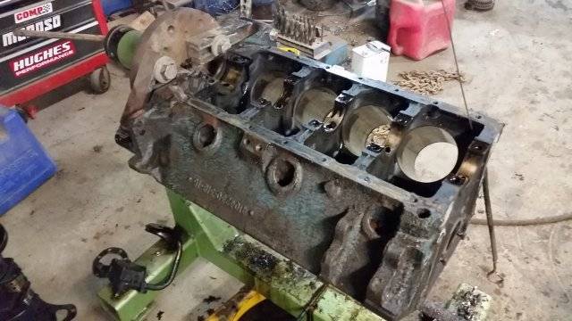

Finished stripping the block, ready to get honed and cleaned. The water jackets were a mess, holes rusted all the way threw the frost plugs where the build up of crap behind them was the only thing allowing the motor to even hold water.

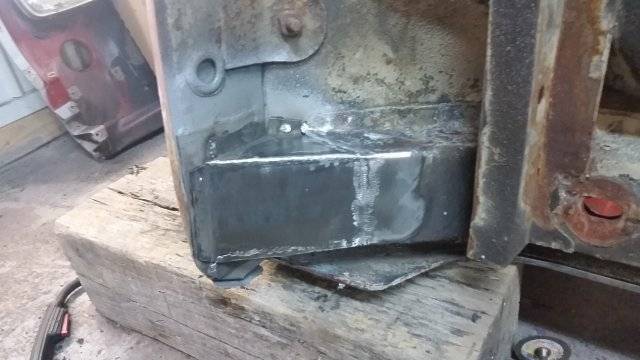

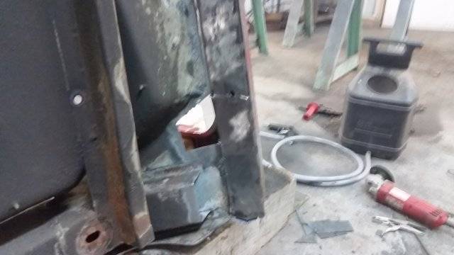

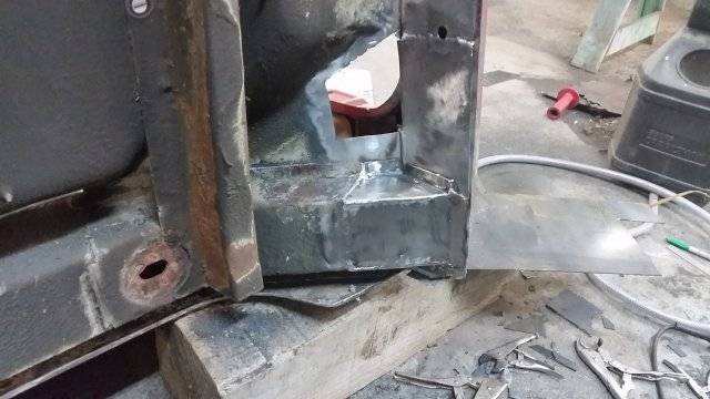

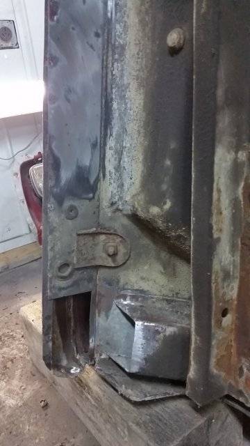

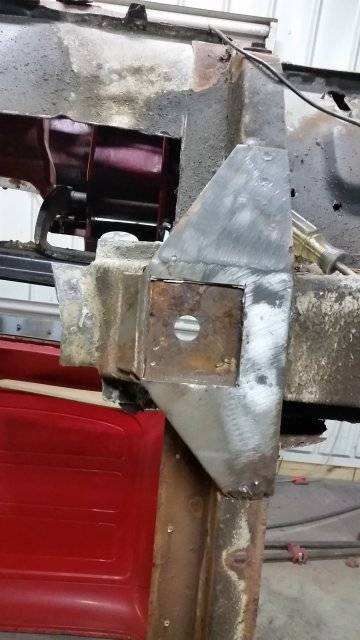

A few pictures after removing all of the rot.
The repairs to the rear support, this is all I had time for today.

Yuk ! That motor had some build up all right ! You "are" going to send it out and have it tanked , Right ? Good job on those supports ! I can understand taking some time out for the Charger , there isn't to many good days left before the white stuff comes . I did the same thing the other day myself . I took the Warlock out for a lil blast . The funny thing though is I came across a local Mustang that "think's" he's fast . Let's just say , the way I pulled on him , it looked like he had thrown an anchor out the window ! lol I don't think he'll be trying that again . lol

Yep, believe it or not I threw the block, heads and crank in the carpeted trunk of the Charger and hauled it down...... allot more fun to drive then the Dakota! I did throw down a tarp though and no harm done.
