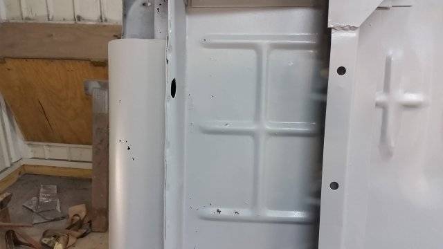

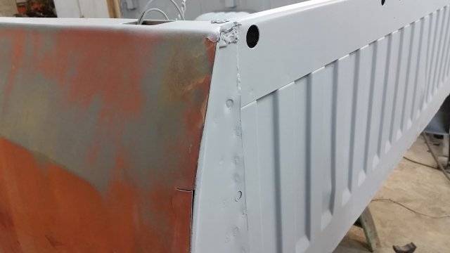

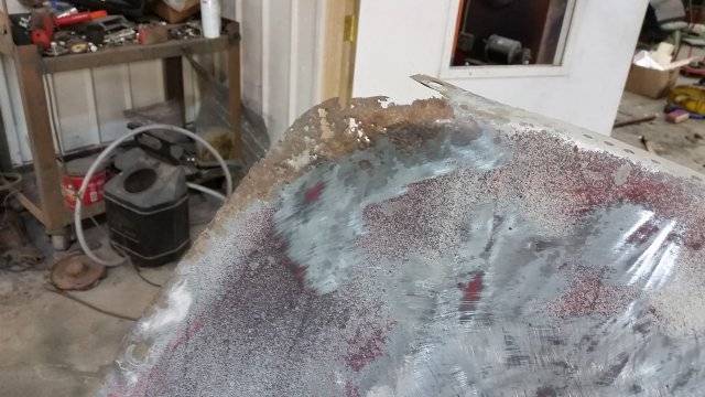

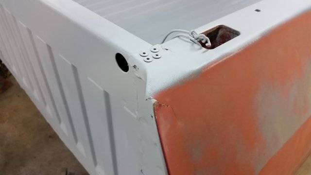

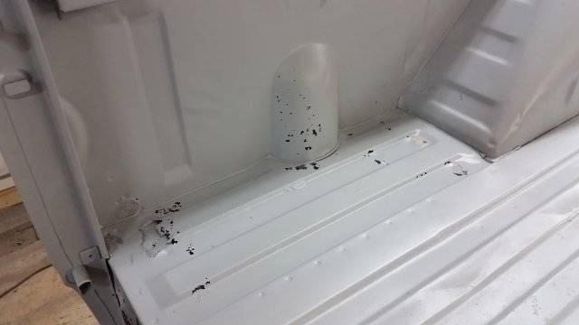

I haven't posted in a while, I've had parts out for blasting leaving me with nothing to do but here's the updates. Got the cab and bed back, no surprises with the cab other than a couple pin holes showed up in the rockers...... The bed is a different story, very depressing! I'll be removing the whole entire rear support (structure under the tail gate), there's pin holes all threw the inner bed sides and patches needed everywhere. I went ahead and epoxied everything to keep it from rusting because I'm going to welding for a while!

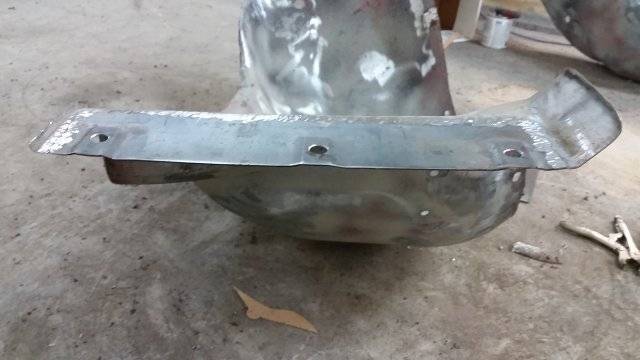

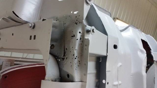

Spent all night patching the inner fenders, now I can say I at least have 6 pieces of the truck that are rust free now! 1 piece at a time..........

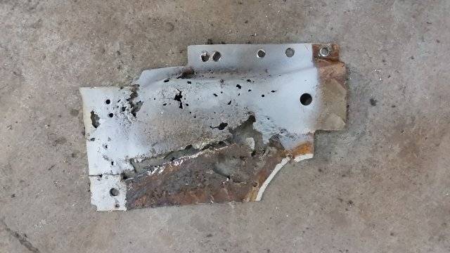

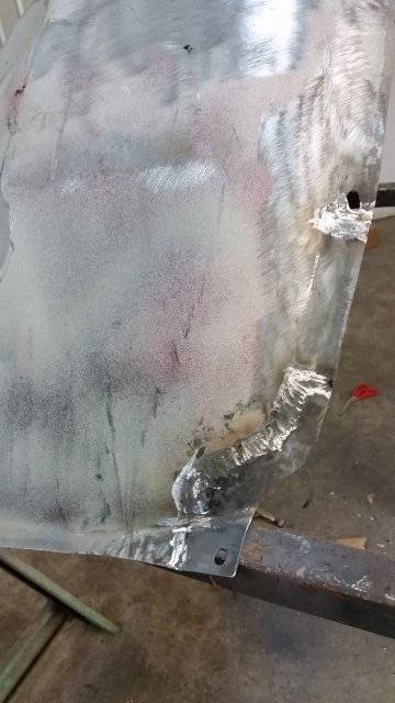

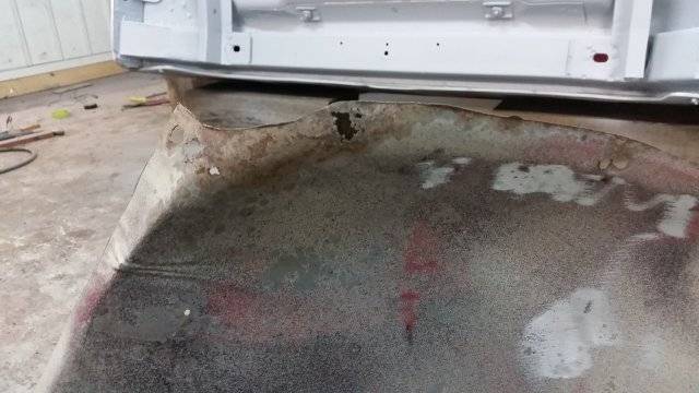

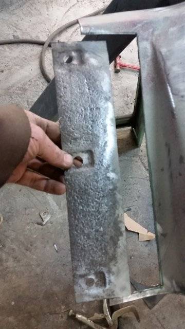

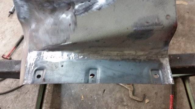

Finally fixed what I've been puting off, this is not a fun repair but this time around I did a little better than on the other side. Here's what came out for a pattern..... pretty bad!

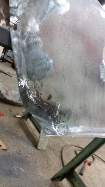

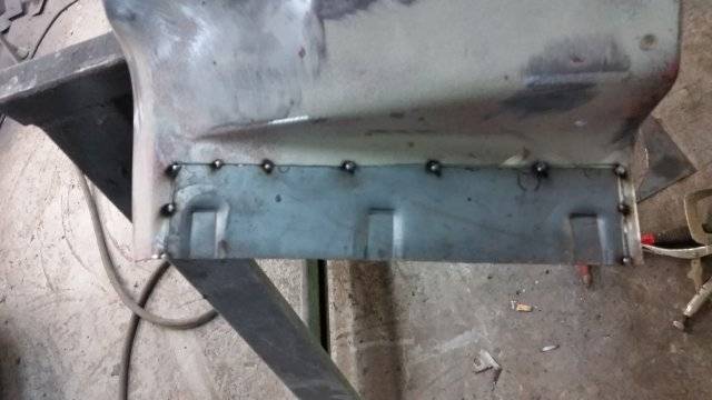

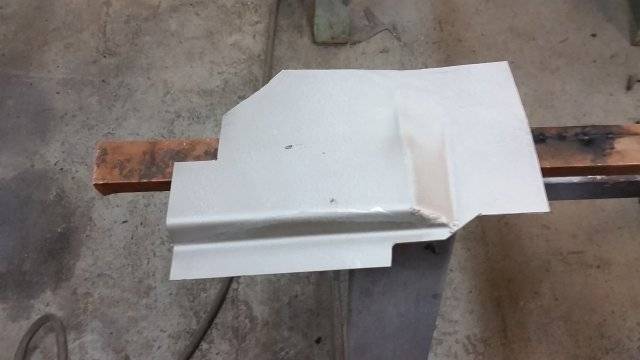

Here's the replacement after about a half hour, pic doesn't show all the weird transitions and angles.

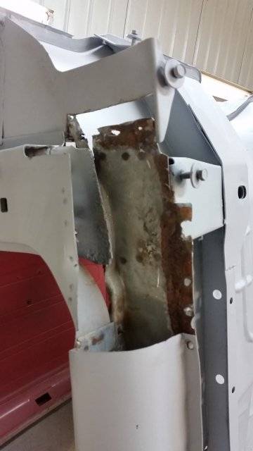

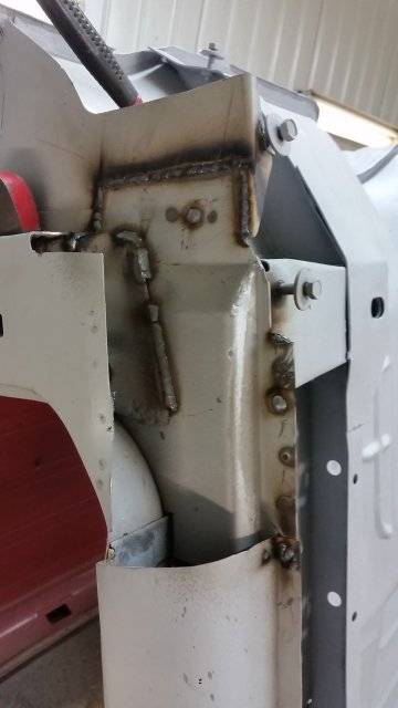

The inner rocker was surprisingly really clean, just a light blasting cleaned it right up for some weld threw primer.
And the finish product, this booger slides between the floor and extends into the inside of the cab so like I said... fun

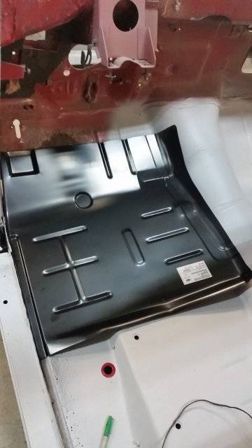

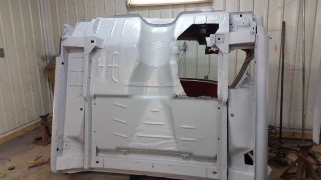

The Sherman Floors look really nice, very happy with them.

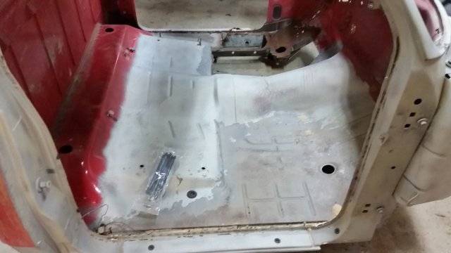

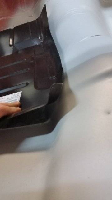

Only issue with the floors is that they don't fit the tranny hump contour but that's easy enough to trim up and get fitted. Unfortunately this floor is gone all the way to the tranny hump and past the front edge of the floor panel so a little extra patching will be required.

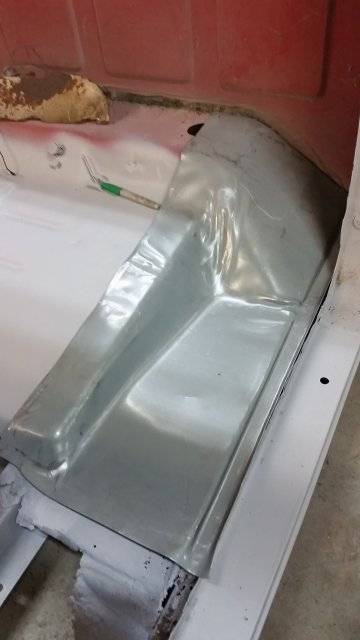

Here's the rear section in place, pretty nice other than all the wrinkles.
