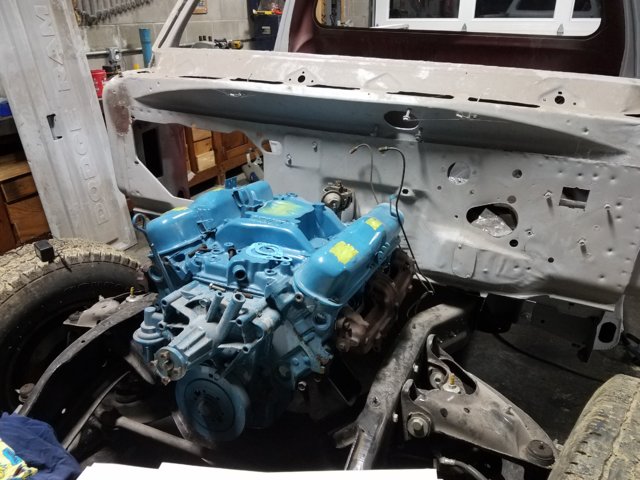

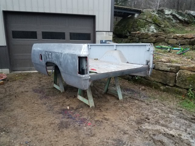

Logged some hours today, patch done (mostly) and it's been chemically stripped and sanded so bodywork can begin. I say almost because I'm fighting a buckle in my fender patch, had it looking good until I took the D/A to it! There's still some more patching to be done but it's in the fenders and the bed floor so it won't affect the body work.
Almost forgot... stripping it revealed that it's never been wrecked, no filler:praying:
Didn't realize that I hadn't updated this either. Engine is 100% rebuilt, bored, heads completely gone through, all new pistons, bearing, healthier camshaft and a Eddy Performer intake in place of the 2 barrel. I got sick of tripping over parts so I put new seals in the tranny, bolted them together and sat them in place with all new mounts.
Still trying to decide on a carb, I love my Quickfuel but Holley bought them out so I don't know that I'd get the same thing? I absolutely despise Eddy carbs so it's either a Quickfuel, Holley Avenger or possibly Demons new spread ore but it won't be bigger than 600cfm.

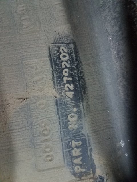

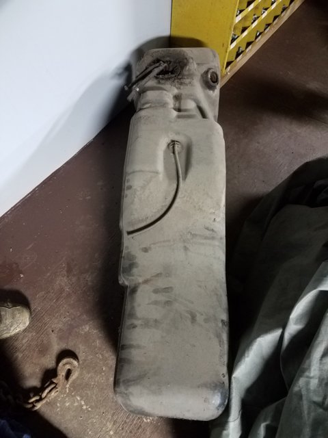

Anybody know what size tank this is? Not having any luck looking it up so I suppose I'll start filling it with water to find out how many gallons it is.
Got a picture of the whole tank? Moat I've seen were the 32 gallon variety, mounted aling the drivers side frame. Rear tank between frame rails was a 20 gallon I think.
your doing that one up nice , great job . but your thread tittle got me thinking on my dads dodge i learned to drive in . still got it sitting there just waiting for a resto or hotrod .
Okay then............
82/83
20 gal 4185 353
30 gal 4185 354
84/85/86/87
20 gal 4279 842
30 gal 4279 843
No matches............
