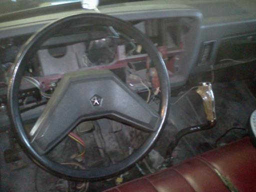

Lucked out at the Junk Yard today found a manual transmission steering column.

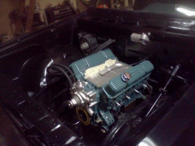

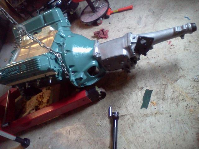

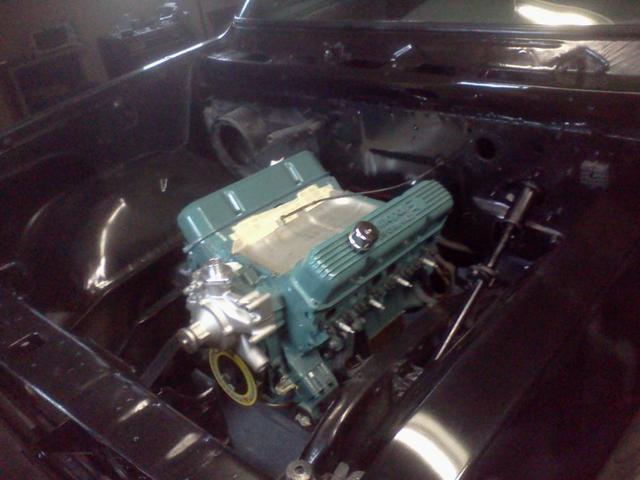

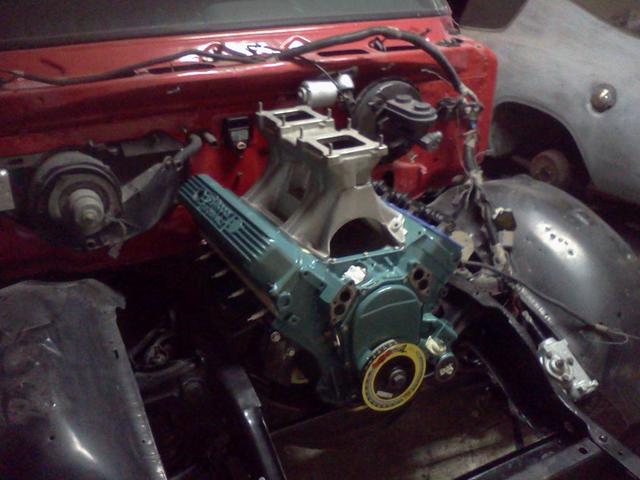

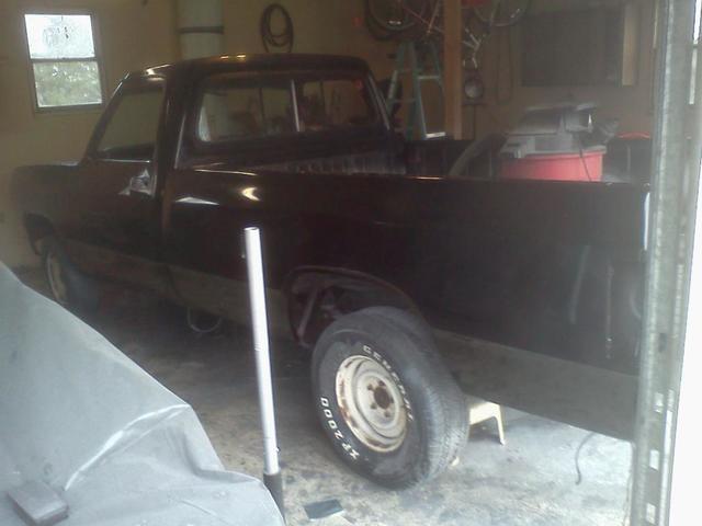

Haven't updated this in a while but progress is being made to the truck. The 383 and the A-833OD are married together and installed in the truck. Cut a hole in the floor and are working on a new transmission tunnel. If your paying attention you may notice the truck changed its color, I'm building it the way I want, and I really didn't like the nubs for the trim. So they were all ground off, the holes for the trim and the emblems on the side were welded up, and we blocked and re-painted it.
I rebuilt the manual steering gear, rebuilt the steering column and Borgeson steering shaft are installed and all new MOOG steering linkage.
Mancini Racing aluminum water pump housing, high flow water pump and 190* high flow T-stat installed.

Biggest difference, I'm ditching the Carbs. I'm going to try QFI fuel injection (keeping the tunnel ram).

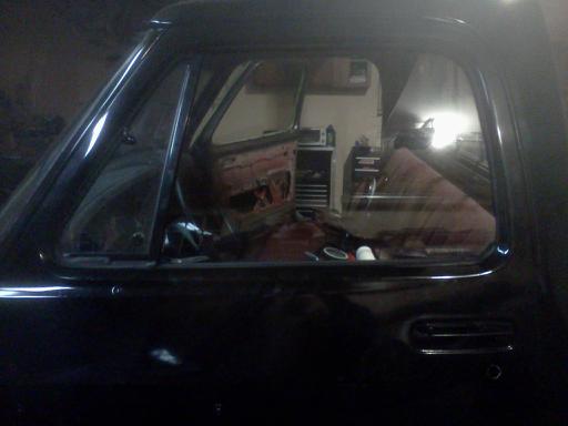

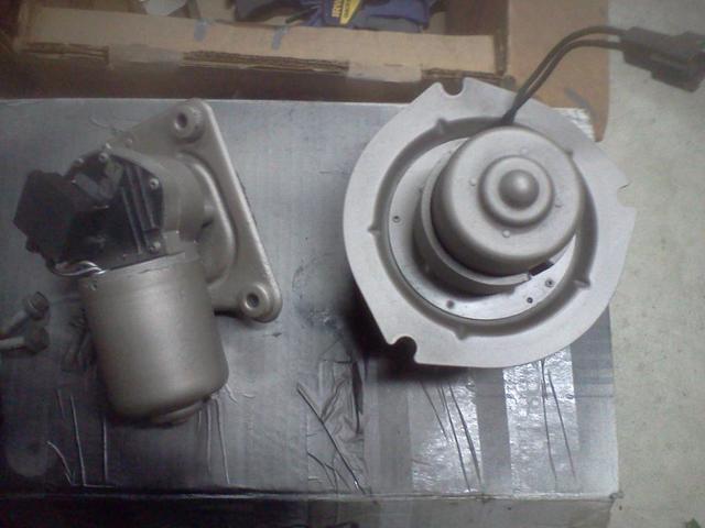

Got the fan, and wiper motors painted and installed today. Painted the inside of the passenger door. Installed the glass in the driver door today. and partially installed the heater hoses, I need a heater valve yet. I have been blacking out all of the chrome on my truck, I'm doing this because I'm making my version of a Midnite Express Truck. I received my "Midnite Express Truck" decal in the mail yesterday along with the "Dodge Ram" tailgate decal. Both decals are flat black.

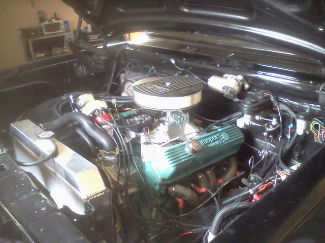

So the plan was to go with fuel injection, couldn't seem to find something that would work with the Tunnel Ram set up, so I switched to a RPM air gap for now, along with QFI's Throttle Body fuel injection system.
After I bought The QFI kit and reading the instructions I discovered that the QFI system is supposed to be able to run 2 QFI TB, but for now I'll just stick with the Air Gap for now, down the road I'll swap it out to see a difference. I think 2000cfm thru 2 TB might be a little much for the 383 though.
The shifter linkage is connected, had to get the 1-2 rod shortened, because I switched the the ball and detent side cover, the operating lever wasn't clocked right and the shift linkage was to long, couldn't find one that would work so we had to shorten it.
I'm using the QFI system to control the timing also, so I had to get an MSD distributor, that I was able to lock out the mechanical advance.
Wrapped the headers, I know they will probably rust out but I figured what the hell. Best price i found on headers are from BPE, they are actually made by Hooker for BPE,even though the collectors neck down to 2.25", I cut the collector off where it necked down and welded on a 3" flange. So now I have a 3" collector. Still cheaper than Hooker headers with the 3" collector. Sandblasted, painted with header paint on the outside, and Eastwood internal exhaust coating on the inside, so we will see how it holds up.
We got the rest of the sheet metal painted and the hood installed.

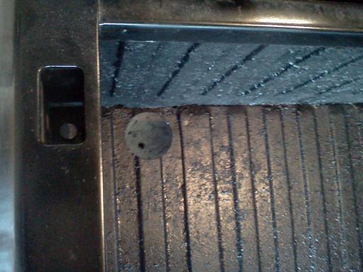

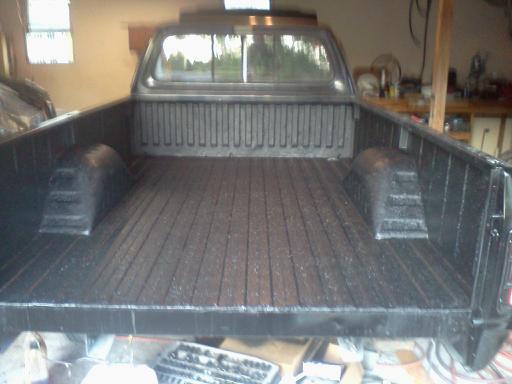

Update. Holes for stacks are done. Roll in bed liner is done. Used Dupli-Color Bed Armor, turned out pretty good, I'm happy with it. I'm putting a bed cover on and I probably won't be using the box to much, but we will see how well it holds up. One thing, the scuff pad that is included in the kit is definitely not enough. Along with scuffing the paint sufficiently, I had some rust in the box I had to take care of. Ended up using wire wheel, a nylon wheel, scotch brite pad and Eastwood Rust Converter, spent several hours cleaning, scuffing and more cleaning the bed.

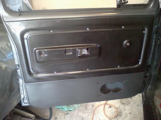

Got a new toy this week. A Rivet Nut Tool. I am changing the door panels in the truck to earlier steel door panels. The dimples for the screw holes to hold the door panels on are in the '85 doors, they just need to be drilled out. I could of done that and just used some sheet metal screws to hold them on. But, I wanted to make it a little nicer and I'll put a rivet nut in each hole.

Hear is a sneak peak of the driverside door panel. I have to get the arm rest made/ re-upholstered. But everything looks like it should work fine.
Maybe someone has some original arm rest pads for the steel panels ... They are slightly different. I have a set of steel panels myself but not the armrest pads.
