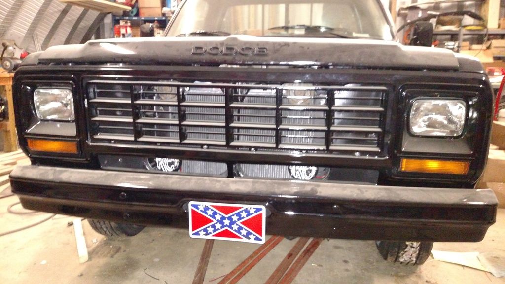

KC lights:

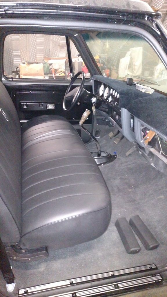

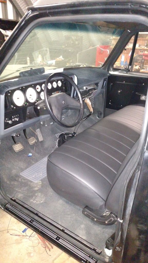

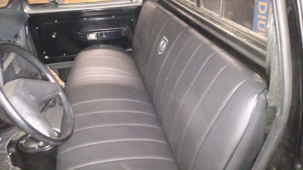

Interior, I had the seat covered in katzkin leather and the Ram head added. Armrest are also covered with leather. Turned out good they just covered over the original molded armrests. I need to put them on yet.
Good shot of the pistol grip shifter:
Do the armrests bolt direct to the door or is there a trim piece that goes between it and the door. I think they just bolt on right? Can you show a better pic and give length of the ones required?
What length are they?

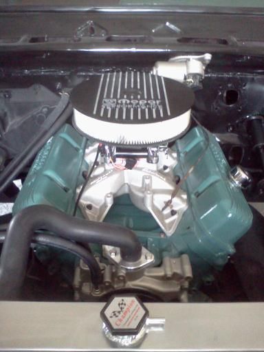

So the plan was to go with fuel injection, couldn't seem to find something that would work with the Tunnel Ram set up, so I switched to a RPM air gap for now, along with QFI's Throttle Body fuel injection system.
After I bought The QFI kit and reading the instructions I discovered that the QFI system is supposed to be able to run 2 QFI TB, but for now I'll just stick with the Air Gap for now, down the road I'll swap it out to see a difference. I think 2000cfm thru 2 TB might be a little much for the 383 though.
The shifter linkage is connected, had to get the 1-2 rod shortened, because I switched the the ball and detent side cover, the operating lever wasn't clocked right and the shift linkage was to long, couldn't find one that would work so we had to shorten it.
I'm using the QFI system to control the timing also, so I had to get an MSD distributor, that I was able to lock out the mechanical advance.
Pistol Grip very nice!

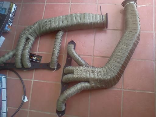

Wrapped the headers, I know they will probably rust out but I figured what the hell. Best price i found on headers are from BPE, they are actually made by Hooker for BPE,even though the collectors neck down to 2.25", I cut the collector off where it necked down and welded on a 3" flange. So now I have a 3" collector. Still cheaper than Hooker headers with the 3" collector. Sandblasted, painted with header paint on the outside, and Eastwood internal exhaust coating on the inside, so we will see how it holds up.

Look'in good ! I bet you can't wait to the first time you take it out for a ride ! :) By the way , Are those billet door sills or did you black out the original one's ?
Very nice. Can't wait to see it all finished. Makes me kinda want to paint my 84 black, that truck just looks mean.
The screws for the armrest screw into the inner structure of the door, the door panel is sandwiched in-between them. I used rivet nuts, hopefully this will be a little stronger.
They are billet one from LMC.
That is the look I was going for. I didn't want to have any chrome on the outside, and just a couple of piece on the inside.
The arm rest is almost 10" long and 3" tall, they come out from the door panel 2".

So with the 833 OD I wanted to make it shift as smooth as possible, so I wanted to ditch the lever & interlock side cover and swap in the better, ball and detent side cover. The truck 833OD and car 833OD are slightly different one being the gear ratios; the truck has a higher OD ratio and the side covers are different and will not swap between car and truck OD cases.
To use the ball and detent side cover I had to use a car 833OD case. So I have truck 833OD guts in a car 833OD case. I had the front of the case bushed where the countershaft is pressed into the case, to increase strength.
Alright now to the shifter. The pistol grip shifter is for a 1970 B-body, aftermarket bolt on one. It was a 1 year only handle so good luck finding a original press fit one. The truck uses the same shifter mechanism as the A-bodies. But if I used that pistol grip shifter with the A-body mechanism the throws would be a mile long and you would smash your knuckles on the dash. So the mechanism is also a 1970 B-body to accept bolt on handles.
Now with the linkage and transmission operating levers, If anyone is interested enough I'll look to see what ones I have on there. Depending on what car the trans was in the operating levers are different also. So I don't remember what ones I have on there now.
But since I changed so much stuff around, we couldn't find an operating lever that would fit correctly with my combination. So we shortened on of the rods by an inch and i should of done the other as well by about 3/4 of an inch.
I had to changed so many things to make it how I wanted, so I had to do some customizing. But it all worked out in the end.
If you just want to change the shifter mechanism and go to a Pistol grip shifter but keep the lever & interlock side cover, you might not have to change as much as I did.
Jamie Passion of Passion Performance really helped me out with this. Give him a call and he should be able to get you everything you need.
