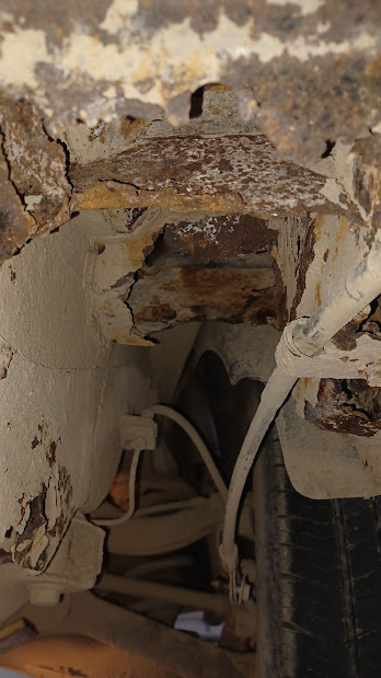

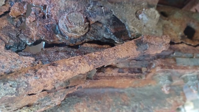

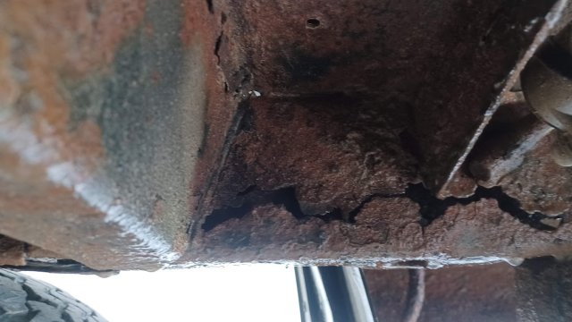

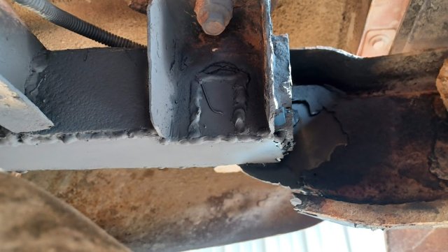

Saturday morning started with a little breakfast, 3 cups of coffee, then I dove into frame repair on my Colorado. The bushing for the leaf spring shackle was coming off the frame because of rot.

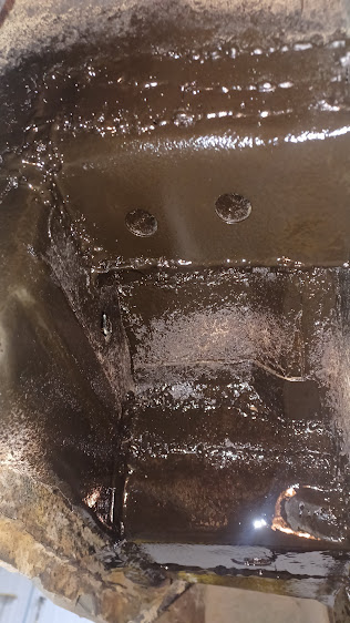

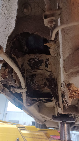

This is the inside of the passenger side frame rail where the bushing sits, the top of the shackle can been seen in the bottom of the pic

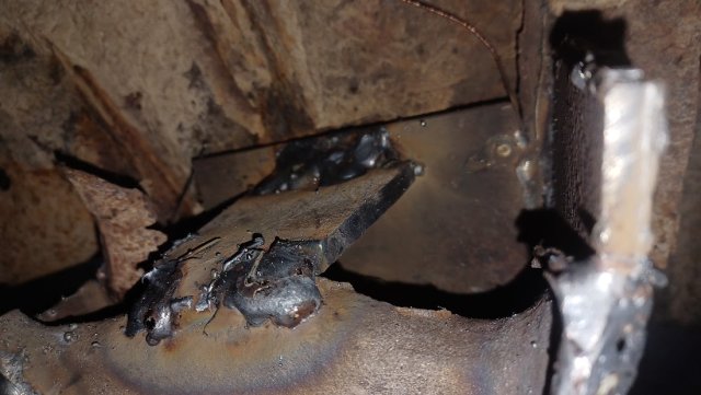

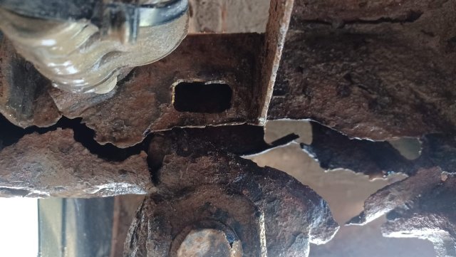

Part of the inner frame rail

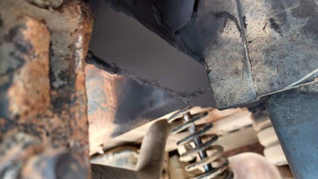

Here is the bushing again and the hitch

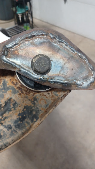

This is the bumper bracket, the side of the hitch can be seen in the background. The bumper bolts actually came out. I cut the hitch off, I don't think I am goint to put it back on. I use my plow truck if I need to tow anything.

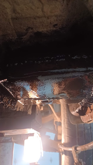

This is the inside of the frame after the repair, the back side of the bumper bracket

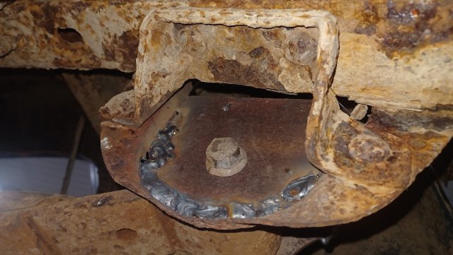

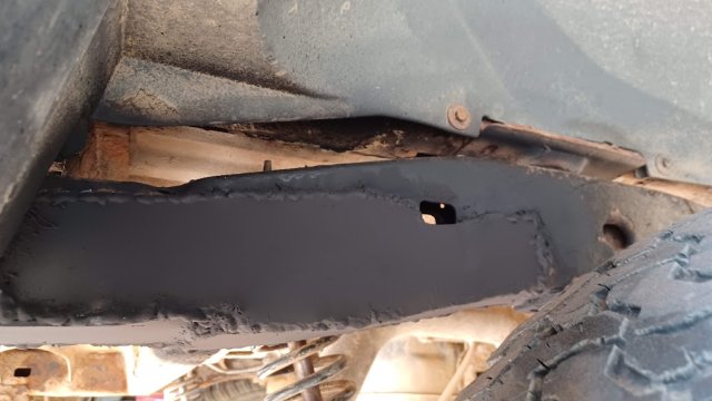

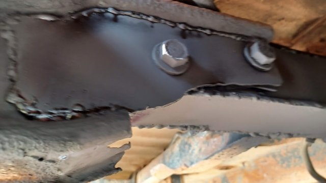

Repaired frame rail and shackle bushing welded back in place
More of the repaired frame rail
More of the repair
The outside of the bumper bracket
Some of the welds are not my best work and don't look the prettiest, but they are strong

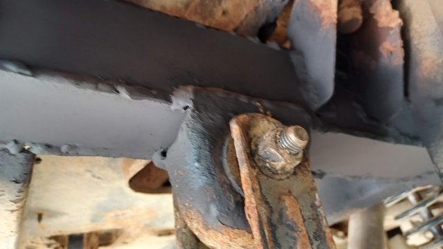

New metal in place and a coat of undercoat sprayed on. This is looking forward

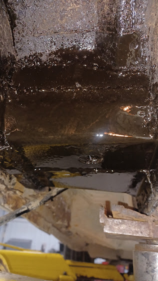

The rockers are rotten, but this will keep it running until he can decide what he wants to replace it with. 301,000 miles on it

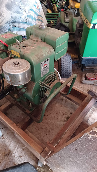

I had 2 cups to get started moving this morning, stopped in the McD's drivethru to get a 3rd cup on my way to plow snow. After I got home I went out into my shed and looked at this for a little bit.

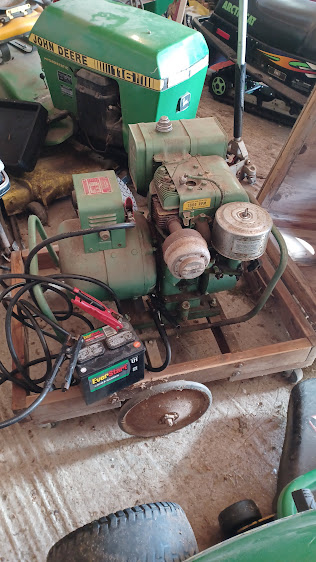

Not that I need it right now, but I would like it running just in case. A friend of mine gave it to me, he didn't need it anymore. They bought a different house and he now has a whole house generator.
It's a older unit, but it should do the job. The spark plug was clean, but no spark. I pulled the cover, cleaned the points and spark was restored. I need to make a mount and cables for the battery, if I don't want to pull start it. My feet started to get cold so I called it good for today. I have to get some rec gas anyway

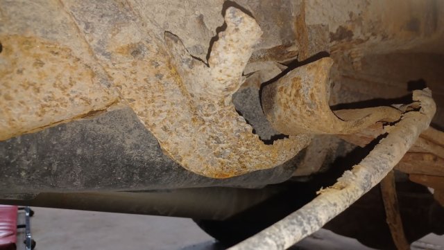

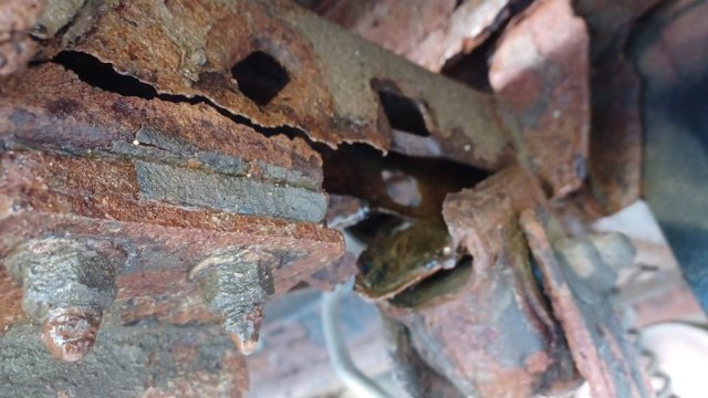

I sat around this morning drinking a few cups of joe and watched some you-tube, I went out to my plow truck to go clean up a couple of parking lots and I say something hanging from the e-brake cable. Turns out it was a bushing with some steel, I started looking where I came from and found the front mount for the rear leaf spring rotten and the top of the spring eye broken.
This is what I had to repair, I did a quick repair

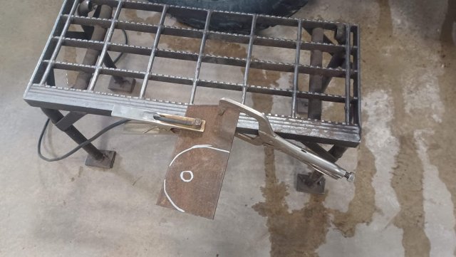

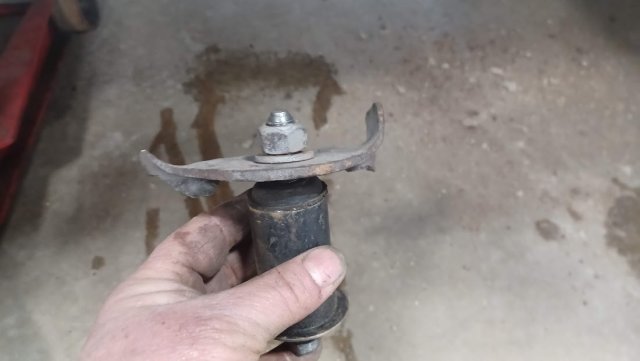

I dug around the shop and found a new bushing, and cleaned the outside piece of the old hanger in the sand blaster
I cut a new piece with the plasma cutter to put in the hole

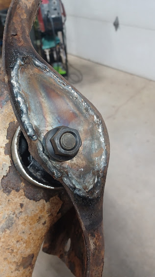

I welded it in from the back side

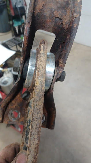

The bushing in place, a piece on each side and one on top
Not my best work, but it's functional. I didn't spend a whole lot of time on this repair, I need to get it together to plow some more. I am going to be working on the replacement for this truck soon.
