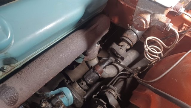

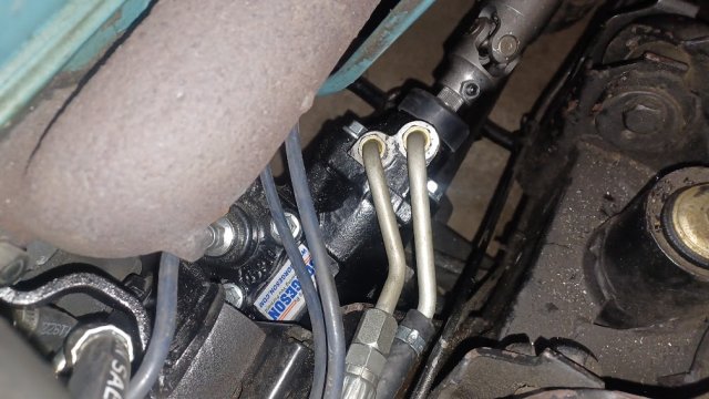

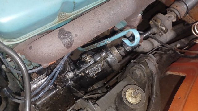

So this morning I started off with 2 cups of joe for motivation and got ready to install a Borgeson steering box and Saginaw P/S pump on my father in laws 65 Sport Fury. Pulling the old box was easy and modifying the end of the steering column for the coupler wasn't too bad. I ran into a issue with the P/S pump mounting. The 65 big block in a C body uses a 1 year only LF side motor mount and the back of the pump hit the mount. This is when the fabrication started.

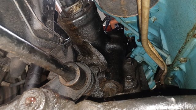

This is the old box after I removed the pitman arm

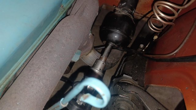

This is the box and the shaft at the column coupler

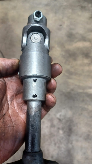

This is the shaft after the lower coupler has been removed, the shaft shortened, the Borgeson joint fitted, drilled and the roll pins drove in.

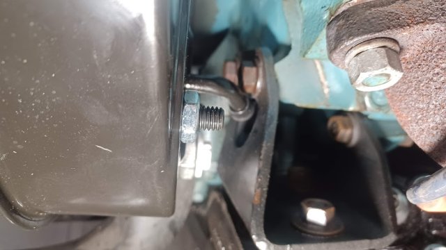

I have the box installed and the shaft remounted and this is when I noticed I had a issue with the motor mount clearance
You can see how close the return fitting is and the pump bracket isn't even tightened up yet

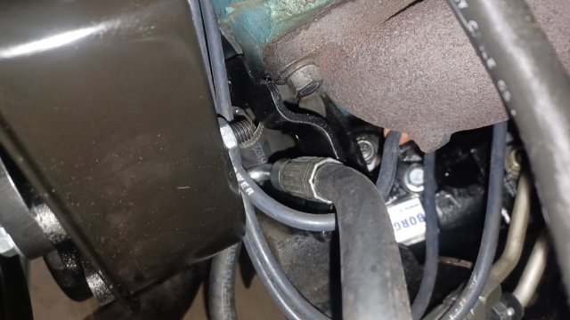

Here is the modified mount and the lines installed. I didn't think to get a picture of the mount before I installed it. I was in the grove and just forgot
The box, coupler and modified mount

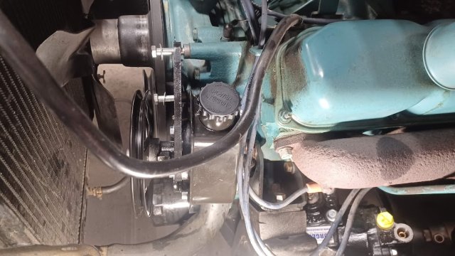

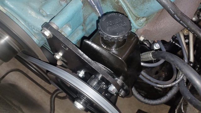

The pump mounted, tight, belt on and engine running
I also had to replace the battery, it didn't survive this winter. 3 years old and it wouldn't take a charge. Father in Law drove it home and is very happy, drive much better. I had a lot of wander before and had to chase the wheel a lot. Just need to have the alignment checked, Borgeson wants 3-4 degrees of positive caster.

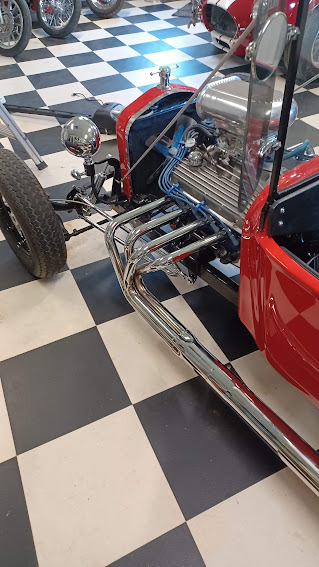

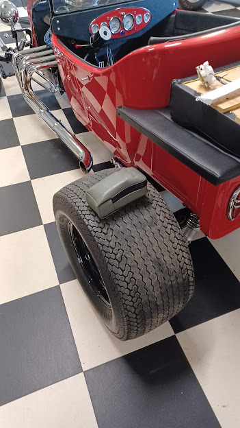

So I worked on this last Saturday after a half pot of coffee to get me going. I belongs to my son's boss

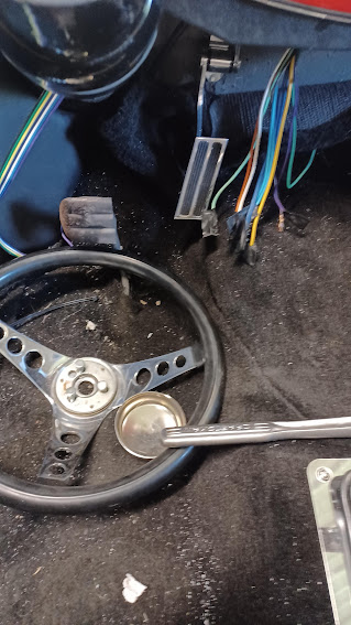

He rewired the whole car with an American auto wire kit, but was having trouble wiring the turn signals.
I removed the switch that was in the column to test the circuits, I found that it was bad and finally located what it was from. The column was from a GM, the switch fits 64-66 Gm truck/full-size car, corvette, 64-65 corvair/nova. I had to wire it to the harness. Rewire the tail lights, they are LED and can be wired to use 3 wire or 2 wire input. I then figured out we needed a electronic flasher also. Using LED's in the front and rear, there isn't enough load on the flasher to make it flash. Electronic flasher fixed it, lights all work, turn signals and brake lights. He is one happy camper

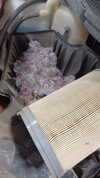

2 cups of coffee to get me motivated this morning, I went and mowed the church with my boy. I finally changed the oil in the Colorado and found this in the air box
They must have been busy, I drive this truck just about every day. The only time it sat was when I had to plow snow this last winter, I would plow in the morning at work and drive it back to work after truck
Squirrels or mice do that? That's a lot of bedding material.

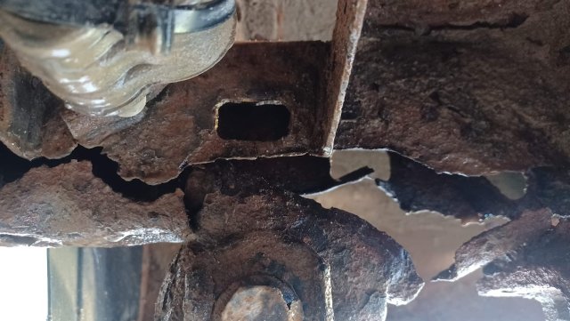

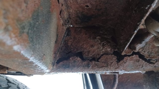

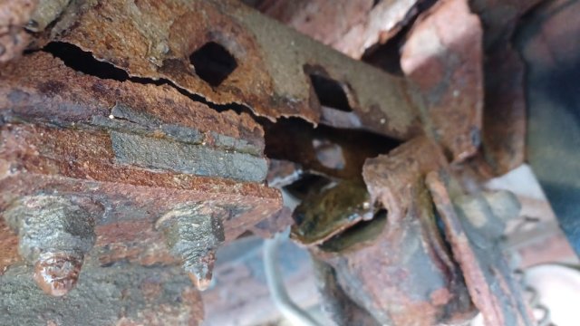

Saturday morning started with a little breakfast, 3 cups of coffee, then I dove into frame repair on my Colorado. The bushing for the leaf spring shackle was coming off the frame because of rot.
This is the inside of the passenger side frame rail where the bushing sits, the top of the shackle can been seen in the bottom of the pic
Part of the inner frame rail
Here is the bushing again and the hitch
This is the bumper bracket, the side of the hitch can be seen in the background. The bumper bolts actually came out. I cut the hitch off, I don't think I am goint to put it back on. I use my plow truck if I need to tow anything.

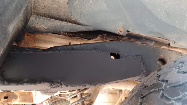

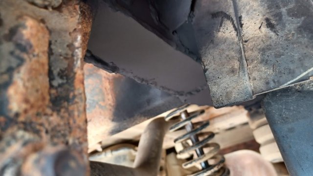

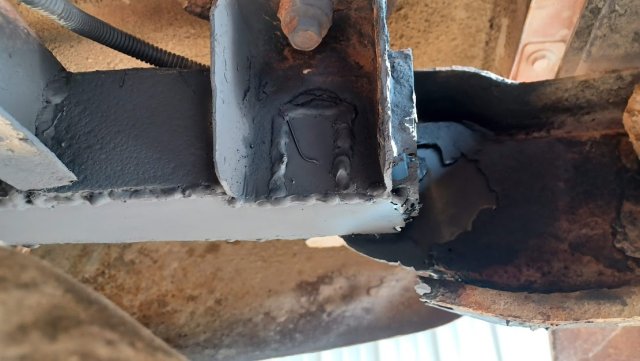

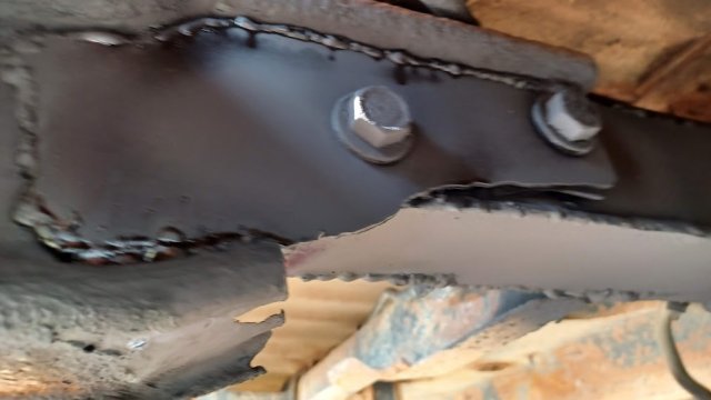

This is the inside of the frame after the repair, the back side of the bumper bracket
Repaired frame rail and shackle bushing welded back in place
More of the repaired frame rail
More of the repair
The outside of the bumper bracket
Some of the welds are not my best work and don't look the prettiest, but they are strong
