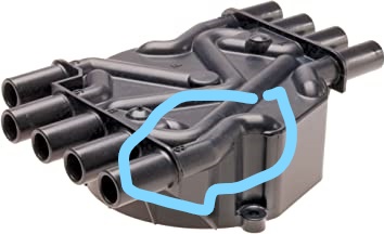

Started with 2 cups this morning, picked up a dist cap on the way to the shop and changed it out before I started work. Misfire is gone.
It must have burnt through somewhere in this area. I couldn't see it, but #2 and 8 had misfires and they are running next to each other in that area.

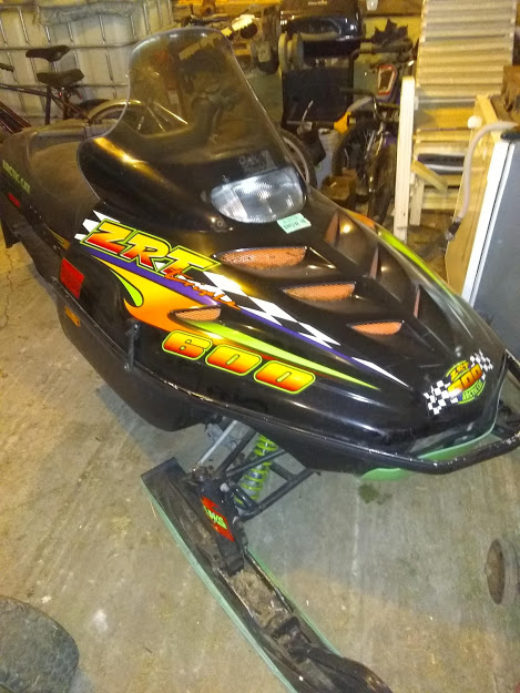

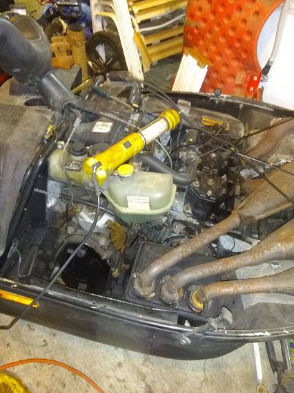

Started with a cup this morning, picked up my kid to help me pick up a bed for some friends, stopped at Mcdonalds and got a coffee, dropped off the bed, filled the truck and got my freebie coffee with a fill up, came home and did some work on this.....

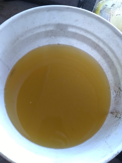

I drained the fuel tank and found this.....

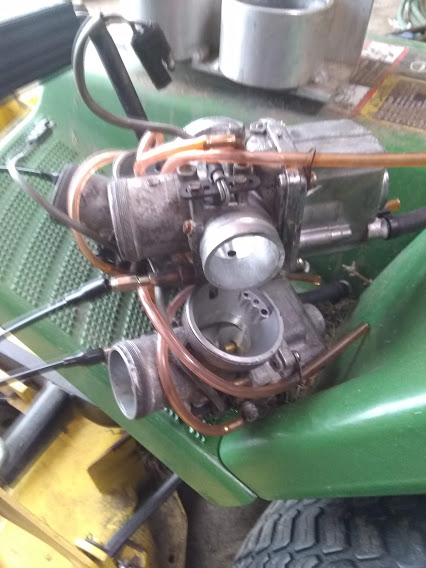

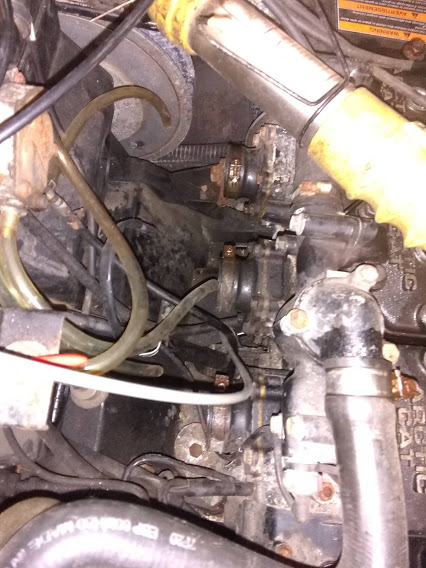

Full of water, pulled the carbs to clean and soaked the choke on the one with break away. It is stuck and the cable is broke, I have a new cable for it
Pile O carbs...

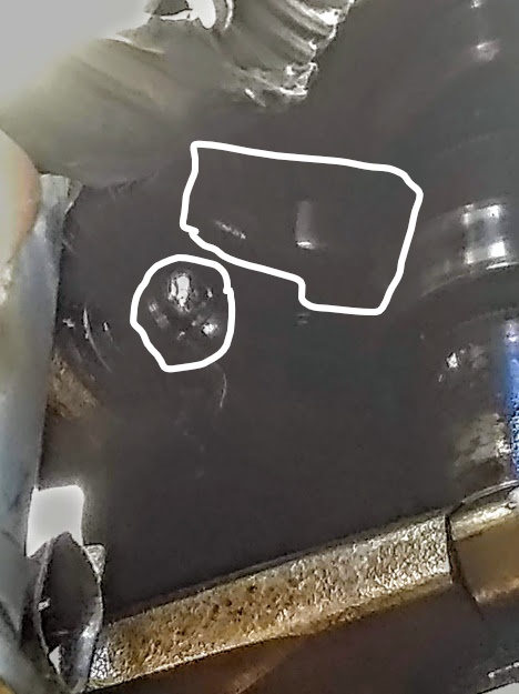

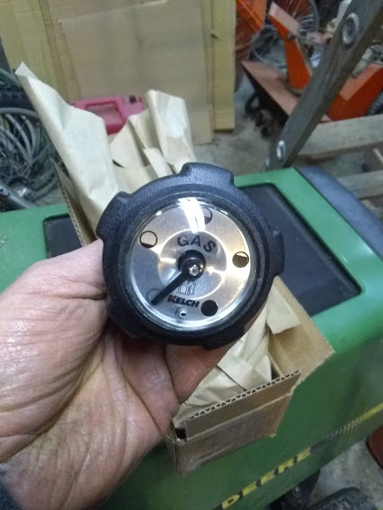

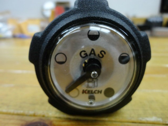

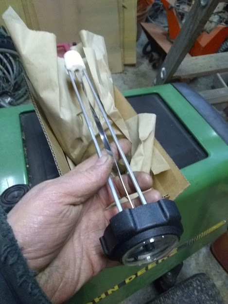

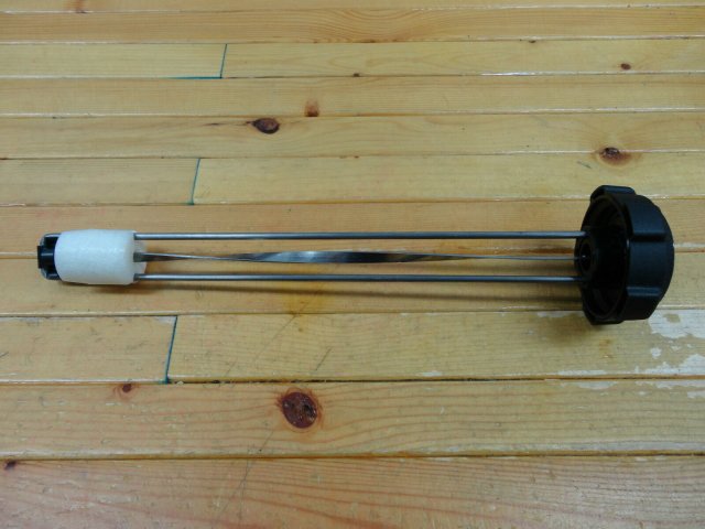

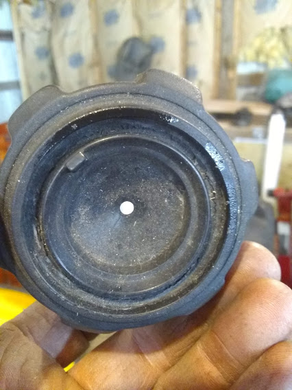

This is the cause of the issue, the fuel cap had a level gauge and now it's gone and piled up it the tank leaving a hole for water to get into the tank.
I ordered up one of these...
I just got this sled this spring, I sold a 73 Arctic Cat 440 Panther to a guy and he traded this to me for a 77 Ski Doo TnT 440 Free Air that I had. I think I got the better deal
Pile O carbs...
That looks like the ZR I crunched into a tree, it was red-ish. After they got it fixed (it wasn't mine) their daughter did the same thing, but into the gas pump island!

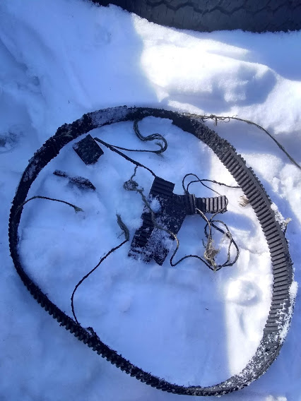

1 cups to start, went through Mc'Ds, got some rec 90 fuel, came back home and started my heater in the shed and went to work on my sled. Got the carbs back on, choke cables installed, seat back on, blew out the fuel lines and fuel pump, filled the tank and tried starting it. It took a little bit because of the water loaded fuel that was in it. Finally running, changed the plugs and we took it out of the shed. Ripped it some and shredded the old belt.
My new fuel cap came yesterday also

I sent the kid after a new belt yesterday, we got it on and that's when I shot those short videos. Man is it quick, a lot faster then my old sleds.

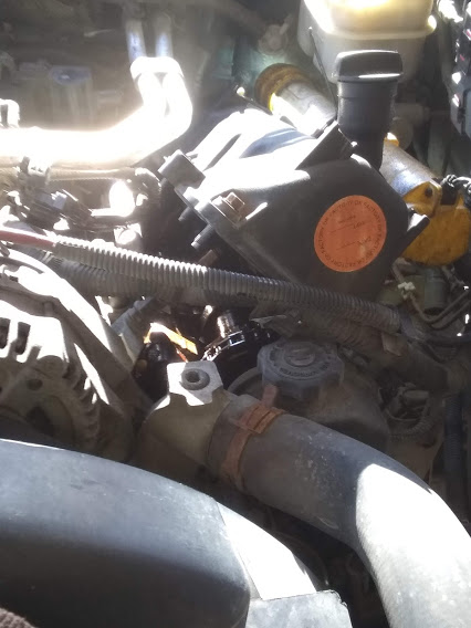

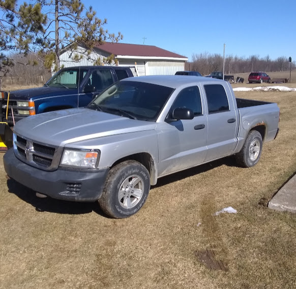

I got back home and worked on a 08 Dakota for my other sons friend, this kid has been around for about 16 years so I guess he is like one of our own. He will usually help out when I work on his stuff, but he had to work. The 4.7 in it had a misfire, he already changed the plugs and #3 coil so I checked the injector, pulse signal to the injector and coil and compression. I pulled the valve cover and found the #3 exhaust rocker arm out of place, popped it back in place, put the valve cover back on and 8 cylinders again.
Not the best picture, but you can see the lifter tip without the rocker arm and the # 5 intake rocker arm
