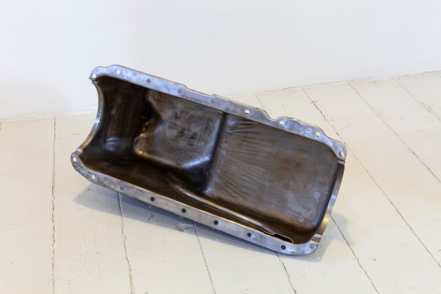

Found a million little bits of nylon in the oil pan, as expected. Don't know how this thing was getting oil at all... the oil pickup screen was jam packed with them. Cleaned the pan and now replacing the rear main seal before closing it all back up. Any tricks to getting out those rope-style seals other than a Sneaky Pete tool and some swearing? There's no way I could keep the existing rope seal up top and install a rubber seal on the bottom, right?

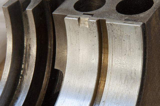

The half of the main I removed looks sorta...bad? The bearing, I mean. There are marks on it, and some grooves. But no extreme wear or anything. The crank itself looks flawless, shiny, no ridges or scratches of any kind, nothing i can feel with my fingertip, so I'm a bit stumped as to why that might be, or whether I should replace the main bearings. Feels borderline?

Yeah, I've owned a lot of used vehicles - just never owned a basket case before! It's a different thing. There was a ton of gunk in the pan - that image is after I cleaned it up. But yes, doesn't sound as bad as the gunk you had in the International. Thanks for the encouragement. It'll get done.
