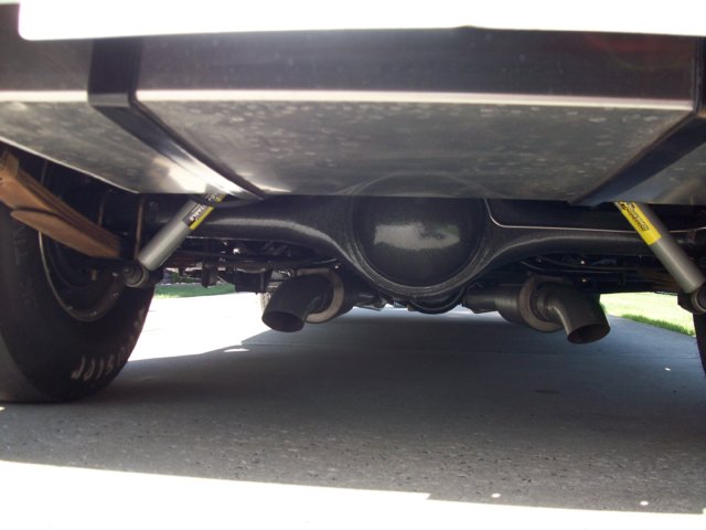

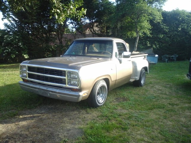

It was a pretty simple mod. I choose not to cut the springs. The axle flip the same except we used car spring plates. I now need to remove the helper springs. As you can see the front is a little higher than the rear. I’m thinking of putting some shock springs to bring the rear up just a bit
Yes really simple and i love the stance when lowered . Nicer with fat tyres on the rear 265/60/15 on 10x15 rims
255/60/15 on 7x15 front.

Axle flip in the back is nice and easy. Just need a new spring mount pad welded to the axle after you set the pinion angle. It is also a good idea to set the angle of the shocks different. I set mine to the same degree as a Dart.

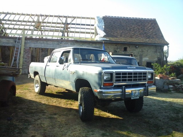

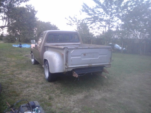

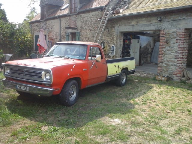

Any 72/93 lowered truck has a perfect stance. Shortbed look fat( chubby) with big fat tyres on the rear. Look like she is sticking on the road easy to handle and carry small goods. Love her as daily driver. Got a 85 crewcab 4x4 which is lifted 5 " with 35s" like her as well and think a 4wheel drive is such a nice BIG truck lifted that way. My other truck is my beloved 73 D200 former fire truck in normal standard condition and i enjoy driving her a soon as i can .

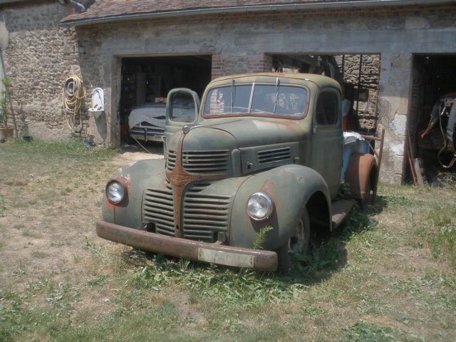

Next project wil be a vintage 46 Job rated pickup will gave her a Hot-rod treatment lowered frame Ifs and a turbo super six... To be honest love them all whenether been in a good day or not, you can see the smile in my face while enjoying driving them.

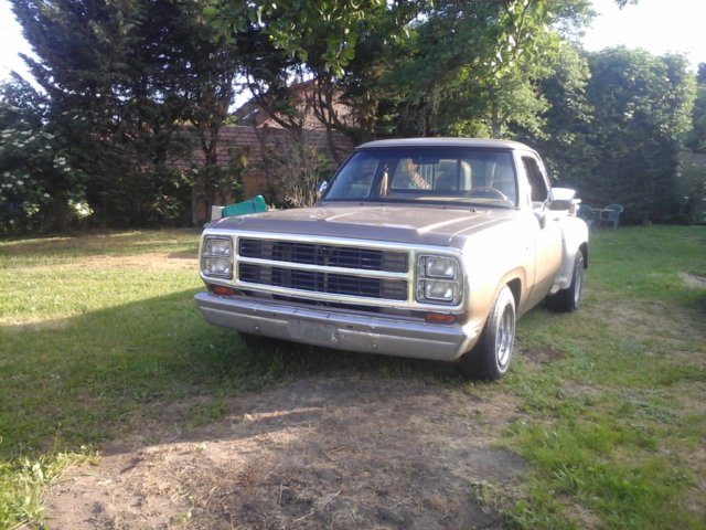

The 73 has 255x60x15 tyres on 16x7 wheels. The 79 utiline is lowered using Dakota dropped spindles and axle flip tyres are 255/60/15 15x7 rims for front 275/60/15 for the rear on 15/10" just love the stance.
