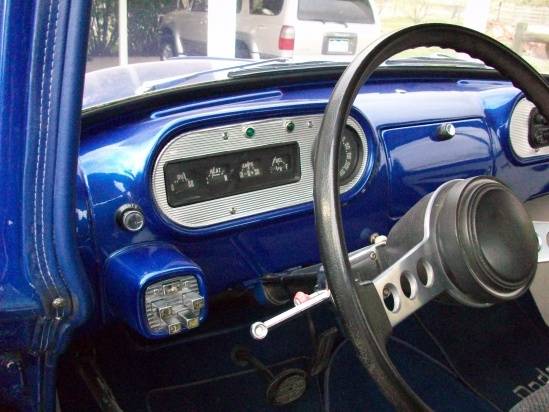

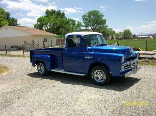

My 57 is a mixture of parts but still retains the original push button automatic shifter. Right now its running a stock mid eighties 360 with an aluminum air gap intake topped with an edelbrock 650 carb. Its got a set of shorty headers running out to duel exhaust. The 727 automatic is a 64 that was in it with a poly 318 when I bought it. The tranny was modified to run LA small block torque converters so who knows what might wind up in there. The 8 3/4 rear end is also out of the 64 donor car. The front end is the original straight axel with the exception of the 79 pickup power steering setup. With the viper blue and bright white mixed with loads of blue pearl paint, the big window cab, and the unusual one year body style it gets lots of attention and thumbs up whenever I'm out with it. The truck gets driven too its been my daily driver for close to 10 years and over 40 thousand miles. Started out it was just going to be a landing spot for spare parts but things kind of snowballed to what you see. Its got A, B, & E parts chrysler and newer truck stuff some I had some I just had to have. But theres only one part not mopar and its the front bumper off a scout, I just don't like how bulky the originals are.

The blue & white pickup is my 1957 D-100. It was a one year only body style and was the first year Dodge pickup hoods opened from the front. Previous to this they had what was called a clam shell hood which opened from each side with a strip down the middle.

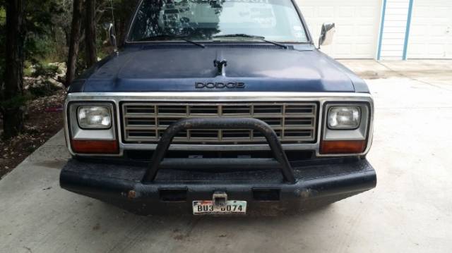

Looks like you could do some serious damage with that front bumper ! If I drove an import I think I'd be getting out of your way if I were in front of you . lol
