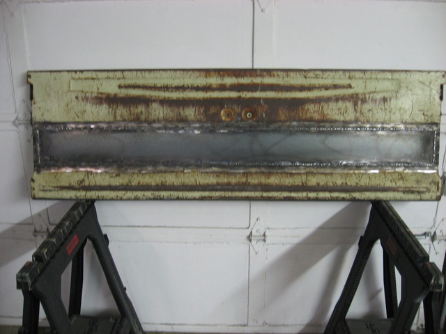

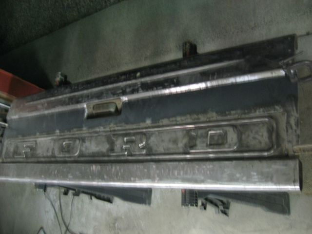

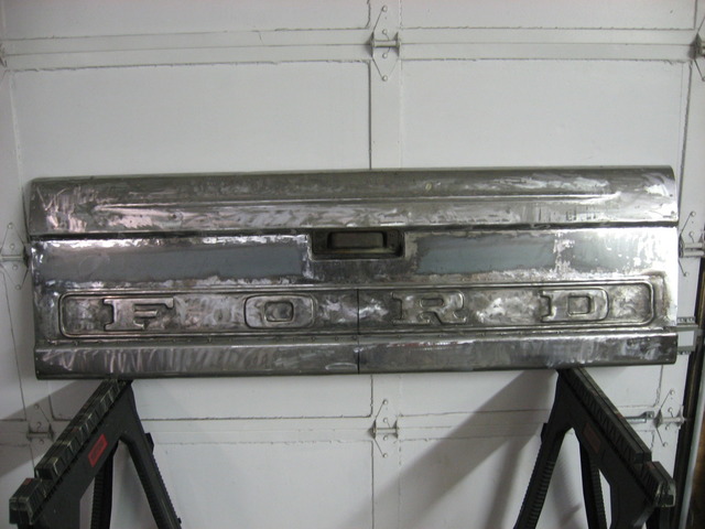

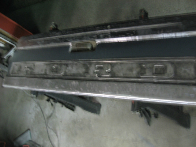

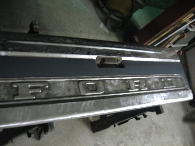

Then I cut out another panel to fit over the larger area.

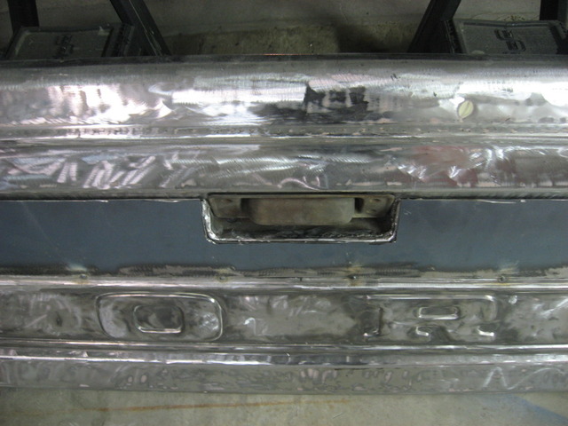

This was what I thought of when I thought of a double wall tailgate. I know other guys have put a panel over like this but I've never seen one with the stamped "FORD" added back in.
Marked the panel and then cut out the spot for the "FORD" and then tacked it in to it's new spot.
A lot of work right there,but it looks awesome !! I like how you were thinking outside the box,because you're right,people would have just put the flat panel over !! I'm likin it a whole lot !! Keep up the great work,I can't waite to see the finished product !!

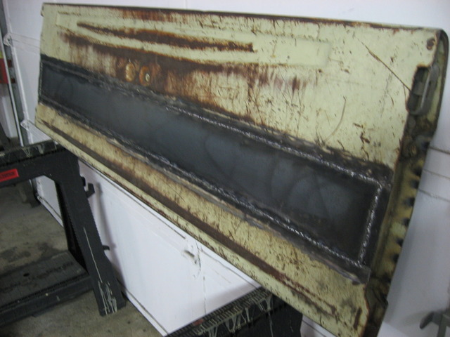

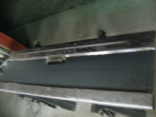

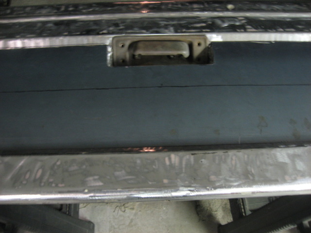

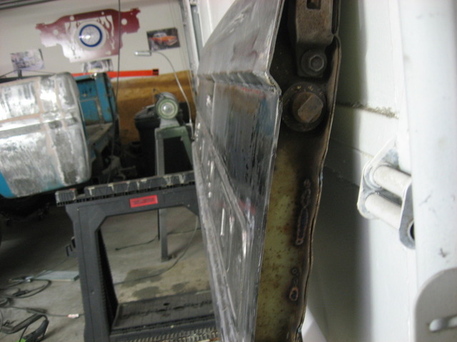

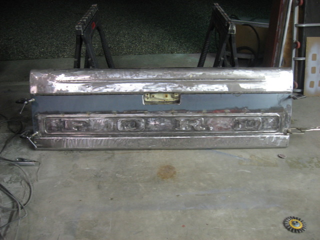

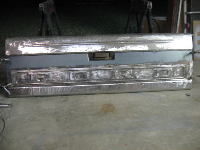

So the tailgate mods are going well. I really like the way it is turning out. I finished welding up the patch panel where the stamped "FORD" was. It is welded on the inside and the outside, so that should help with sealing it from water and stuff. I also put down a good 3 coats of weldable primer on the underside of the new panel and in the empty space in the tailgate now.
The panel is now tacked on and all is well so far.... no waves or anything in the panel yet from the heat.
Just trying to take my time and not rush it. I wanted a smooth tailgate but didn't want to give up the the old school look of it and I think that this does both.

Well after a needed break away from the project, got back to it yesterday. I cleaned up the shop put everything back in order & then continued the spot welding on the tail gate. About 300 spot welds later I called it a night. So about another 900 spot welds to go and the tailgate mods will be done. Hope to be posting pic’s of it finished soon.

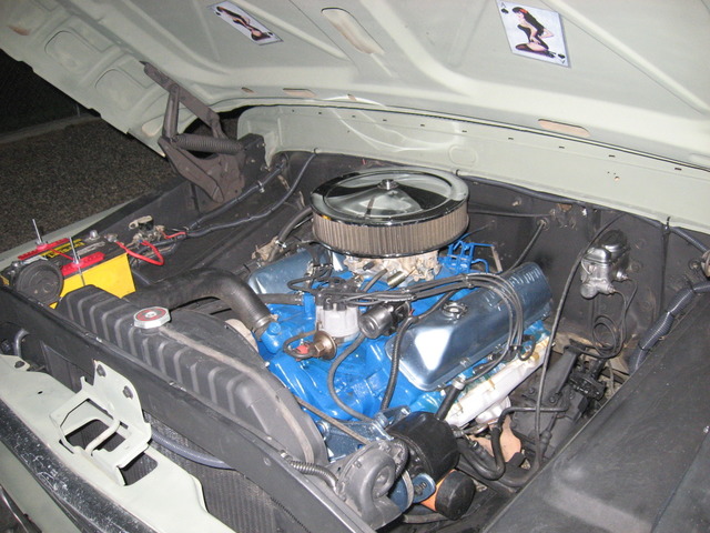

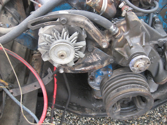

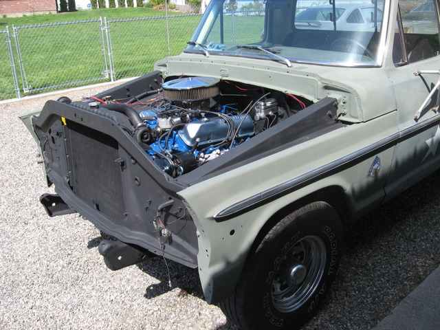

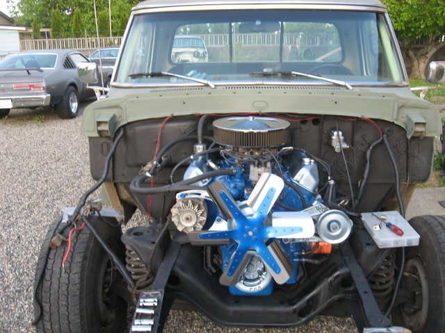

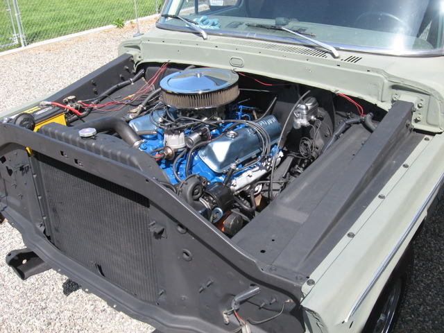

Well it's been a while and not much to report on the project. My wife had a landscape project and we got to work on getting the garden going to. So not much time or energy left over for the trucks. Yesterday & today were the first days that I was able to do anything on them in a long time. The work truck has been leaking power steering fluid and the brakes had a really bad fade when stopping so I got to work on it to clean up the engine bay and fix the problems.

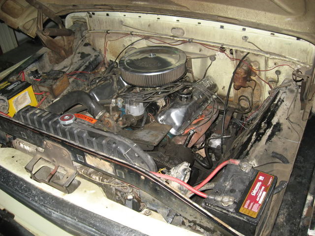

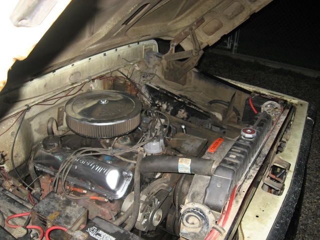

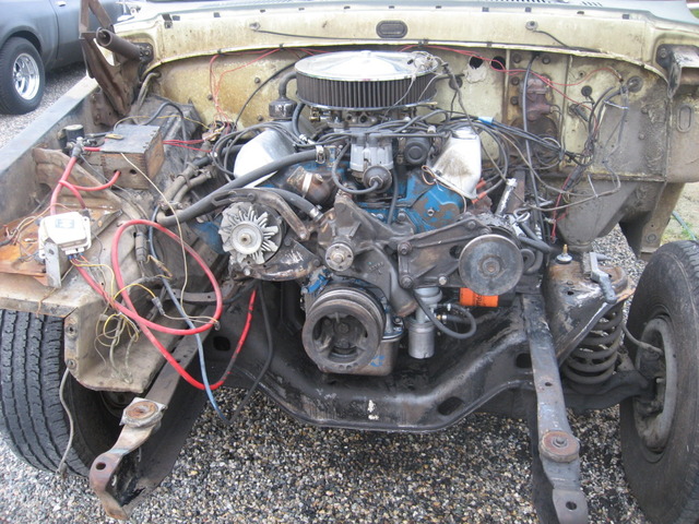

Engine bay when I got the truck:

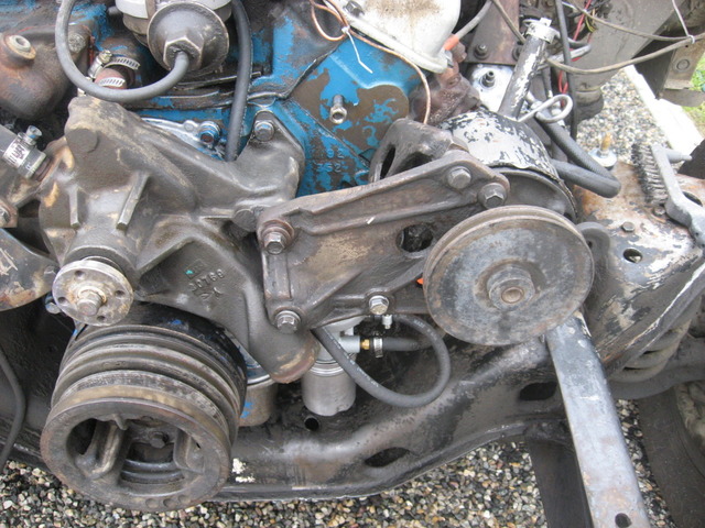

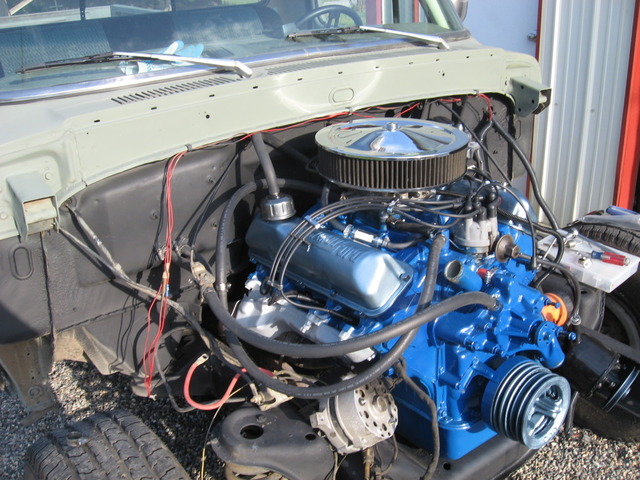

Then found the problem with the power steering and fixed it and the brake fade was being caused by someone putting in the wrong rubber diaphragm in the cap so it wasn't sealing between the two reservoirs, as soon as I put the correct one in, it held with no fade at all. I then got to work priming and painting the engine and everything.

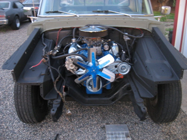

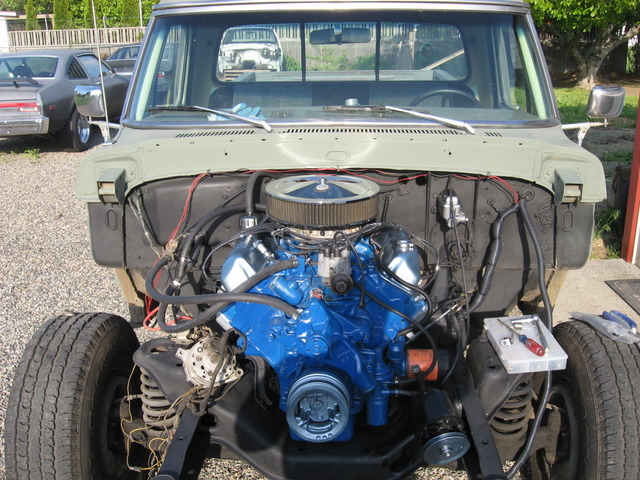

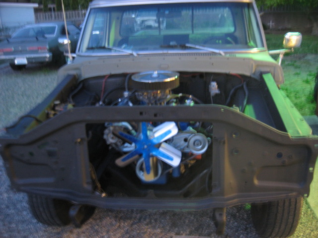

Started getting it put back together:
I had to call it a night so I will finish it up tomorrow, but starting to look a lot better.

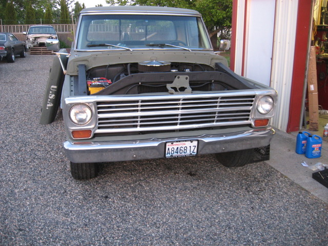

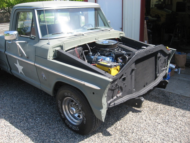

Ok so didn't get it all the way done... the only thing left is the hood and my friend is going to come over tomorrow and help with that. But anyways here are some more progress pic's...

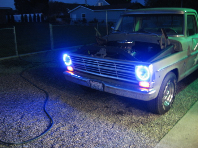

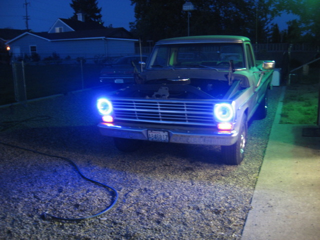

I picked up some universal light flexible strips for another project but never used them so I put them on around the head lights, kinda has that European head light look…
Still not sure if they are going to stay, I'll have to see how everyone reacts to them then make up my mind. Most likely it won't be legal, but whatever.
That truck turned out great. I would lose the halo lighting and go with the old school look. That way you won't get busted either.
bremereric
That truck turned out great. I would lose the halo lighting and go with the old school look. That way you won't get busted either.​
Yes I know, just had to see how they would look....

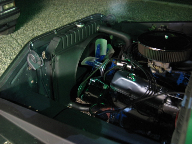

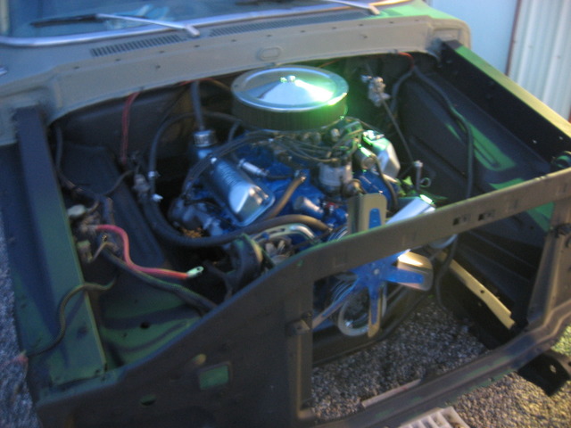

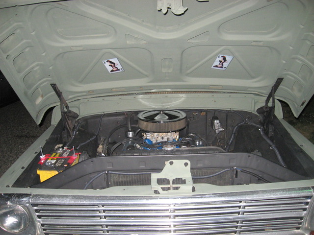

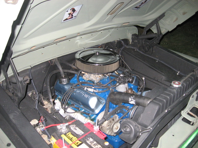

So finished up the truck on Monday but been busy ever since, so here are the finished pic's of the engine bay clean up...
before:
after:
before:
after:
Just going to have fun and drive it for now..... time to get back onto the chassis swap project.
