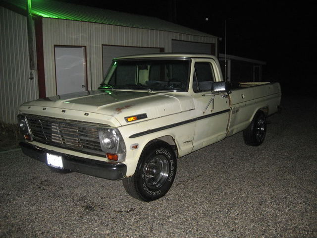

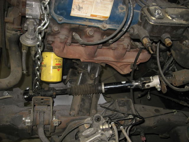

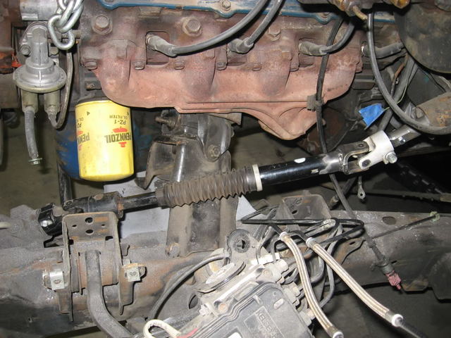

Did a test fit to see how it looked.

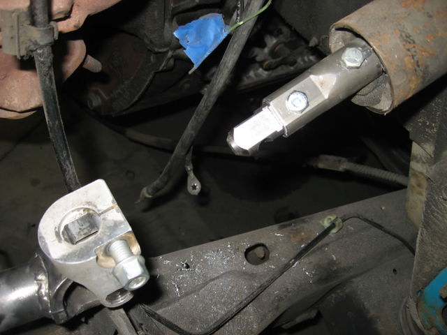

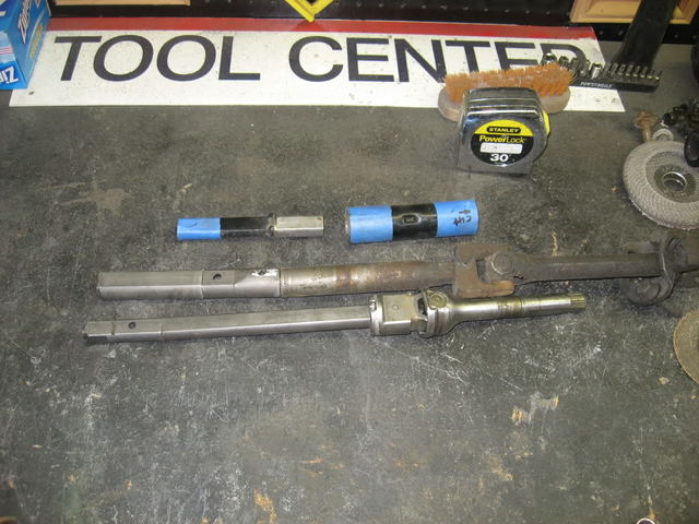

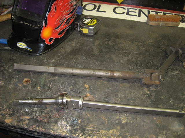

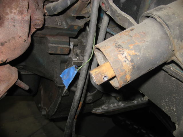

No clearance problems that I can see yet. So next I will need to cut the end off of the 72 steering column shaft and using the Lincoln shaft and the other part of the 02's steering linkage I should be able to connect it all up. Because the Lincoln round end fits over the 72's steering shaft and the 02's square end fits in the Lincoln’s other side.

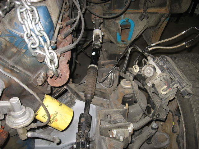

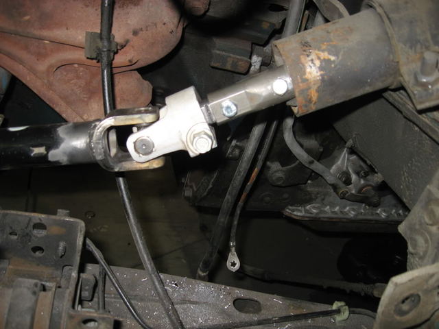

I love it when a plan comes together! I went out and finished the steering linkage and it went together perfectly. Almost like I had planed it from the get go. When I think back about it I can remember thinking about tossing the Lincoln's steering linkage into the pile for recycling but then going no I might need it. I didn't need much of it but it was the one special part that I needed to hook the 02 to the 72. So dang I'm glad it kept it.

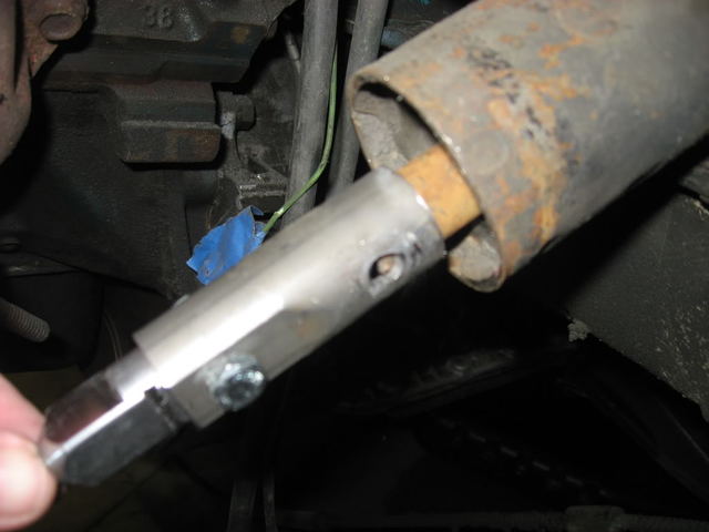

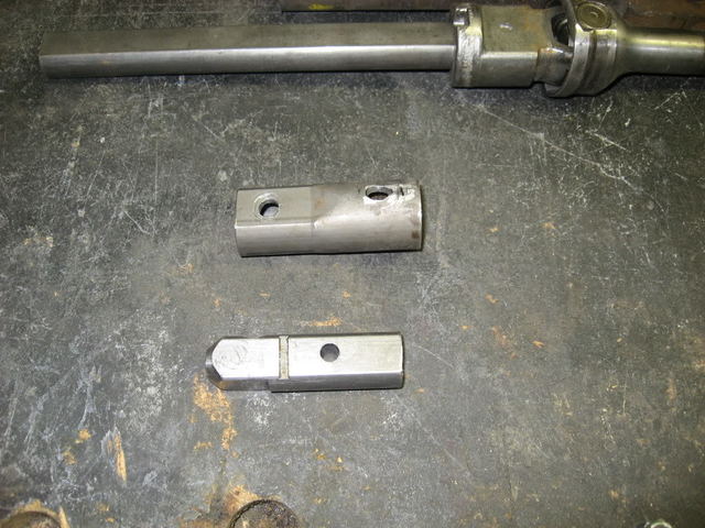

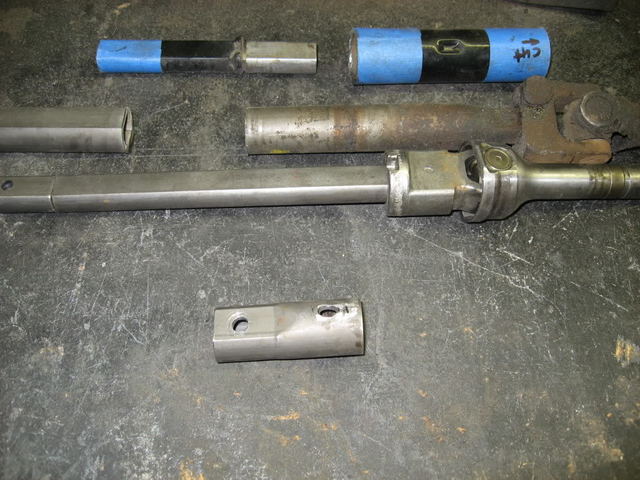

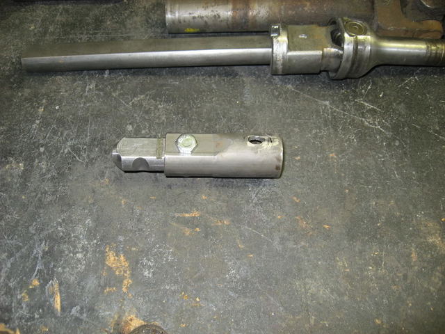

Here is the Lincoln's steering linkage and the 02 F150 linkage. I cut a small part out of the Lincoln's that had the half round on one end and the tube on the other. Then I cut off the end of the F150 linkage that fits into the slip shaft. Slid them all together, drilled holes through and then bolted them together for mock up.

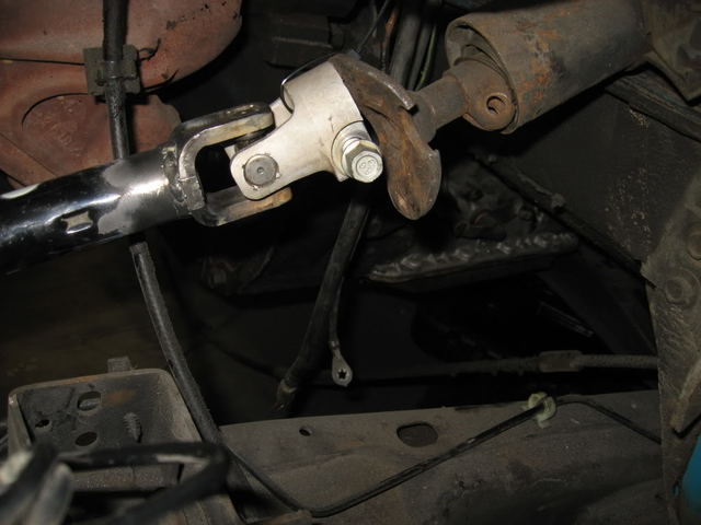

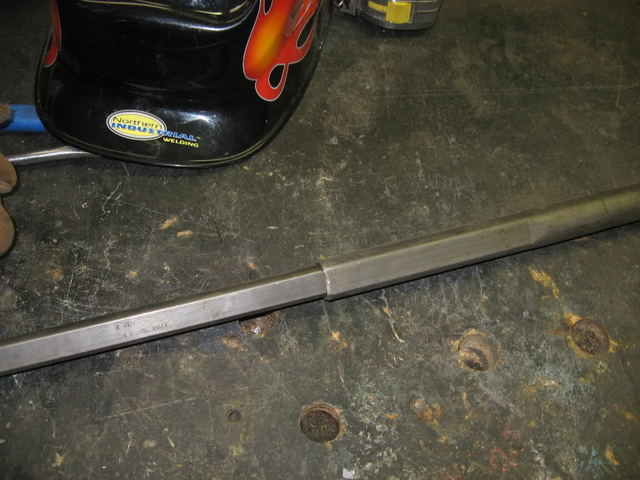

I then cut the end off of the 72 steering column and drilled a hole in it, and then slid the sleeve over it and bolted it all together.
So I will leave it bolted together for now and once I have a chance to make sure there is no binding and it all works right I will then weld the sleeve to the 72 shaft and call it done.

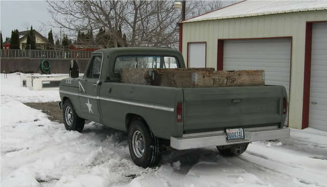

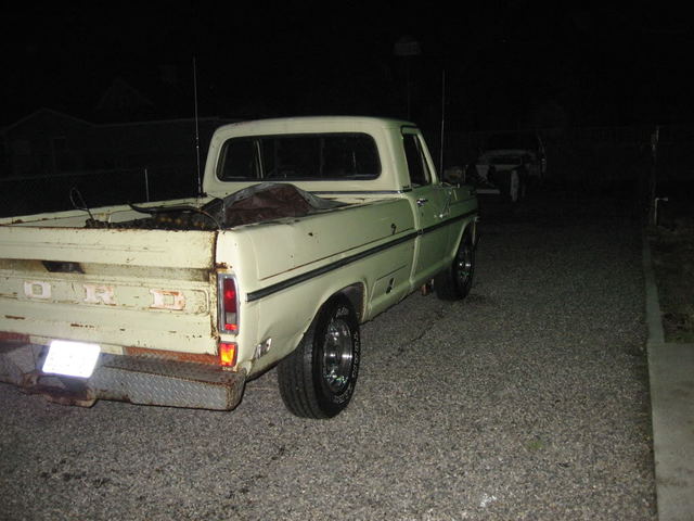

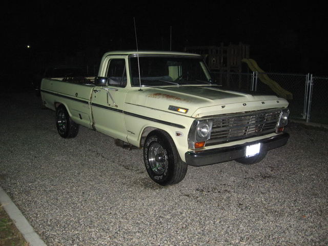

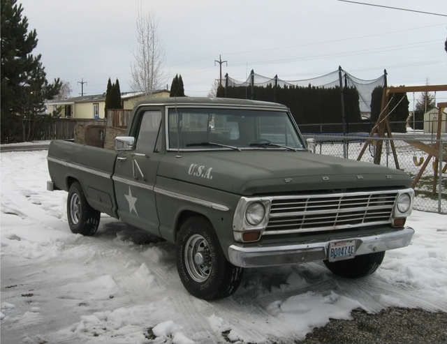

No work done on my project but I did have fun doing a $35.00 paint job on my work truck. So here are a few pic's of my truck and a quick, cheep paint job, that will just look better with age. lol
Before:
After:
Before:
After:
looks good especialy for a 35$ paint job im mopar but i like them old fords

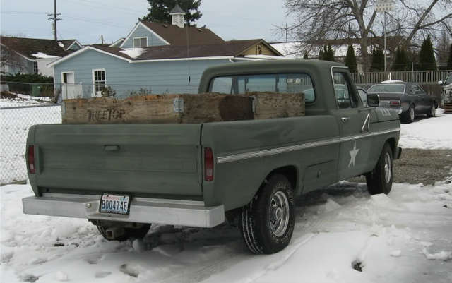

Looks good but whatca hauling in those boxes.​
Thanks!
A friend of mine owns a pallet manufacturing plant and they fill these boxes with the end cuts of all the wood they use. They have a hard time getting rid of all of it, so I go pick it up for free dry fire wood.

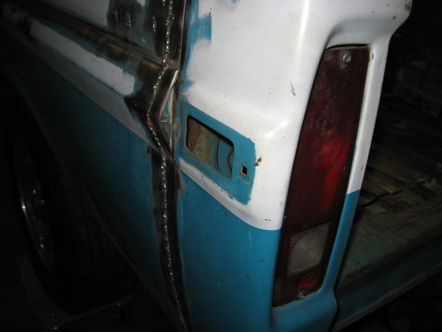

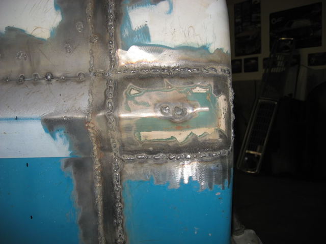

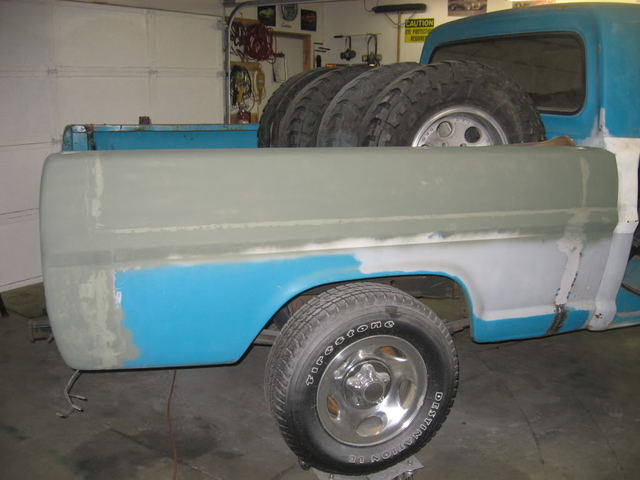

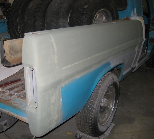

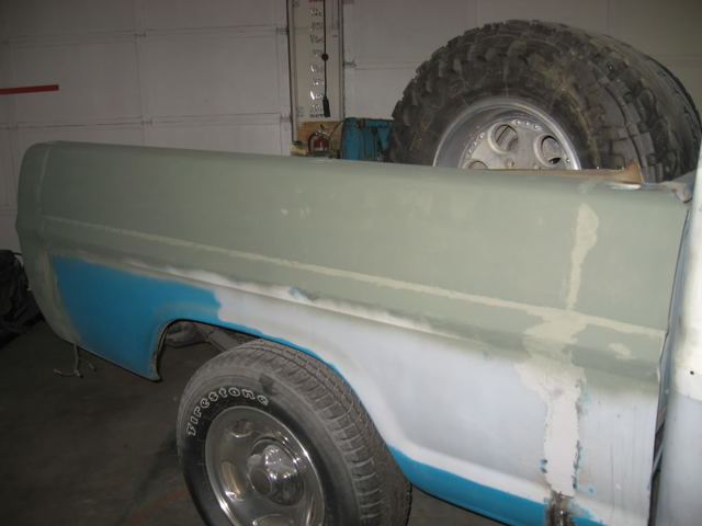

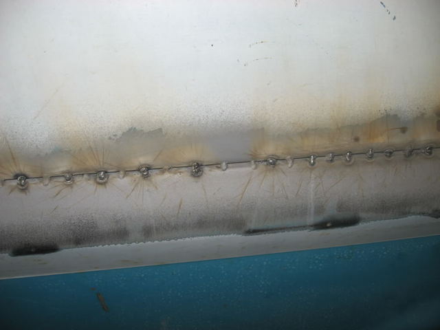

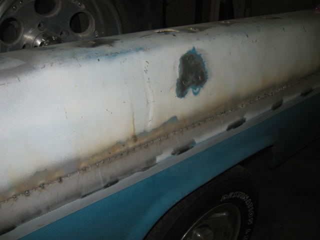

As for me, little more work done on the truck. It's been hard to find time lately but progress is progress so not complaining. Thought I'd better coat the bare metal, so I hit the passenger side with some left over flat paint.

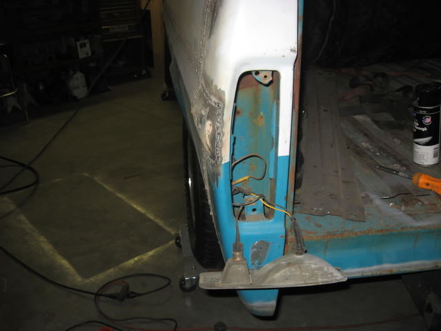

Did a little welding on the drivers side, also cut out the stock side marker light and welded in the patch panel for a matching smooth look on both sides now.
