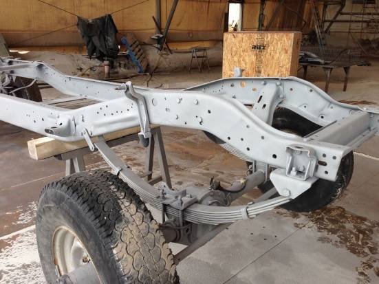

Well managed to get a little bit done on my side project. Got the donor truck pulled apart, axles installed onto the crewcab frame and then took it to have the springs rearched. Dragged it to work and sandblasted it. Now just have to wait for an opening in one of the paint booths to put some paint on it.
Maaan that truck is going to be better then any brand new truck out there as well as ten time's as strong and dependable I bet . Look'in good :cool2:
Thanks. Nice to start with a clean slate so you know what you're working with. The guy I bought the frame from said it was sandblasted, primed and coated with pore 15. Well when I sandblasted it, the coatings just flew off so whatever was on it wasn't very good. I will be priming it with an epoxy primer so I know it will last a long time.

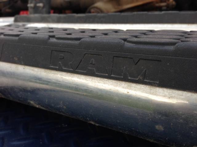

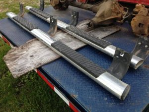

Aquired a set of tube steps off a 2010 Ram today for the right price, free. Think I might try n use them on this truck. Just have to fab up some new mounting brackets.
Maybe he didn't prep it right ? How's was the frame "under" his paint ? Was it rusted at all or could see that he really did sand blast it at least ? I can't say yet on the steps . I think I'd have to see them mocked up first before I could say yeah or nay on those .
Frame was clean under the paint so I'm pretty sure it was sandblasted. Was probably just a cheaper primer on it. Yeh gunna have to mock the steps up first see how they look. The price was right so no loss if I don't like them.
I'm glad it was clean underneath . You never know what some people try to hide sometimes . You'd be amazed at what I've found under heavy paint , under coating or even roofing tar .

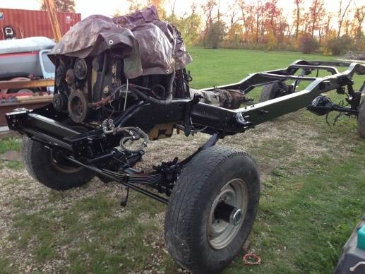

Well not a lot of progress to report. Been plugging away slowly. This is how it sits right now.

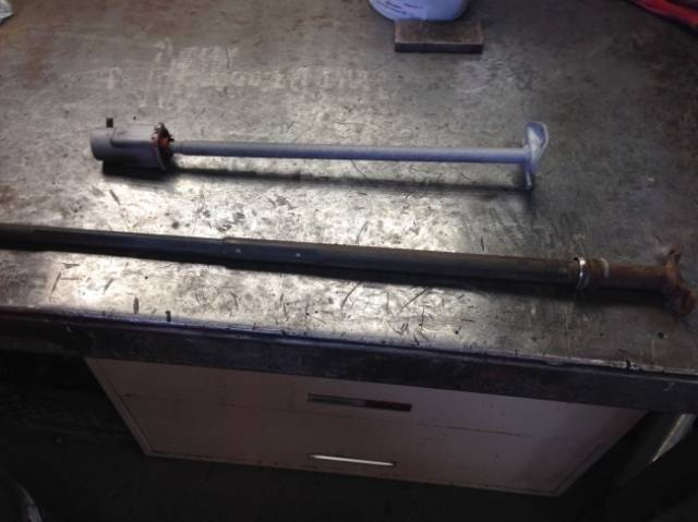

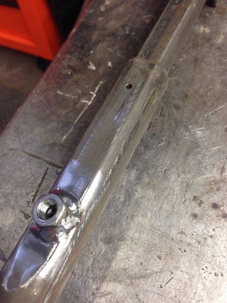

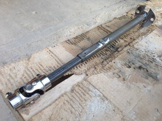

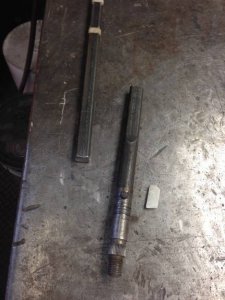

Built myself a homemade borgeson steering shaft. Used the center out of steering column I had and the steering shaft from the 93 donor truck.

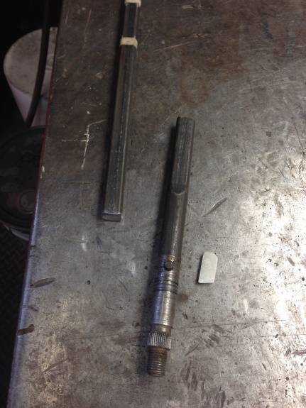

I pulled out the center of the steering column shaft and cut off the splined end for the steering wheel.

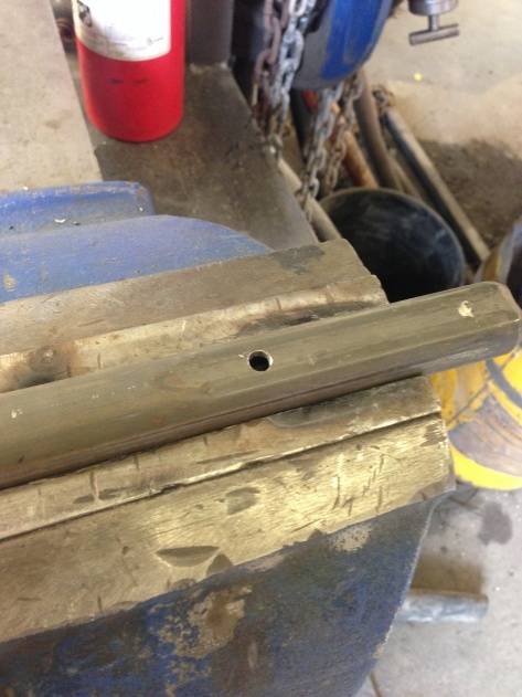

Then drilled a hole and welded a nut on for a set screw.
Cut the other end off the steering column shaft.

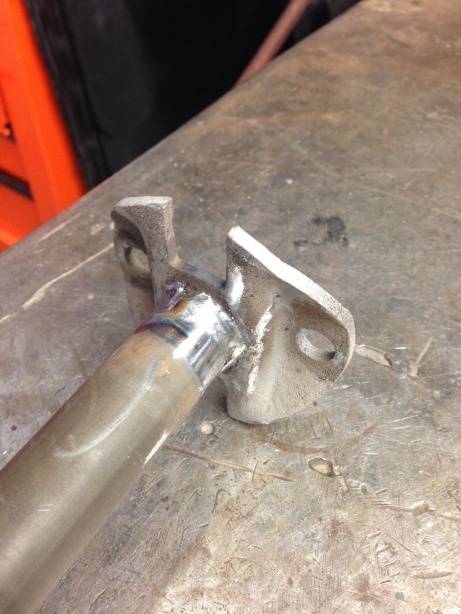

And then cut the rag joint end off the 93 steering shaft with about a 2" stub left on and slipped it into the steering shaft and welded it on.
And all done.
Total cost of $35 for the steering universal that I picked up at Back To The 50's in June when I was there.
Wow , That look's better then anything you could buy off the shelf ! And cheaper too ! lol
Thank you. Yes cheap is good. lol. If I can build it or fix it myself then I will. Obviously there are some things you just have to pull the pocket book out for but that's part of the hobby. I've gotten the fuel tank in and the fuel lines run, chassis wiring harness is in and new brake lines run also. Bit by bit it's coming together.
