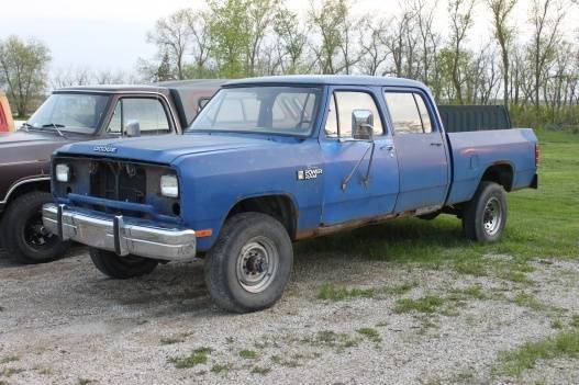

I have, but why do more work than necessary. The tank is good and the spare was pretty nice when I took it out, real clean inside. For what I'll be doing the inside tank is fine. Just curious, what capacity is the inside tank is?

I've never noticed any fumes inside the cab, and what's in the tank now is got a strong odor when you open the cap, so the fume issue isn't a problem, for now. The truck is going to be a poodle dressed as a Hell hound, a wimpy (ok, not so wimpy) on road show toy. That's what I'm aiming for. Sure it'll be capable of doing most anything, but it never will live up to it's billing. This is the first vehicle I actually thought about making a show poodle, so the weight thing isn't an issue either. Then you gotta bring up filler necks and what not! If I do end up going with a tank in the frame, I do have another box I could use, or I'd at least have a filler neck to graft in when the time comes. But then I'd chop up a perfectly good bed, and I don't want to do that. As for a fuel cell type setup, that would work but I'd need a ladder to get to the box to fill it up.

I want to get my crew cab on the road this year, but then I'd have to fix all the exhaust and brakes, then do it again for the big block.:( Get axles and lift kit this year maybe?

NP there. Good reading for me as I'm considering this also. I have a rear tank from a dual tank truck I was going to use but having a hard time finding a sending unit for it. Want to move some weight to the back as the diesel is adding to the front end.
I was considering moving the filler neck to the rear of bed right behind the fender. Truck is going to be tall so don't want to have to open the tailgate every time I gotta fill.
Did manage to get some paint on the frame this weekend so another step forward. Can start bending up some brake lines now and do a little bit of reassembly.
