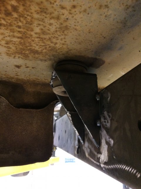

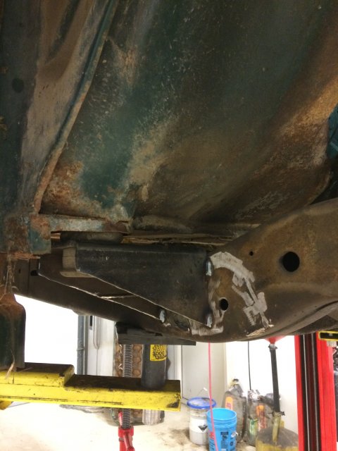

Couple of updates. Cab mounts are heavy tacked in. Reused Dakota insulators. Front group mounts built using Dakota front mount and insulator. Going to try to move engine/trans 1 inch to the drivers side for exhaust clearance. Then mock up seat, steering wheel etc. to determine if I still have an acceptable seating position.

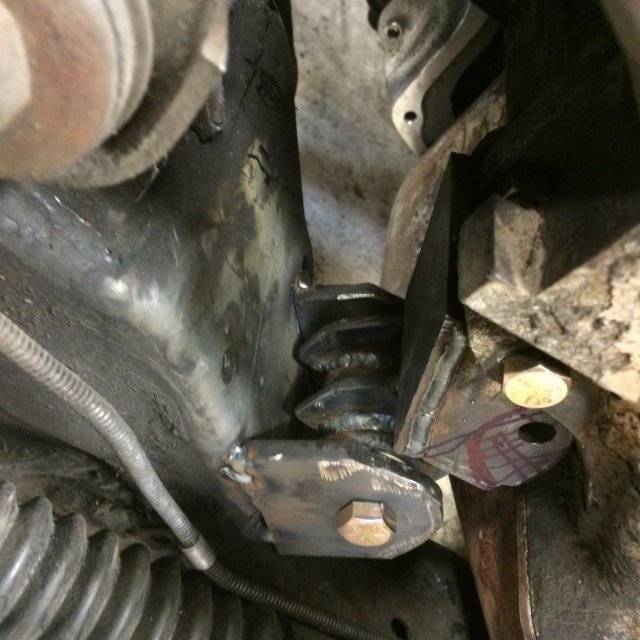

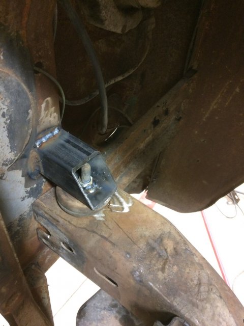

Been working on the old truck. Front motor mounts are done. Clearance issues are solved. Had to move one tube on the right side header.

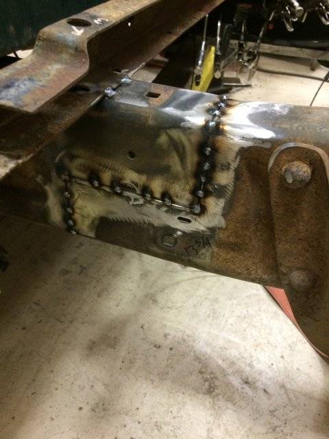

Had to cut the frame twice. Damn. Forgot to account for the five inches of overlap at the joint. Went better the second time.

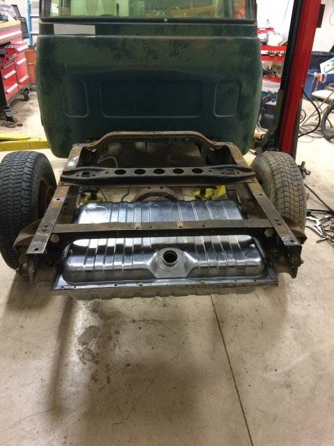

I saw where a gas tank out of a 68 mustang would fit nicely between the frame rails. It did. Made a 1 inch square tube frame that bolts to the frame. Bought a 3/8" fuel pick up and sender. Tank and sender was about $165. I still need to weld in a vent. Bought a flush stainless marine fuel cap for $30 that will mount in the bed.

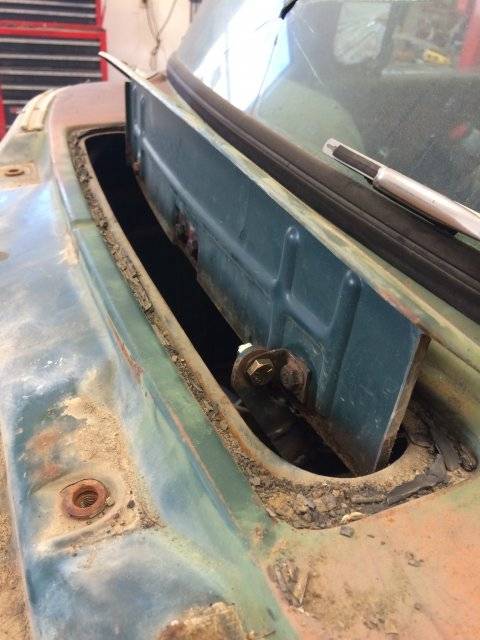

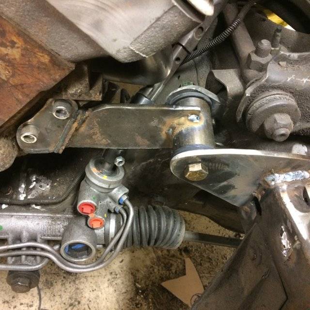

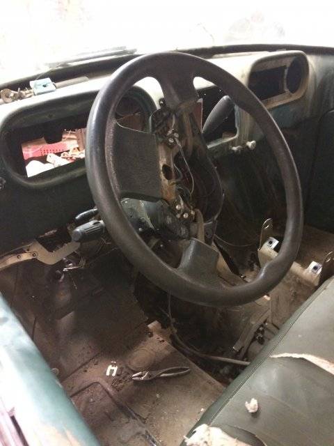

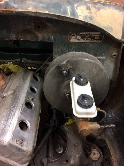

I noticed I had not posted steering or brake location pics. Here's a few. Seating position is good. Gas pedal won't be ideal but will work fine. Valve covers will be removable in the truck. Everything clears. Had to free up the rusty mechanism for the cowl vent and move it to drivers side. Works well now.

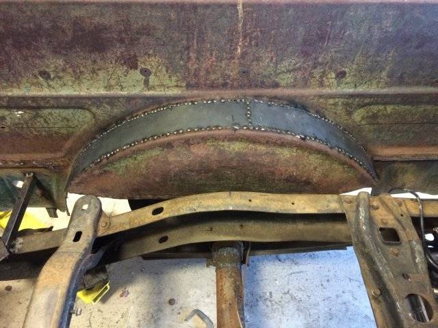

Set the bed on after cutting out the wheel wells. The floor of the bed will have to be raised about 8-9". Working on that next. I will use 1" square tubing to build floor. Waiting for the stainless bed strips.

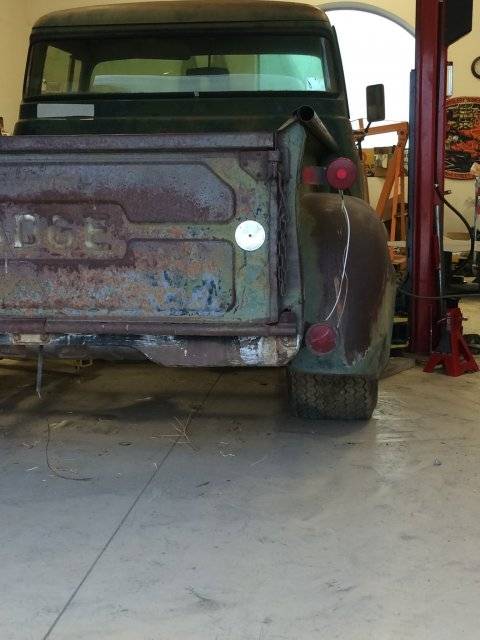

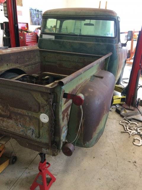

Wow that bed does sit a little low . How much of the frame is going to show if you just block it up ?
I just thought of something else as well . You might have to think about fabbing up some rear bumper brackets as well when you raise the bed . Just a thought . :)

I'm not putting bumpers on. When I get to the bodywork I'll close in the holes in the facia in front. Bed floor will be 8" higher to clear rear kick ups.

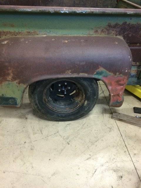

I have the bed position mocked up. Found an old 15x10 wheel with 3 1/2" backspace from my dirt track past to mock up. Hmmmm. Bed looks to low to me. Wheel well is filled up but the fender is sitting about three inches lower on the tire than the front fender.
I think I'll try it three inches higher and see how it looks. The final wheel I use will need at least 4" backspace 5" probably better. Looks like I have enough room on the inside to handle 5".

It's a 9" out of a bronco with 4.11 posi. I was going to swap axles to get 5 on 4 1/2 to match the Dakota front. Turns out I was already pushing it on how narrow I was. I bought billet adapters to get to the 4 1/2" pattern. Widened it out 2 1/2". Goldilocks on the width and pattern.

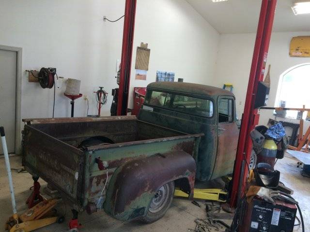

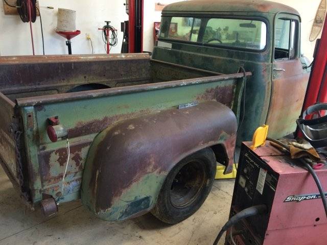

Building something like this there's definitely a lot of trial an error . Just try a little at a time till you find the height your happy with , that's all . You'll get it .;) Do you have the room in your shop to post a full on side shot of it ?
I really wanted to use an 8 3/4. Problem was that I had torn up so many of them racing on the dirt that I didn't have enough parts to build a good one. It would have taken over a $1000 in parts plus the work to set it up. I had a 9" with 4.11 posi for $400. It was a money thing to go with the ford. Everything else is mopar.
I checked a 59 Dodge truck I had to see I had the bed set 2" lower in relation to the cab than stock. I broke all the tacks and moved it up 2" and it looked much better.
I'll try to roll it outside to get a good side pic. I started on the tubs. Adding 4". Still waiting on bed strips to help locate where the cross members will go in.
