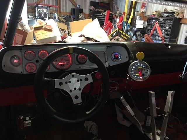

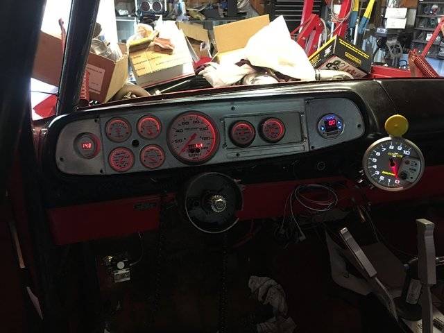

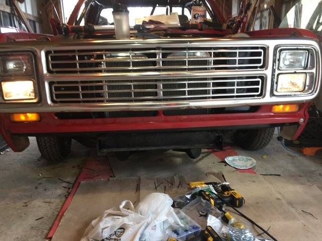

Aren't the low beams on top, or am I wrong? Been a while since I've seen one at night.View attachment 9067 View attachment 9068 View attachment 9069 View attachment 9070 Cockpit is almost finished all lights now working.
