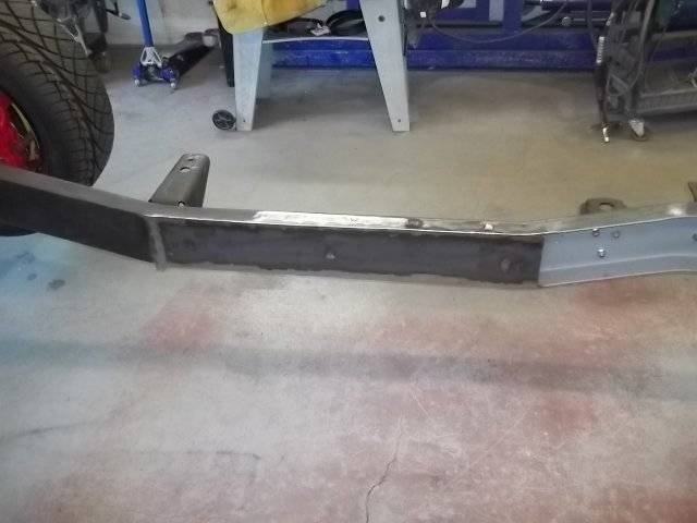

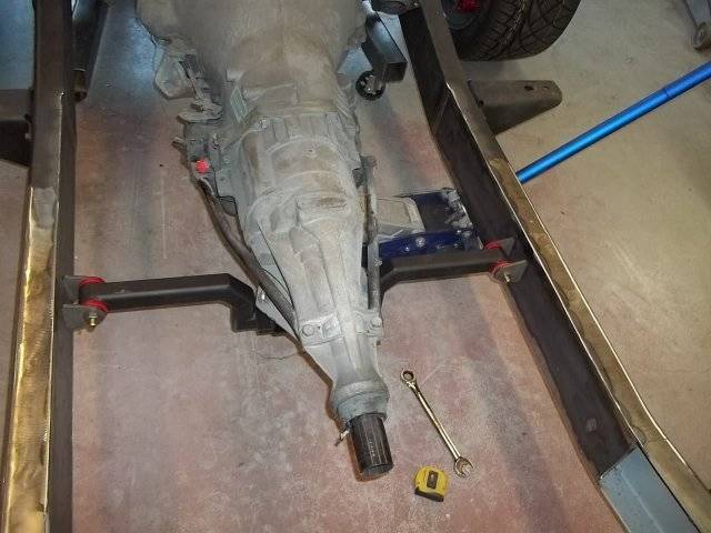

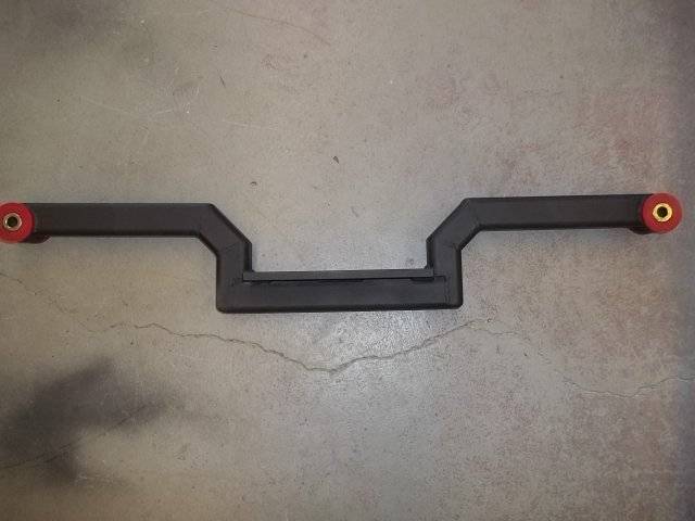

Boxed the center of the chassis with 3/16 plate. Fabbed up a trans crossmember and got that tacked in.

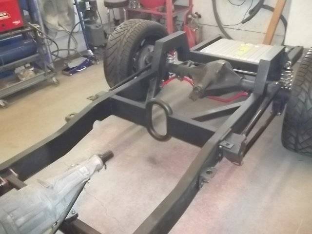

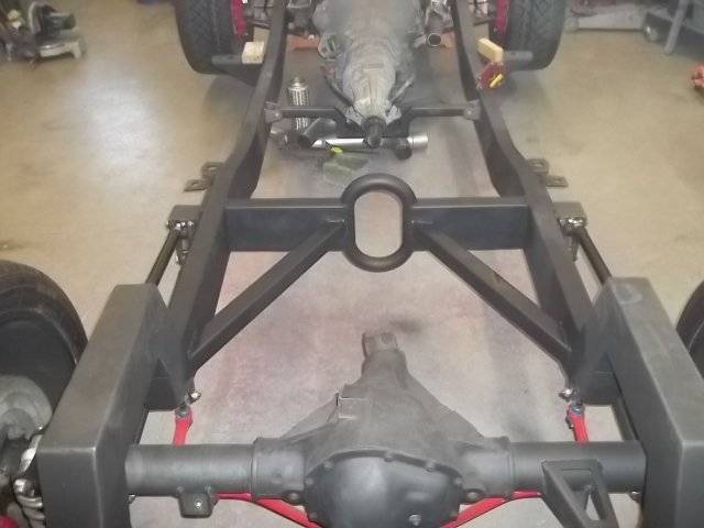

Been a little slow lately, life keeps getting in the way. I did manage to replace the factory rear crossmember with an Art Morrison one. Then finished boxing the frame, and added a couple diagonal braces. Next will be the exhaust.

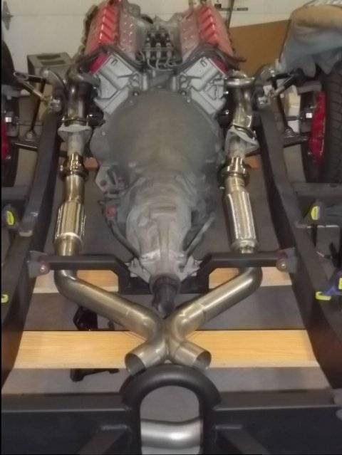

Don't feel bad , we haven't done a quarter of we set out so far on the Warlock . Judging by the notch's under the frame , I'm guessing you plan on dumping the exhaust out just ahead of the rear tires ?

Yea. That's the plan. Want it to exit out the side of the bed.
I assume your going to be making the exhaust yourself ? What are you thinking for mufflers ? I think there going to have to be on the short side , judging by the room you have .
How quiet will that be? Using diffusers or the like?
I did a lot of research on Youtube for exhaust systems on Ram SRT10 trucks. The best sounding one was a guy that had 3" pipe and no mufflers, so I'm gonna try it. I can always add them in after if it's too loud.
