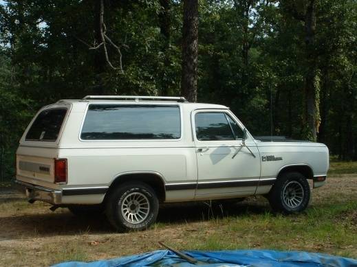

My1985 Ramcharger build Ram Wagon
The hottest couple of days this year and it was Creeds only strong end to spend time with dad away from work and the band after he played Friday night at a big bikers rally $30 a head to get in, so the wife and I past on going
to this big 3 day event.
Well Saturday Morning Creed showed up and we made the move on getting the donor engine out and in the ramcharger
As you can see this is a shade tree mechanic work area at it's best..
About 5:30 pm Sunday we took the ramcharger for a test drive , Not knowing if the trans has held up ok after a long stored life of just setting (well over 4 years) when I bout it from my cousin about This time last year.
Well the Ramcharger drove perfectly and the trans sounds and shifted out perfect too :first:
You can only imagine the look on our faces as we drove it off the hill and down the road wondering if the trans was still good, It was and what a great feeling.
We had to go buy a trans cooler because the donor truck was a standard and now we will be changing fluids and a complete tune up, plugs, wires, filters, and install this hood on it's first ramcharger It has been on 3 of my trucks and one of Creeds in the last 13 years since I built it with the help of a friend and his plasma cutter and wire welder.
You can only imagine our happiness and it felt good to do some wrenching with my sons again, we have dun many and this is just another memory made to enjoy for years to come.

I believe you are right bremereric, But when we get this one tagged and insured Victoria (66 Valiant)can move in the nest (tent) and I can start removing all the parts from the head up and repaint and install my new big valve shaved /6 head on her.
Now it's time to change all fluids and filters and a pair of new brake line hoses on the front end of the ramcharger
One line blew on use but it was good to know this before it hit the main roads
And repair the hood for a new paint job, white and matt black with white call outs around the roadrunner hood

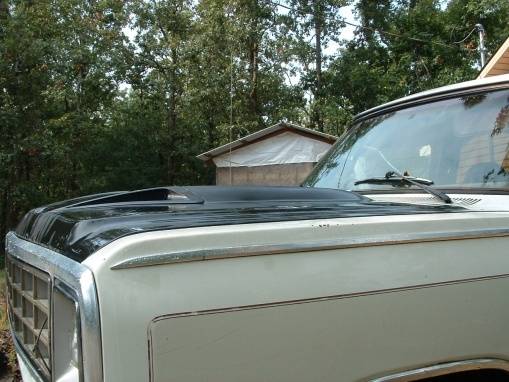

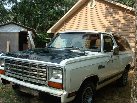

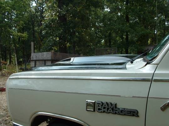

That hood looks pretty sharp on there Mike.
Thank you Stan, I have enjoyed driving it this morning and I think to keep it neat and give it a natural look I am going to paint the hood white, well Creed will, Tired and relaxing today, last night we changed trans filter and fluid and got the exhaust all piped up and it sound sweet and pulls great, the RV 318 out of the 3/4 tun is running real good. Creed put the new temp gage in this morning and this project has went a long way in 7 days. Know we need to put the front bumper back on we had to remove to get the cherry picker closer.

Update :typing:The transmission is getting a total rebuild new high stall stock 1.800 to 2.000 stall and all new HP bands and clutch pac.
The trans has set to long and after driving about 70 miles it is slipping into third gear and some times it will not do anything after it warmed up. so a complete rebuild 1 year warranty from a great MoPar trans builder we know Parts and labor $500.00 not bad at all and it will be all behind me and make this Ram Wagon a dependable traveler :yo:

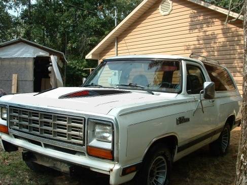

That's $500 well spent Mike. On your hood I see some red on the front part of the buldge, Are those lights?
:thumb:
bremereric is correct Stan :cool2: I did that in paint on my computer, and those are the beauty vents that came on a 72/73 road runner, I can remove them and it lets cool fresh air in under the hood.

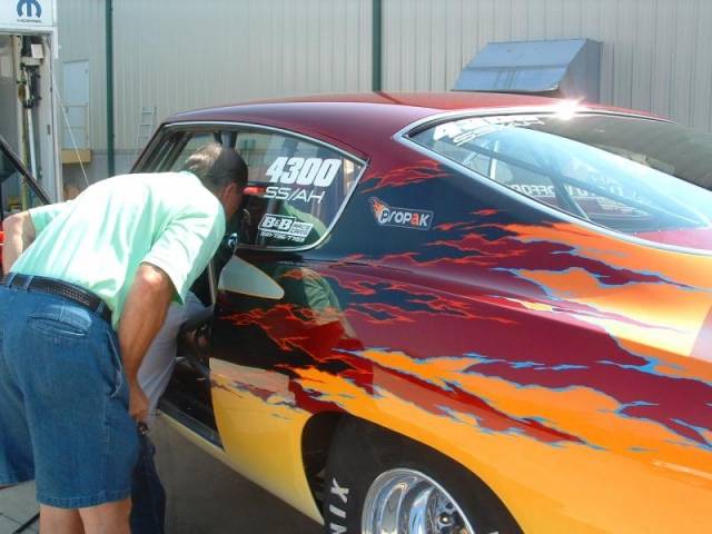

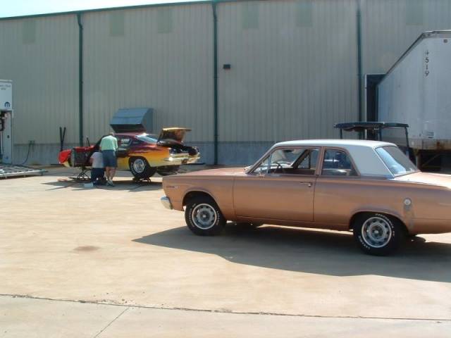

Here is Creeds bosses race car in the parking lot of eng.ink. and my daily driver 66 Valiant sedan I am sure you and many folks know her name

Happy to say the Ramcharger has been flawless on 530 miles of in town driving in this Arkansas heat.

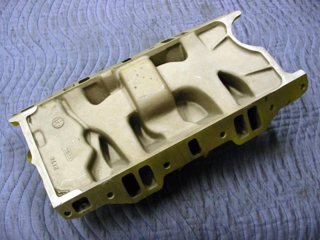

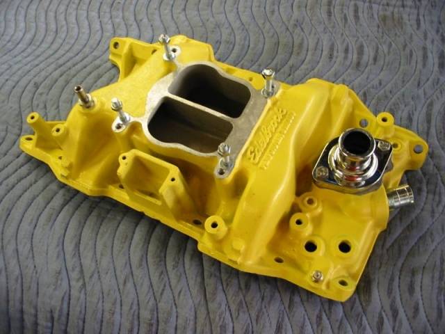

Time to move forward and get the intake and Eddy 600 and new intake on.
This intake is made for the 318 and has never been cut or modified :first:
A good match and then charge the A/C... But I think I will let a body shop do there thing :yo: a free labor just cost paint,I and my two sons Mike and Creed will spend a strong end with my younger brother that run's/works at in Memphis Ten.Body shop and said we will have the run of the shop.
Work in the hood and new skin sure will bring this 1985 back to life
I am stoked!! Got the call Saturday from Brother Pete
Glad to hear your ram Charger is doing good, are you changing over from a 2 bbl to a 4 bbl? Or just going to a high rise?
changing over from the 2 bbl to the 2170 eddy intake you see and adding a 600 eddy carb.
Leanna is powder coating it for me, She calls the color Allen Silver.
Going for this look :cool2:
