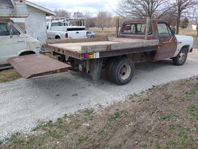

I will just keep the one ton and not have to worry about it.
If that doesn't do it we always have this to fall back on. Half tons are for the look at me I have a truck crowd. Not that there's anything wrong with that. Just remember the limitations.
