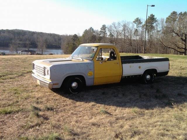

Mike Bee. How did you drop your D100. Thanx.
i just put rear on top of springs and used car u bolts with lake wood traction bars( also can use car shock plates) and cut a ring off the front coil and moved uca cams to set wheel straight....BAM!done.
never even took it to get lined up and no tire wear issues.

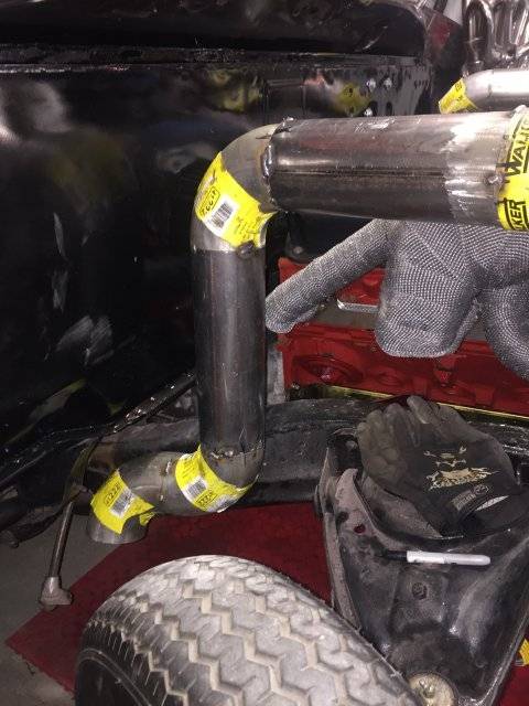

Looking forward to hearing those turbo's spool up next year ! :D
