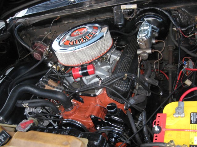

3/4" ? That doesn't sound right . Normally with an RB block in one of these , the valve cover is right against the edge of the booster . The B block "just" clears . Hmmm . Does he have the transmission in yet ?
I'm guessing he doesn't have the transition installed, it looks like the engine slopes down towards the firewall. II'm pretty sure he will need that smaller booster. Look up a 72 w200. That's what's in my truck! Or as bear said, late 80's 3/4 ton. Make those counter guys work at the parts store and have them look up mid and late 70's and mid and late 80's 3/4 ton trucks. Probably all the same part number.

Oh there's nothing like turning that key for the first time .Thanks for stopping by Budnicks. He's a young guy who loves Mopars so you just gotta love that. He's currently saving up to get a 10.5" cast crank engine flywheel. We're looking forward to hearing it fired up soon.
Does that need a computer to work properly?Tossed the carb and added 92 model port fuel injection. Love it.
Yup !Does that need a computer to work properly?
