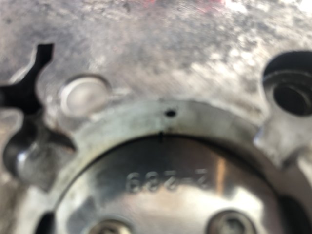

Putting the marks on the balancer with a Sharpie, Is how I have done it too.

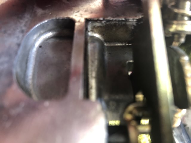

But if the LD shows good rings ( less than 4% leakage in my opinion, up to 10% by others on FABO, and for Performance, Smokey Yunich preaches 3 to 5% is good; 5 to 8% is toast), then I'd be checking the cam-timing. Since you have already done that,and are satisfied, then I'm going with the transfers and pumpshot. If you close the throttles too far, the transfers will get lazy. They could even dry right up. If the fuel level is too low, pullover will become difficult, and your idle wells will pull too much air in to the emulsion tubes. Pull-over is a term used to describe the fuel in the wells (idle and main) being pulled higher than the fuel-level in the bowl, up to the top of the idle-well and then over the top and cascading down to the discharge ports. Remember; the engine isn't sucking in the fuel, atmosphere is supposed to be pushing down on the fuel in the float bowl. The air coming in thru the bleeds at atmospheric pressure is moving to the low pressure in the chambers, and the fuel is coming along for the ride. If atmosphere cannot get into the bowls or airbleeds, all bets are off. If at idle, the throttles are closed too far, the inrushing air will go thru the transfer slots, above the throttles, and exit underneath, drying up the transfers. Then, at tip-in, there is no fuel there and a hesitation follows. The pump-shot is not designed to cover that, it is much too slow. So when you slap the throttle; first you get the hesitation, which is the engine trying to stall. Then the pumpshot comes along and trys to make it all better, but it's like putting a bandaid on a hemorrhaging artery, too little too late; and you get a full-fledged bog, or lean misfire, or even a backfire.. Worse if the gas is stale.
