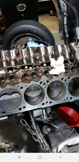

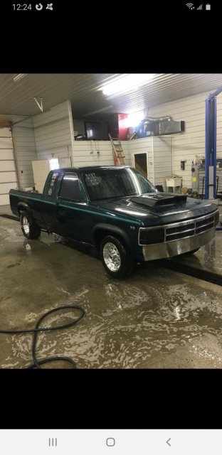

Damn I havent been on here in so long I forgot about this post. The 5.9 had Home ported EQ heads. Here is a video of the 94 extended cab making a pass.
Sorry I can't get the video to play picture of the KB107 pistions in the engine. Also pictures of my friends 94 dakota
