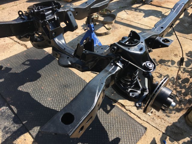

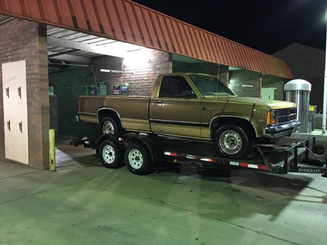

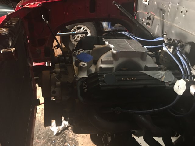

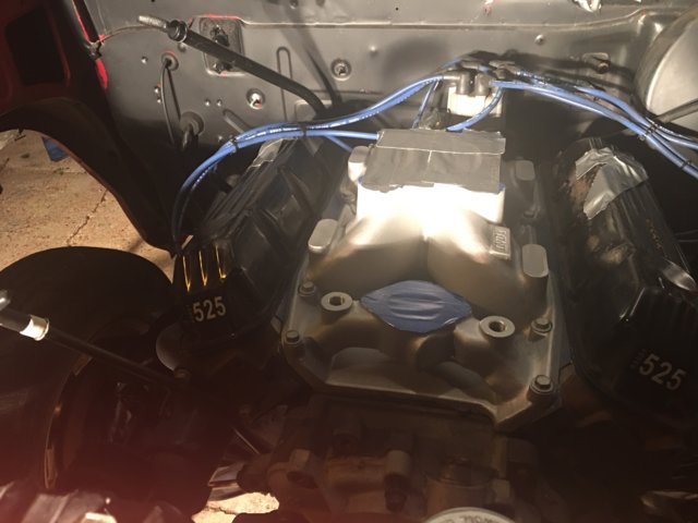

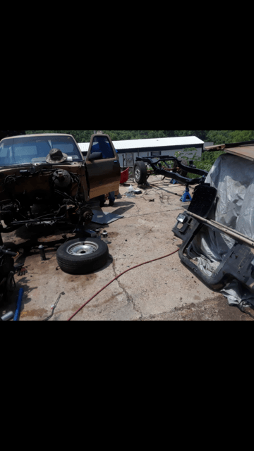

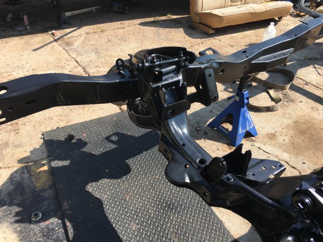

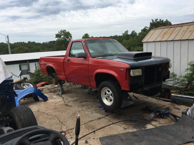

Hi sorry I have been working like crazey on my Dakota. I ended up trading a old 72 dart for a 96 SB Dakota Roller. The cab and bed was real nice on it. It was missing the drivers door and the front clip. I ended up putting the cab and bed from the 96 onto my 91 frame. I was going to use the 96 frame but some damn chevy guy cut the factory engine mounts off. So I didn’t want to mess with it. I found a 96 at the pick and pull. It was even the same color flame red. But it wasn’t a sport. But I bought everything off it except the hood or the drivers door. I got the engine and the trans put it also. I am getting closer to hearing it run. Going to put the intake on it today. Here are a few new pics of it

Ok it’s got replacement flat top pistons, stock bore. Compression is around 10.9, Home ported Dodge RT heads with stock size valves, comp cams 305/555 solid lift cam, Indy intake. 750 Holley DP carb
Man I know Im gonna sound like a dick but I in no way see that combo pushing a Xcab Dak to low 11's. Given the weight, you would have to have 500+ HP and I just dont see an iron head, stock valve Magnum getting more than about 450hp at best and thats optimistic. Ive built 408's with Eddy heads (2.02) that only made that number. Power adder, well thats totally possible but then we have to talk about the "stock pistons" which btw cant get to that high of compression, not even shaving and the thinnest head gasket you can run safely without studding, deck honing, etc. I would love to see the rocker arm config, I had to go oversize stud with cam of that lift.
Man I know Im gonna sound like a dick but I in no way see that combo pushing a Xcab Dak to low 11's. Given the weight, you would have to have 500+ HP and I just dont see an iron head, stock valve Magnum getting more than about 450hp at best and thats optimistic. Ive built 408's with Eddy heads (2.02) that only made that number. Power adder, well thats totally possible but then we have to talk about the "stock pistons" which btw cant get to that high of compression, not even shaving and the thinnest head gasket you can run safely without studding, deck honing, etc. I would love to see the rocker arm config, I had to go oversize stud with cams of that lift.
