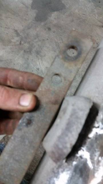

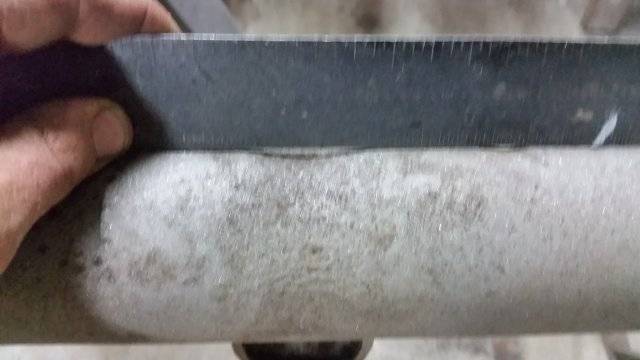

In these pics you can see how bad the axle was where the axle clamp sat, poor design that doesn't allow drainage so it just rust.

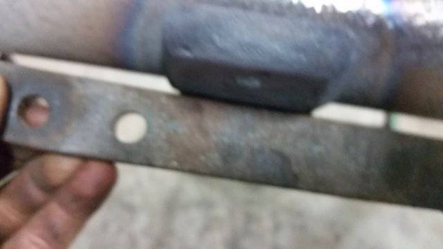

And the spring pads......... the rust severely dimpled the pads as you can see with a straight edge on them.

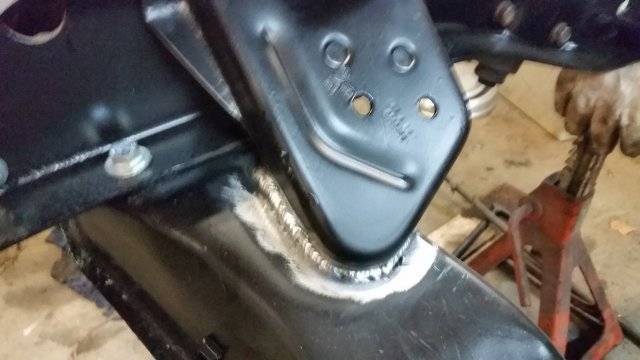

After heating them red hot and hammering them back.

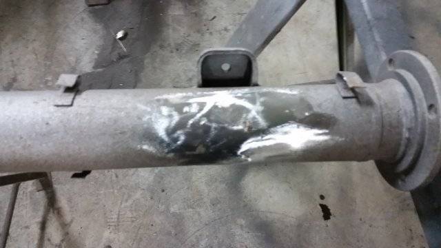

The axle tubes after welding them up and grinding them smooth, I had figured on spending time with the torches pulling the tubes back straight but they look good (probably because they required welding almost all the way around).

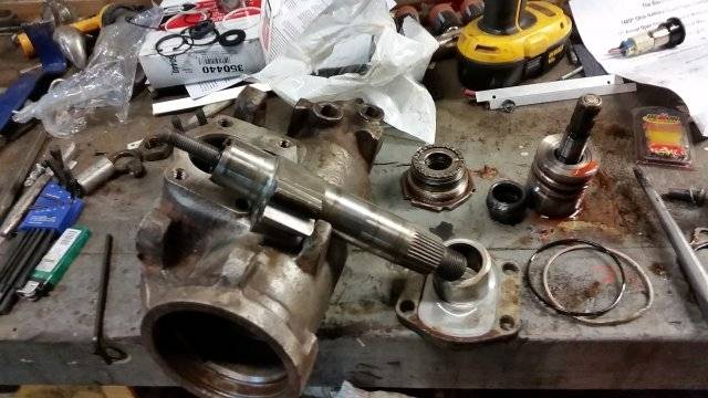

The first part to be rebuilt, I bought a Gates rebuild kit and hopefully sealed this leaky turd back up. I elected to paint allot of the parts cast iron gray just cause I think it looks cool on the black frame?

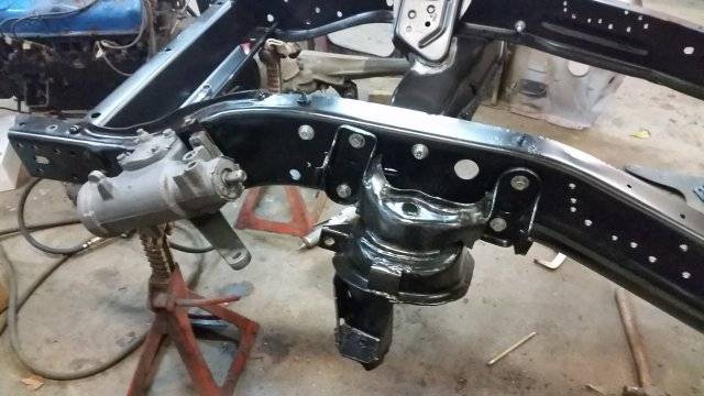

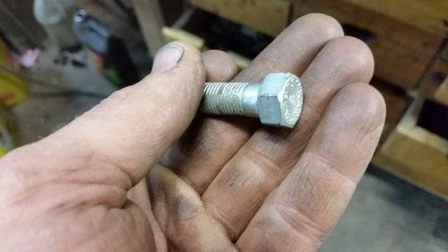

The frame is starting to go back together, I'm using all fine thread bolts with red Loctite. So far it looks like I'll have to drill all of the holes (the rivet holes are just under 7/16" and 1/2").
The motor mounts welded back in (these were the only welds that had to be cut to tear the frame down).

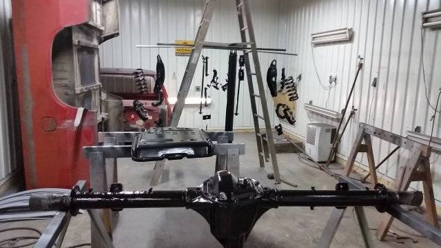

And another batch in epoxy primer and paint. All done with painting chassis parts now and ready to start rebuilding parts and reassembly.
