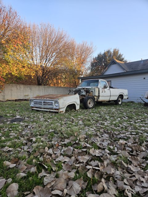

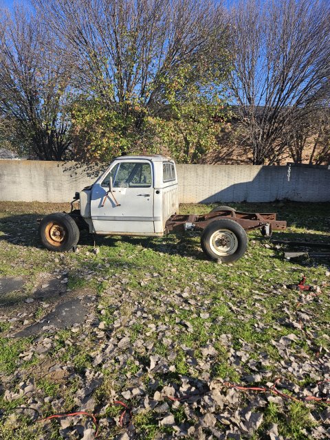

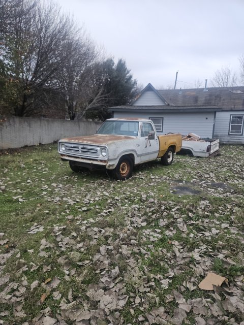

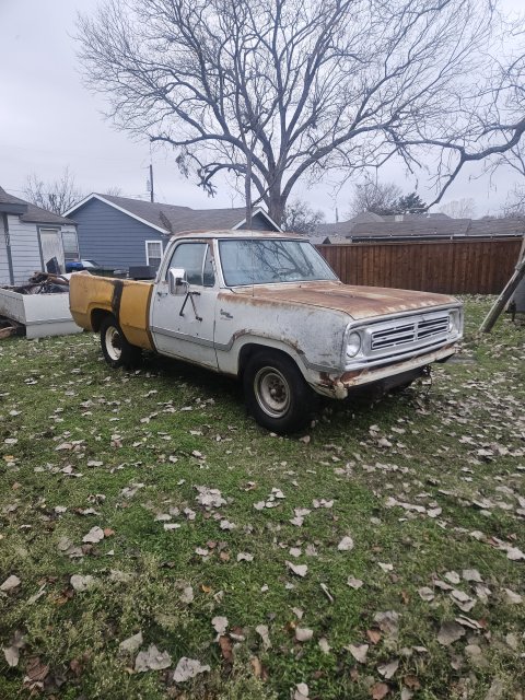

Hello everyone! New to this forum I have a 73 d200, i recently switched the suspension frame and bed to a d100 shortbed. I installed lower control arms from a van and lowering shackles in the rear. The leaf springs are also off the d100, I like the look of how it sits right now but I currently do not have a engine and transmission in the truck so I'm sure it's going to sit much lower in the front. My question is what more can I do to lower the rear without doing a flip kit? I do not want to have to notch the frame and I currently have a truck 8 lug dana 60 that's probably gonna stay on the truck for awhile.

Yeah I had an 84 d100 that had a flip kit didn't really like how it drove. I got this truck pretty cheap the goal was to eventually turn it into a shortbed, didn't wanna get carried away I have a 69 valiant that I'm also working on. Paid $200 for the shortbed and frame couldn't pass it up.
