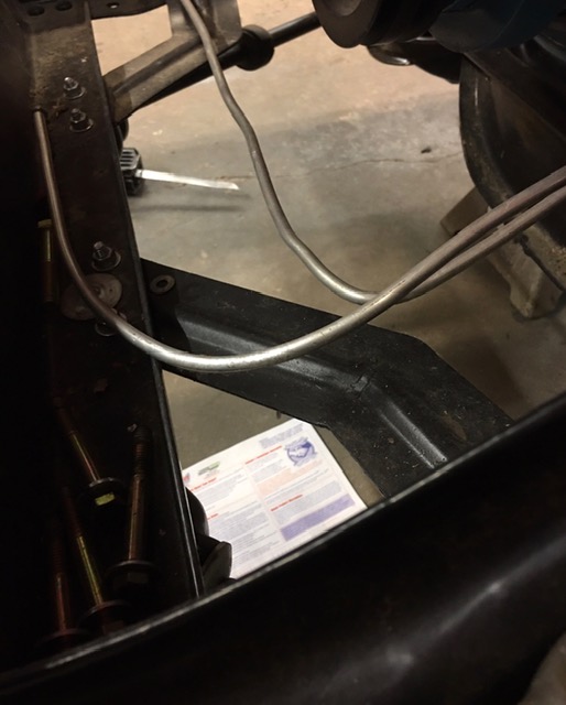

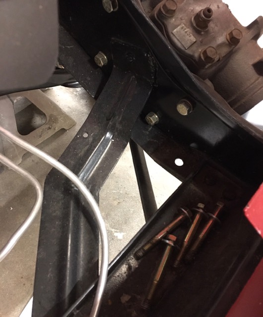

I've never actually seen one on a truck. Fortunately badvert65 posted a link to the brace offered by Dodge Connection. I studied the pic and modeled the one on my truck from the pic. Then I added the brace on the opposite side to help make it look symmetrical. I feel like it's good to go now.
Not sure why Dodge did not due this on all trucks. The frame rails with the steering box in front of the frame bracing was a weak point. The constant twisting caused by the sector and steering link puts a lot of stress on that rail.
