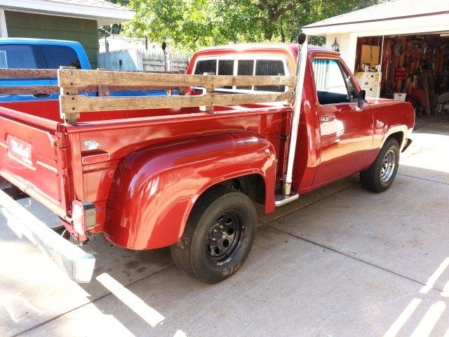

Has anyone found any tips or tricks to getting a pickup truck to get good traction at the dragstrip? I am planning on hitting the strip soon and need to get the chassis set so I have a chance at a decent 60 ft. Right now I have to baby it off the line and that just will not work.
I have slicks that I will be using, but I doubt that will be enough to get the results I am hoping for. I know that back in the day the transverse shock kits were supposed to help with wheel hop, and I see Firm Feel is now reproducing them. Are there any other traction devices that fit our trucks?
Clamping the front spring segment, and removing the rear segment clamps is an old tried and true racer trick, but does it work for trucks? My leaf pack seems rather springy compared to the car springs.
Will adding weight at the rear bumper aid in traction enough to offset the increased overall weight? They say every 100 lbs = a tenth of a second.

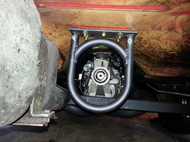

I dug out my old pinion snubber to use on the truck. Not sure how I am going to get some reinforcement fit in there to give the snubber something to lever up onto, though. Cant go crossways because the gas tank is in the way so I need to span the two frame crossmembers longitudinally. The problem with that is it looks like it will chew up room for anything more than marginal wheel travel. Still trying to work that out...

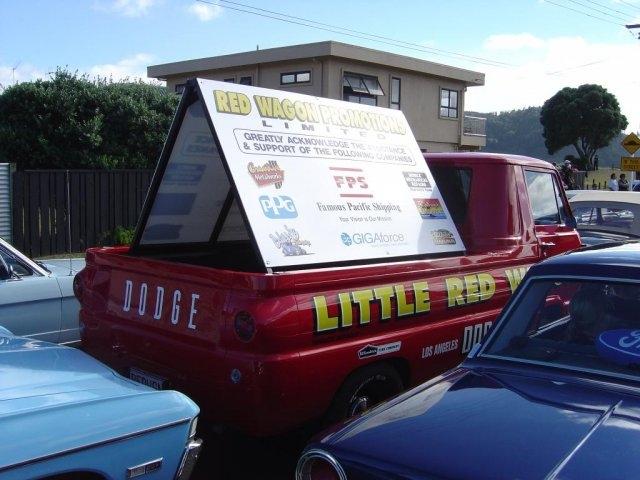

Aaaah....I'm probably not the best person to give advice on that subject.... :rolleyes:
...and from the rear....
Another good one ! Let me ask you something ? How "does" your A100 hook up when your not trying to smoke them ? I go to a show once a year that is held at a small airport . It's a car show / swap meet , and a run what you brung drag races and there a few big block A100's that run there and they have absolutely "no" traction and they spin all the way up the track .
To be honest it's not a fast truck, but once I've finished sufficiently melting the tires, it takes of with very little slippage....probably because I have about 200kg of steel advertising frame in the tray. :rolleyes:
It's a Mobile Advertising Billboard
Well if your going to advertise then that's a great way to do it . lol

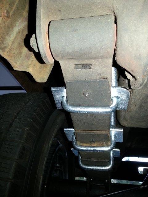

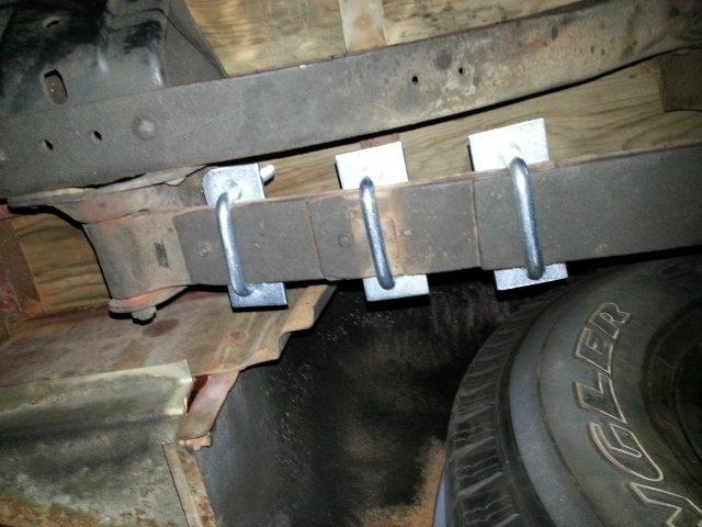

I added 3 leaf spring clamps per side the other night and took a little test drive. Seems like it helped, rides like a 1 ton now. I will probably take the third clamp off of the short overload spring and just put it back on for the strip.

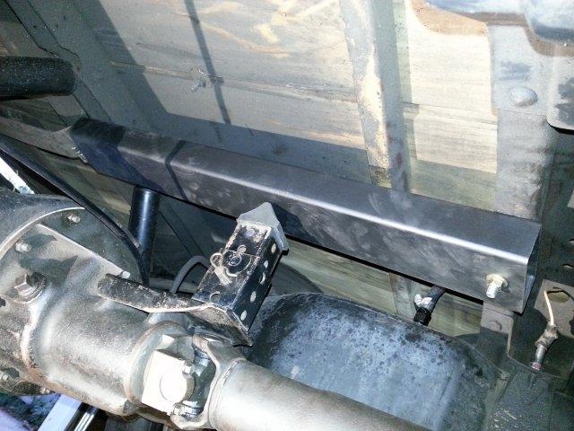

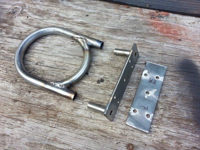

The pinion snubber looks do-able with a little fab work. Should be able to make a reinforcement that bolts to the shock mounts and spans forward to the next crosspiece. That will be a project for this weekend between car shows, I hope
Mounted the slicks, fabbed the driveshaft loop and the pinion snubber crossmember today. Took it out for a quick little test tonight- still considerable wheel spin. I might have revved it fairly high and dumped the clutch, but still... Gonna have to learn how to finesse it off the line. I was really hoping I would get better traction with the stuff I have done.
I have no plans to relocate the gas tank or battery to the rear, so this is about as good as its gonna get before hitting the strip the next 2 weekends.
I will post results afterwards, but the 13 flat I was hoping for might be a pipe dream.
Just got back from the day at the strip. Best time was a 13.49 @ 100 mph. Never managed to get my 60' times below 2 seconds. I hope to get a GoPro attached under the truck to see whats going on with the suspension. I suspect the spring is wrapping up and unloading. It hooks and goes, then the truck takes a hard jar and looses bite.
