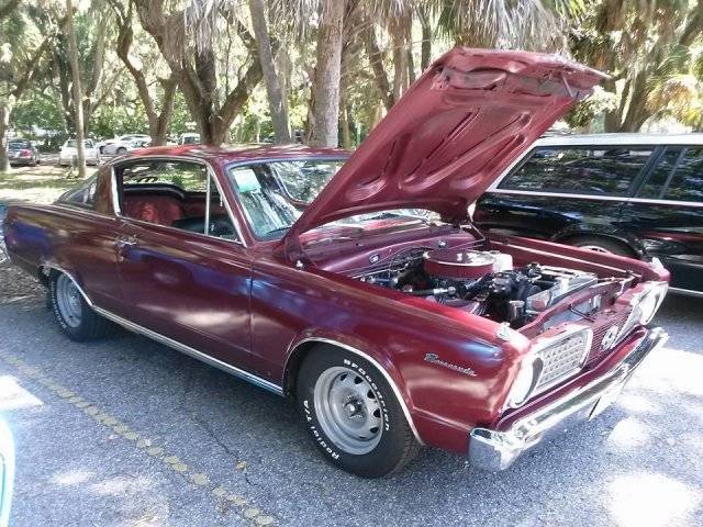

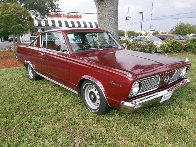

lou that 'cuda a heap??????? Thats a sweet lookin' car! -What for power plant you runnin' in it?
NIICE!!!! Your "touches" I must say are done with taste! Your welcome man, thats a nice ride!

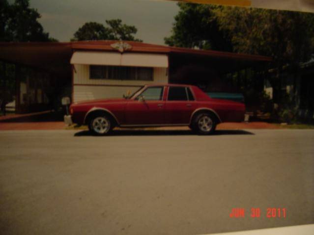

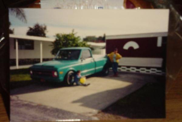

I build working mans hot rods and have been told i have the eye [i suppose] i have built/rebuilt 9 cars since 89 in my little redneck shop. Just a few 69 C 10 - 78 Pontiac Lemans Wagon - 79 Impala

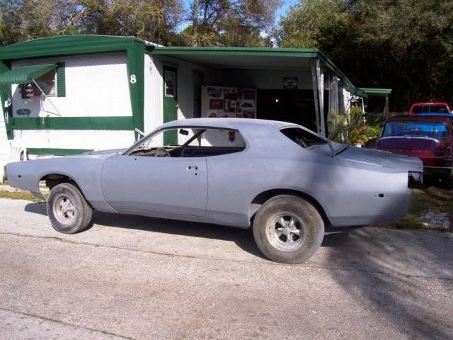

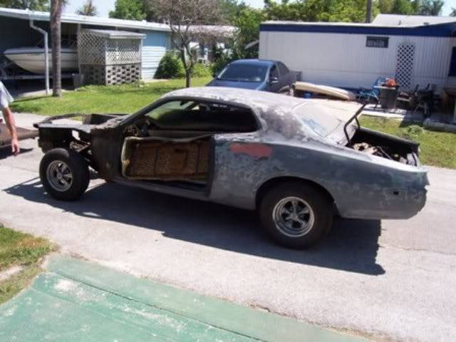

lou, I know the car in the last pic ISN'T complete, but for what it is, and look of it, it has some pretty straight lines. was the body work in bad shape or did you get lucky? -Looks good in the pic!

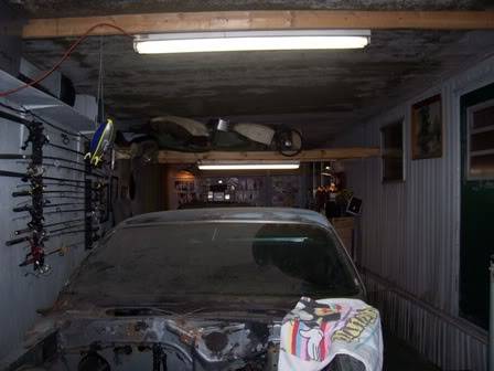

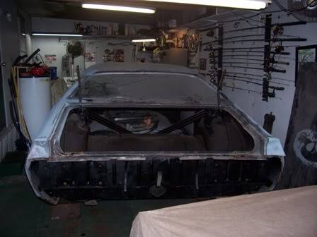

1973 Charger we picked up from a storage bin where it had set for 3 years untouched after the PO took it apart and lost intrest. It was a real bucket i replaced both trunk gutters [purchased parts], both the rear lower quarters and the forward lower quarters, remade the inner cowl on the drivers side, remade the inner fender structure on the drivers fender [rear lower], patched both lower front fenders, patched the trunk floor, remade all four window corners front and rear, remade the inner door sills at the rear corners,patched the trunk lid rear lower corners and filled the lock hole. All panels were hand formed by me and my home made metal shaping tools this took 2 1/2 years to do to this point on weekends and evenings after work, in the photo it was ready for high build primer.
I hand stripped the entire car with a DA and 80 grit paper did metal work one area at a time till i was done, hand stripped the engine bay with a wire wheel and replaced the rusted out metal and filled the firewall [was an ac car but the PO threw away the ac stuff] we were going to go with an aftermarket system.

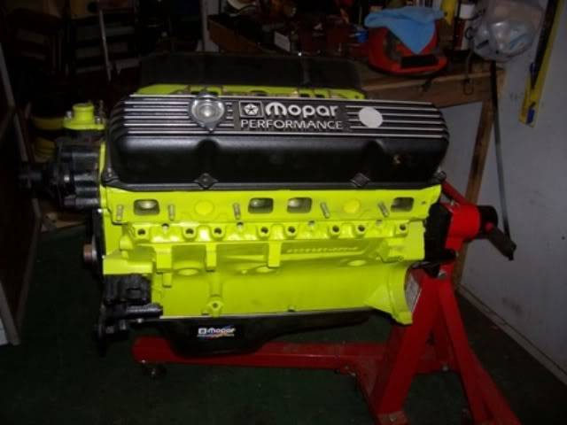

-SO, you had a bit of work tied up in the restoration of that ole Charger... NICE tho!!!! What plant went under the hood?
This a 440 with a 727 auto. [The PO painted it this color] Motor was compeletly redone new everything inside.
The color is a bit.......different but I get it... "Big block or go home"...... damn skippy!
