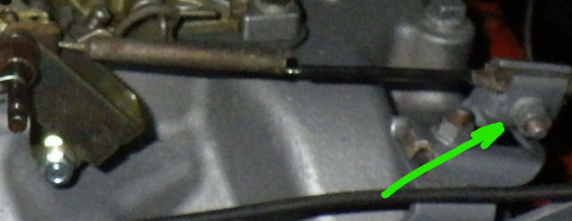

Also there is a extra short screw with a spring on the linkage but I don't know that that there is for either. The truck started right up which was nice and the idle seem steady and not changing with the temp as it goes up. the only issue I have is that the idle is a bit too high and i can't seem to make it any lower. the screws for the idle and adjustment isn't even hitting the shaft at all. It is almost like the cable for the pedal may be allowing it to drop some. I can put a bit of pressure down on the arm and the idle will go down but I don't really want to do that until i can figure out what is going on.
I didn't get a picture of the extra screw in there but it's not hitting anything at all. I installed the carb and let it run for 25 minutes as i was trying looking around trying to see what may keep it for adjusting down for the idle. I didn't even adjust the fuel or air mixture screws as it just started right up.

If the cable is too tight, it surely can prevent the throttle plates from closing.
Pull of the cable.
Hold the throttle against the stop screw.
The cable should slide on the pin with no effort.
If too short, adjust the cable at the adjustment.
