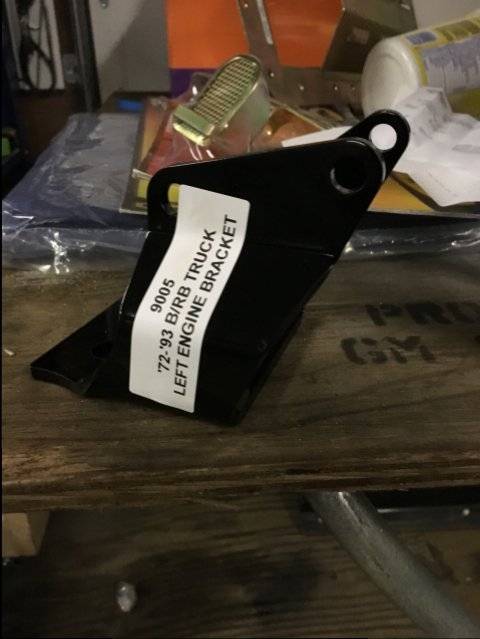

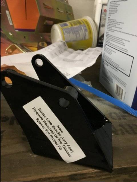

these are the 2wd-4wd mounts that showed up today

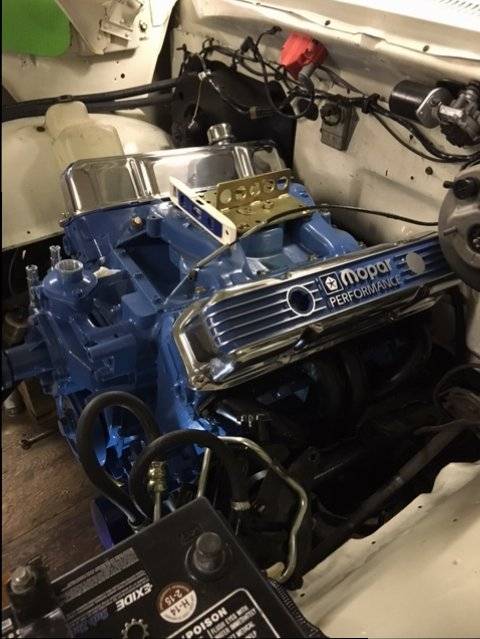

all the mounts seem to fit ok, but the motor dissent fit that well, valve cover is almost touching booster, rh valve cover touches heater box cover plate ( thinking of removing it and heating up late and putting a clearance dent in it..the drivers side header has no room between centre tube and frame rail. i will have to notch upper rail by 1/4 inch for some clearance.. passengers side header has miles of room
The valve cover issue is those MP covers, stock covers fit better but don't look as good as those you have, they are nice! Ah, headers. I hope mine fit better by TV I won't know for years. Maybe someone will come out with a real truck header, that works! That should be a real rocket of a truck once you get all the issues worked out.

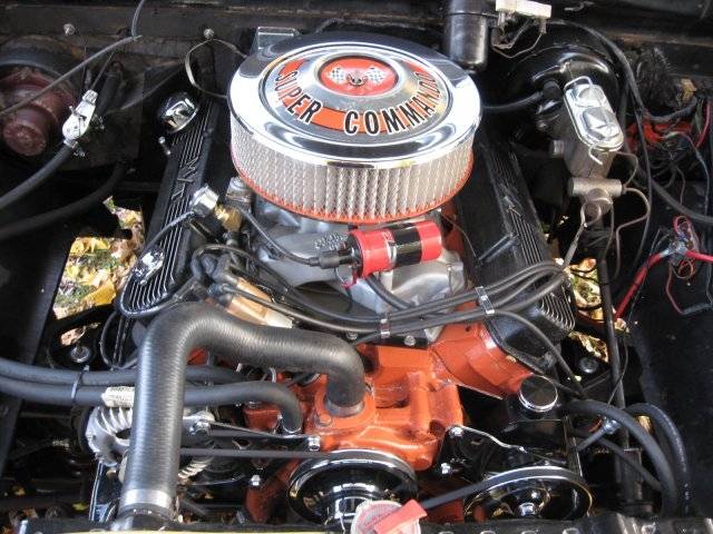

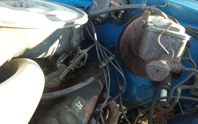

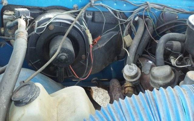

That looks like a small booster. Is there a kit to offset it like they did for hemi cars? Here pictues of the 82 with 360. I would not have thought a 440 would have set that much higher.

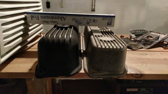

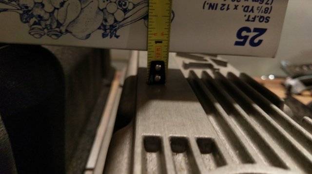

How much taller can the MoPo valve covers be over the Micky T's I run ? I think with the headers , It come's down to quality control . I bet , If he got another set of the same brand , He'd have different issues .
I don't know what I got for pictures of my engine in my build thread but this is how your engine should be sitting .

I'll go.out to the garage and see if I can get to them. If I can I'll take a pic or two.
Roughly 3/4"
Sorry the pictures suck, but you get the idea.

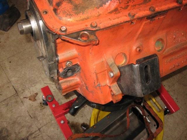

It's sounding like to me either the engine is sitting to high or to far back . Or maybe both . You did put the motor mount bracket's on the back of the ears on the engine , correct ?
Like this

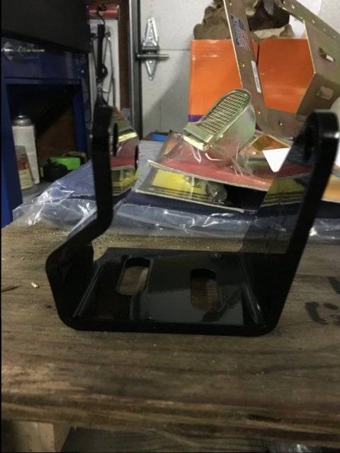

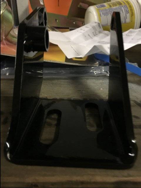

i swapped the engine brackets out today , with the summit ones. engine fits better, sits forward maybe 3/8ths of an inch, cleared heater box and there is more adjustment for engine side to side, the centre for better header clearance... might try oblonging booster holes out to move it up 1/4 inch, to gain some clearance for valve cover
