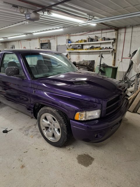

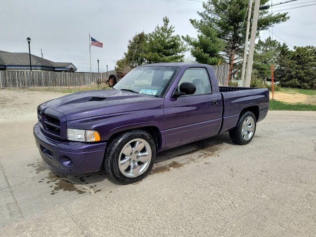

Hey everyone, its been a few weeks. I have some updates
1st, the fuel pump took a crap on me so it's got a new one now, doubt that'll do anything for mileage but we shall see. on my last tank, I averaged 12 mpg, which is better, but still not where i want to be. on this current tank, it's at 10 mpg (just ball-parking with the fuel gauge and the trip odometer, so not entirely accurate) which is partially due to hell once again freezing over again in Iowa, and also due to the header bolts backing out again (I swear, these damn things are going to be the bane of my existence.
2nd, I got some crap done to the truck to help with some fuel economy. the rear is now lowered 4 inches (the front was already dropped 2 inches, just hadn't gotten around to pulling the bed off to do the rear) and the spare tire has also been removed, but has been replaced with a couple of sandbags and my brother's wheels in the bed. it's supposed to warm up again next week and stay warm, so hopefully the sandbags will come out and then i can replace my bed liner with a bed mat.
now, time for everyone's favorite part of the gameshow. the questions
1st (this one is mainly for AJ, but anyone is welcome to chime in), is there a formula or something to calculate mpg improvement from reducing weight? it seems like something like that could be helpful.
2nd, does anyone know how I can get these damn headers to stop leaking? currently, I have grade 8 bolts with the spring style lock washers and tightened the piss out of all of them
