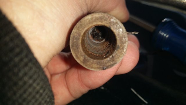

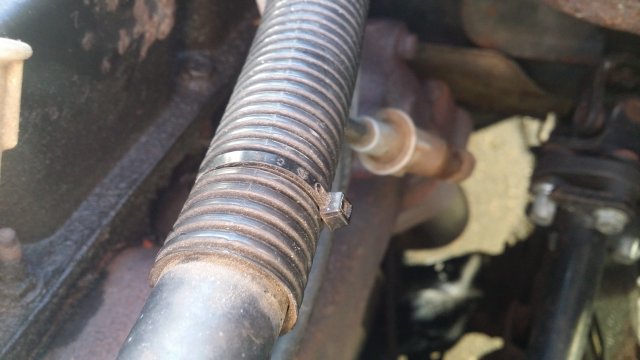

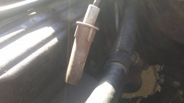

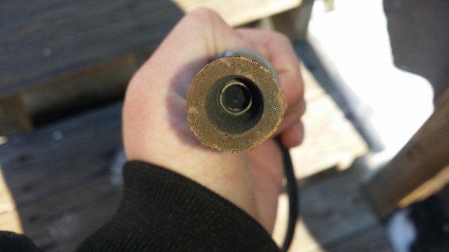

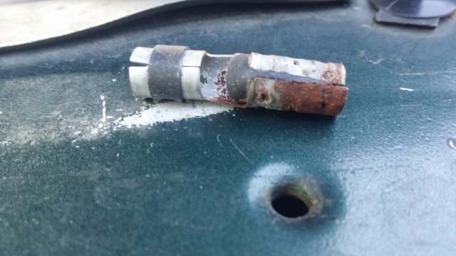

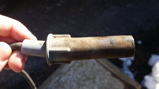

The 5th and 7th plug wires were taken out today but the 5th wire broke, see pictures. However the 7th wire looked kinda nasty inside, again see pictures. We rednecked up a couple '67 318 plug wires to fit temporarily and cleared the misfire code to see if that does the trick, sure enough it seems to. I took it for a ride and no missing while under load and driving at least that I noticed and no check engine light. I think all I'm gonna do is get new wires and plugs and I should be all set....
