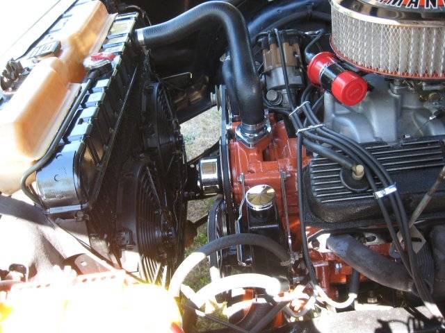

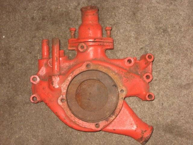

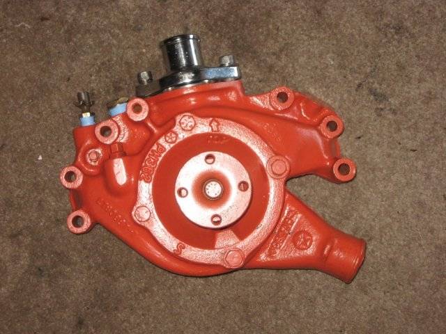

Well thanks to mother nature I had to address an issue that I knew I'd have address sooner or later running this motor . Cooling ! Even though I had a fairly new stock truck radiator , I knew it wasn't going to be enough in the long run but at the time I was building the Warlock's engine , I just wanted to get it out on the road . So I ran with it . Well , with triple digit temps . Lucifer said heck "no" ! I originally had two plans . Either a big aluminum job or the biggest Mopar radiator I could find and make it fit . Well this mint 27" Mopar radiator kind of fell into my lap one day , so the decision was made . It came out of a 69 big block six pack car . It's really about 26 3/4" or something like that . but I just call it 27" to keep it simple . Now you know when building anything , nothing can be as simple as just swapping out a radiator and be done with it . I made the radiator fit and it "just fit" . But now the lower hose was on the wrong side . Mine was on the passenger side and the radiators was on the drivers side . Enters the hunt for a water pump housing . Now normally this wouldn't be an issue . I'd just go into my stash and grab another housing . But "surprise" , the three totes that I had full of housings were gone and all I found was this early wedge housing . The water neck is on the correct side but the alt. bracket is different then the one I have on the truck .
So the hunt is on for the correct housing . Enters a buddy of mine and say's he has what I need . After waiting about three weeks he finally calls me up and says he's got it . I go grab it and bring it home . But something doesn't look quite right . There's no upper ear for the power steering pump bracket .
After looking high and low for a housing I could use , I ended up robbing the one off of my wife's 383 HP motor I have on the stand . With the promise that I would return it as soon as I eventually get another one for the 440 . So thanks to her , there's no more running hot issues with Lucifer . Personally I think the swap came out pretty good , If I do say so myself . I think everything look's like it belongs there . lol

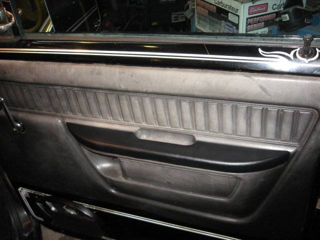

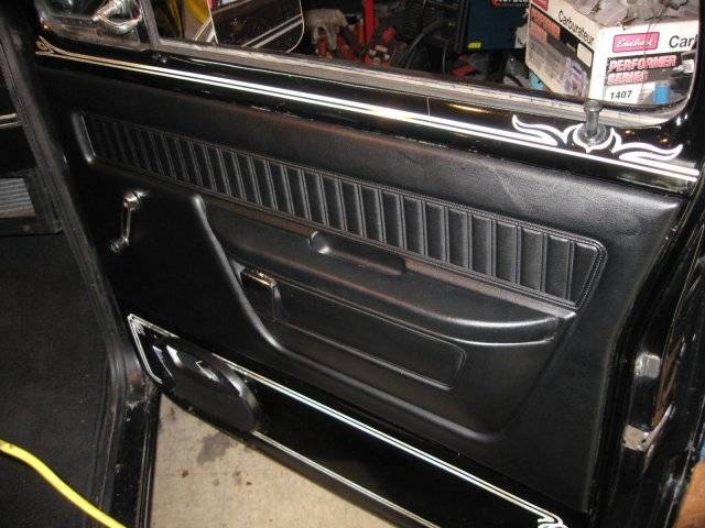

I also got kind of tired of looking at those sun baked door panels . So I decided to recolor them and fresh'in them up a little . Here's a before and after shot .
