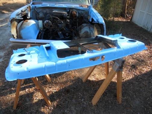

Got the motor and transmission back in the truck(last summer). Treated and painted the core support I got from the junkyard.
Drove the truck around just a little. Adjusted the throttle pressure linkage. Shifts fine. But, I've taken it off the road for other work.
