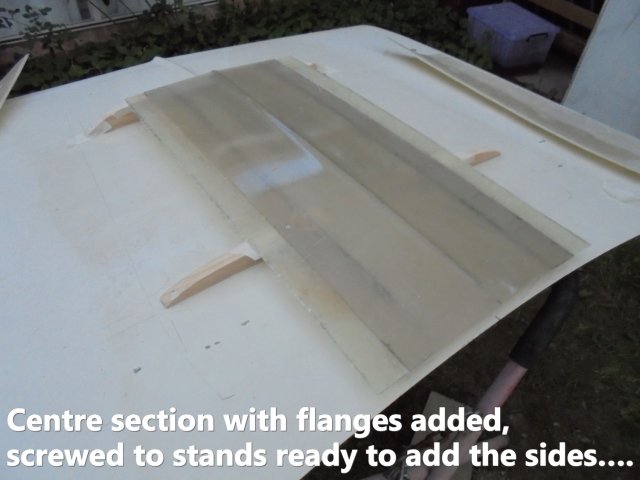

the two halves of the hard cover are joined.....

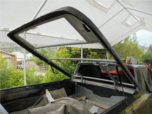

sitting in place on the ute....sides need to be trimmed to size

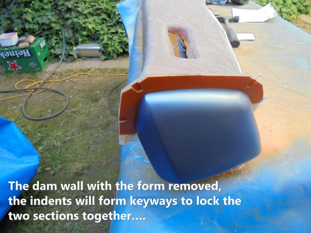

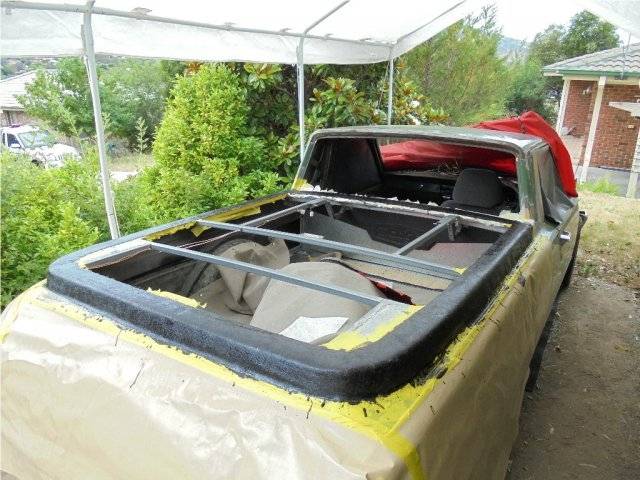

next stage is to make the rolled edges....these will be made by casting a rim around the entire tray then bonding the top to it in place on the ute

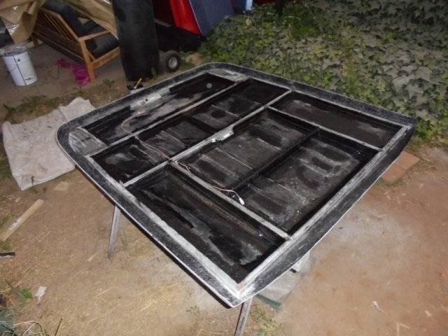

the sides for the hard cover have been cast from the body of the ute and bonded to the frame....a week later it was removed and the top section bonded on, the sides were then strengthened and the frame fully attached to the frame...just have to finish the sides ready to prime...

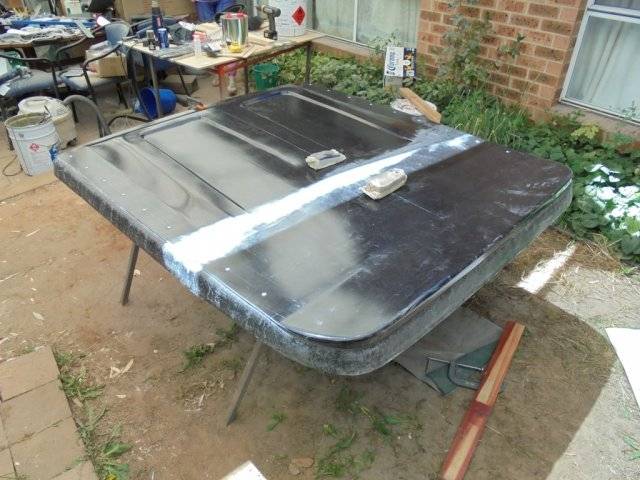

hard cover is now primed ready for final block back...had to get it back on the ute for a couple of day as the court yard is back to being used as an entertainment area instead of my work area! I will make a liner for the underside of the cover before finishing off the sanding...quite happy with the results but I think after all the work that has gone into it I fell a bit "is that all" when I look at it.....think I will be happier once I'm on to other parts of the ute, spent so long on the cover!!

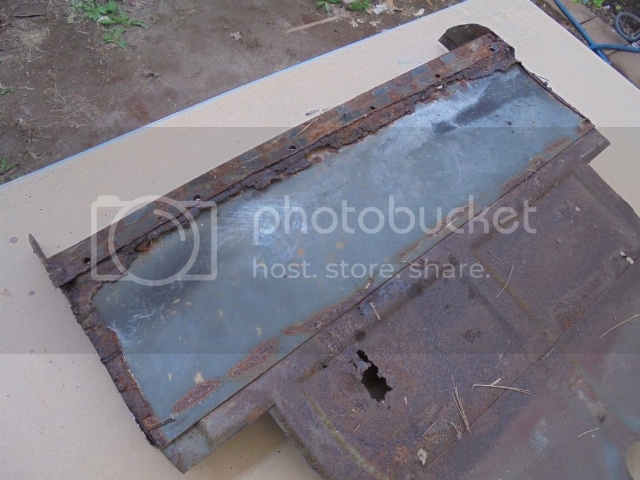

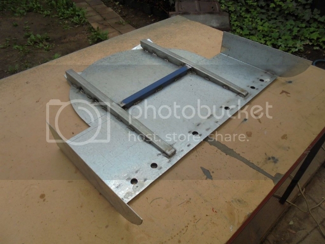

back onto the steel work....the spear wheel well had a bad repair or two done in the past and had a couple of other problems so the whole floor was removed

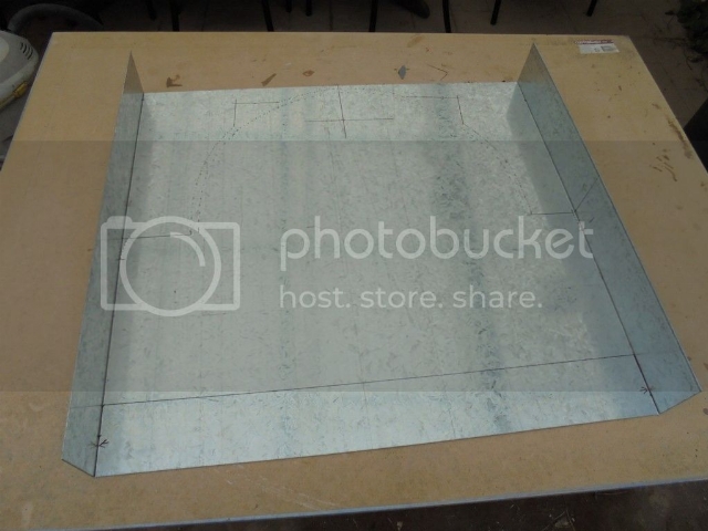

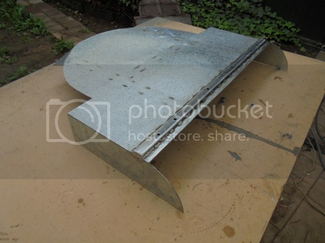

I had a piece of heavy gal folded which I then cut to size

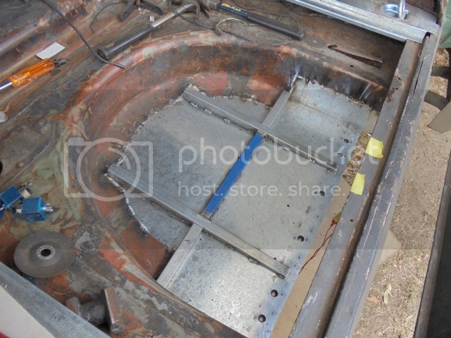

I cut a section of 25mm box to make the mount for the door hinge
cut some 25 x 50mm box to make the ramps for the wheel to slide on then cut some more 25 box for the cross brace...
tacked back in place...should finish the welds this weekend...

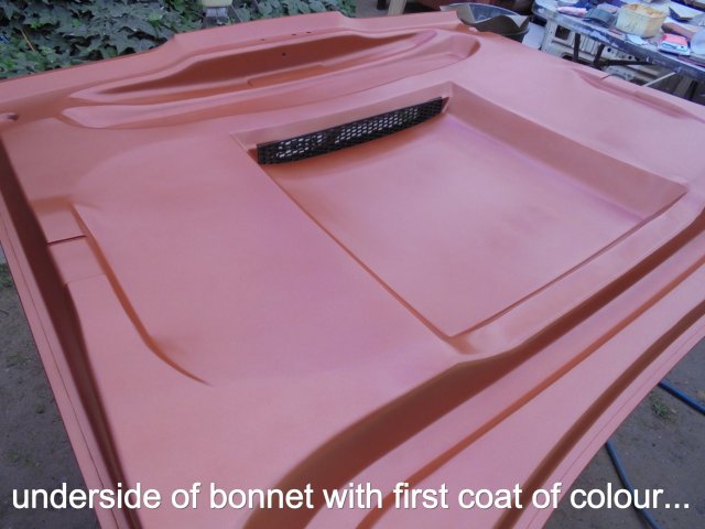

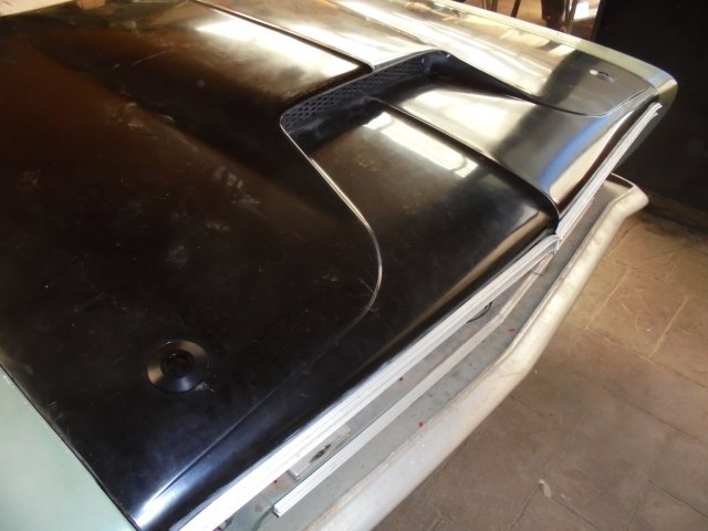

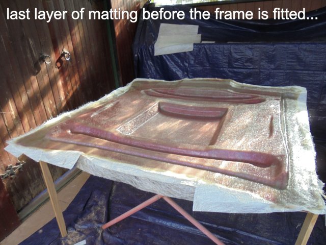

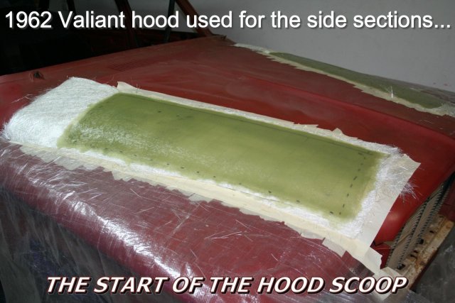

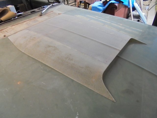

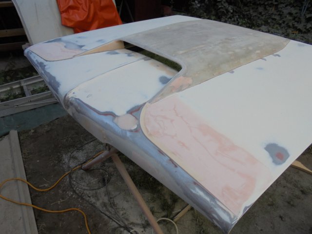

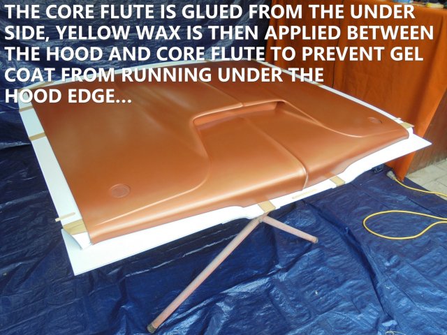

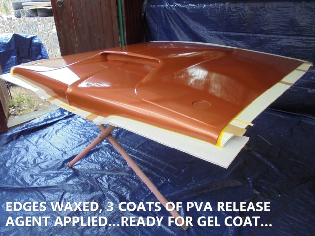

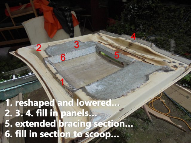

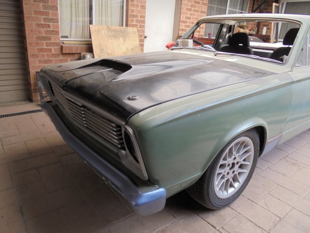

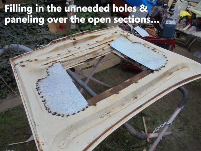

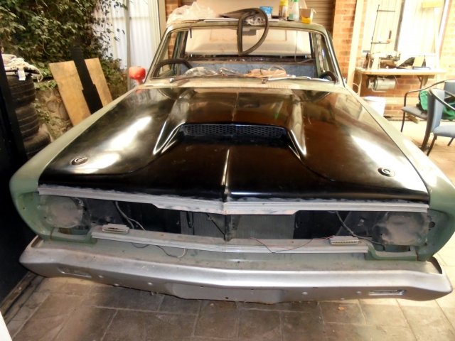

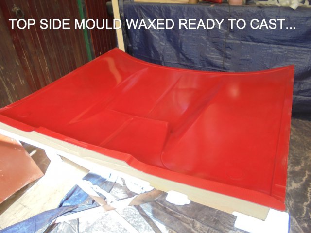

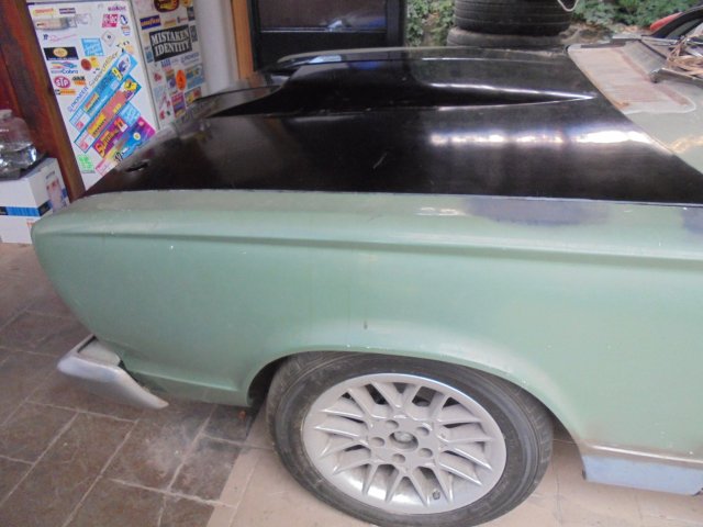

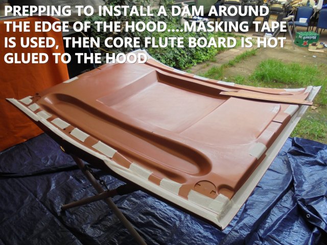

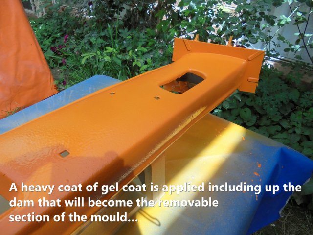

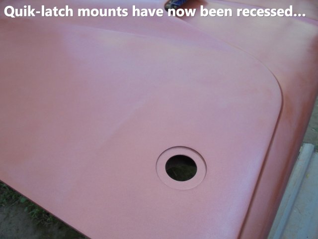

Well I had forgotten about this site for almost 5 years!! A lot has happened in that time as this build has become the most involved I have ever started. I'll recap some of the work done in that time. I'll restart with the custom fibreglass hood I made. This post is all the mods to a spare hood I had, and takes the work through to the point of ready to make a mould from.

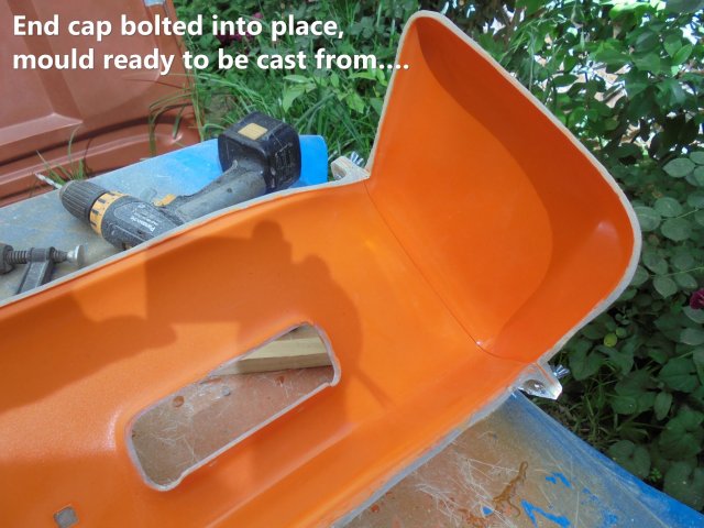

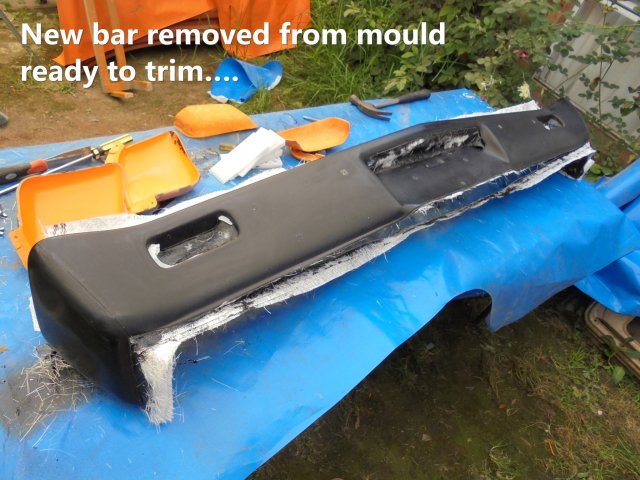

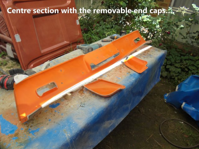

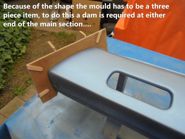

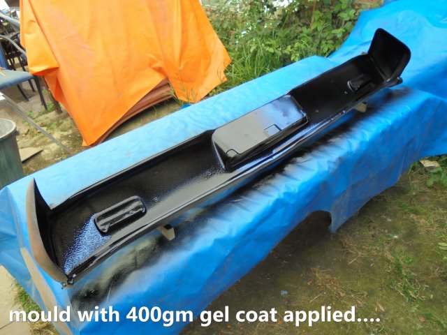

thanks 65 sporty....I wanted a custom front bumper but didn't want to modify the Dodge's bar and couldn't find a Valiant bar to work with. So it had to be a double job. Make a mould of the std bar, cast a new bar to modify. Once all the mods were done, make a second mould and cast a new custom bar. Months of work!! The new bar has a Frenched in number plate, the corners have been brought in close to the body, no mounting bolts, top edge has been rolled, and the bottom edge extended to come close to the spoiler I later made, posts to come.
