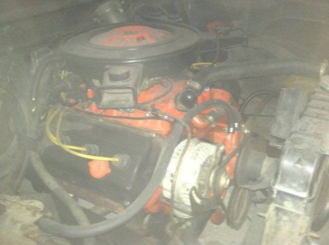

This is about where I am with it today. There has been a little more progress, but just small details. I am held up at the moment by a pretty large purchase. The adapter plate and flywheel kit to mate the 833 OD transmission to the early Hemi bellhousing. That's about 750 dollars. A big chunk for us all at one time, but it'll happen in time.
All of this has taken me about four years to date, so it's not something I have been able to just sling together be any means. It's a lot of hard work and sometimes it's hard to see progress. Posting it up like this helps though because I can look at it and see how far it has come. Hope yall like it so far.

I joined The Hamb shortly after acquiring the Hemi. I thought it would be a good place to get some pointers on an unfamiliar engine. All of them adamantly told me that I could not build a budget Hemi.......there was no such thing.
I have proved them wrong, believe me. I will not disclose what I have in it, but it is well under the 3K dollar mark. I will admit I had a fantastic core to start, but I have pinched every penny where I could.

341 desoto-neon plug wires-318 timing cover and pulleys-318 electronic distributor with desoto shaft 440 air cleaner in my 77 brown warlock

Yeah me and you both. Just kinda worked out that I kept it. And get this.......guess what motor mounts I am using? Remember that whole set of truck 318 mounts you sent me? Yeah. Those. All I had to do was saw one corner hole off the driver's side mount on the rear side and move it to the front and weld it on. BAM, bolt in swap.
