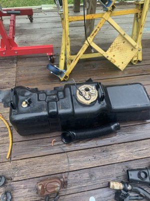

Yes, a plastic gas tank . Looks like this below…

I’d like to, if possible, use an older gas tank. The engine is no longer fuel injected and the wiring harness is backed to bits. It would be easier for me to step backwards in tech, AKA, old school ways for this old fart, rather than to rewire the truck for fuel injection.
