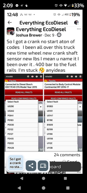

So I got a crank no start aton of codes I been all over this truck new time wheel new crank shaft sensor new Ibs I mean u name it I been over it . 400 bar to the fuel rails I'm stuck 🤔 anyideas
