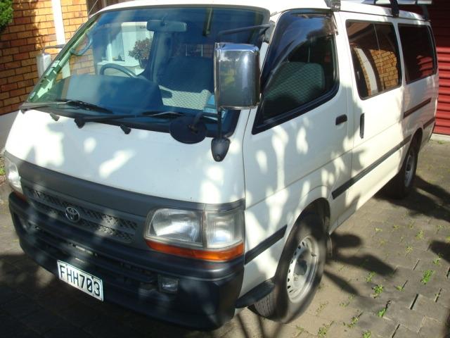

Sorry I cannot offer anything useful here Cranky....but if it helps, my Toyota has a whine akin to a police siren when I decelerate at low speeds. (my kids always look around thinking the worst) And my van gets regularly serviced. Is the noise 'normal' within tolerance, or is it excessive to the point of being annoying?
Here's a shot of my van...."forward control" - engine under the seats. 3.0-litre diesel, auto + o/d and power front windows with central locking....means you can eat a pie while you're driving. :rolleyes:
