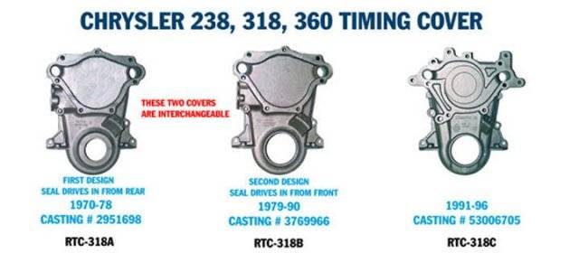

I bought a 95 Dakota with a 318 in it. Will the serpentine belt set up on it fit an older model 318?
If the crank pulley will interchange? Water pump will need to be updated as well as accessories.
Water pump will interchage. The accessories maybe the biggest problem. On the 95 the accessories should mount on a bracket mount to the heads and engine block.
No I have not tried it but have looked at it.
If you have a couple hours try it only thing that can happen would be buying new gaskets which you would need anyway if it works.
It may be too late but thought I would add my 2 cents worth. From my experience with this swap you need everything from the timing cover forward. So timing cover, water pump, accessory brackets, accessories, pulleys, harmonic balancer with some applications, and the bolts of course.
There are different mounting locations and bosses on the 91-96 engines. Also I believe the rotation is different.
The serpentine belt uses a reverse rotation water pump, if you don't use it you will have over heating issues with the serpentine belt set up. It's best to get everything off of the motor your getting the belt setup from. Just like AdventurerSE said above
