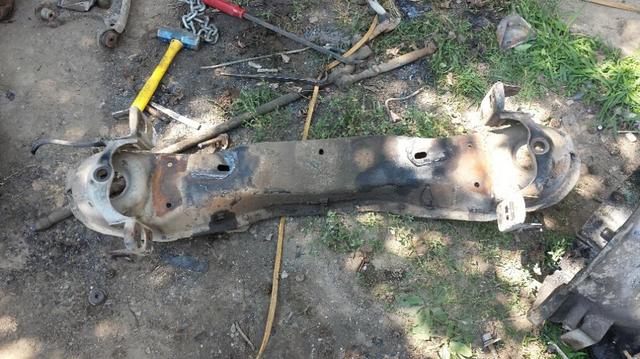

The first time I mocked up what I'm doing I used a 94 Plymouth Sundance Rack A Mustang rack would mount easier & you can get any size & length tie rods for them
