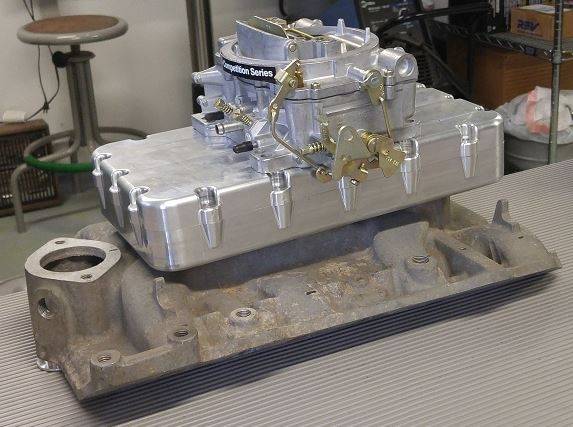

You are doing with your engine what I did to mine. My 65' Utiline was a stock slant and 3 speed column shift. I bought a running, well-used Poly for $100 that has 110,000 miles on it. So I cleaned it up, tuned it up, replaced the freeze plugs, replaced valve stem seals, etc. I'm just now putting it in my truck. I have also made my own adapters and have 302-351 Ford headers. I also made a single 4 barrel adapter to fit an offenhauser 3 2-barrel manifold. The last thing I did was adapt a Mustang T-5 -speed to it. I'm planning to change the T-5 to a TKO 500 though because the T-5 even when built to handle decent HP is a bit noisy and can still have breakage problems. I have a 2nd Poly I'm building while I drive the stock engine. Good Luck on yours. - EM
How did you do that? Does it still have the 3 pads for the 2bbls?
Yes. See attached picture. -EM
That's much better than what I've seen when people attempt to modify a multi carb intake. Have you used it yet?
I have not but don't really expect any issues. I may end up experimenting with some type of shroud over the center carburetor ports to allow each location to draw an even air/fuel amount. I will run this for a year or less and will change to my new poly, new larger valve heads and will change the top of the plenum and add a magnuson supercharger. Nothing crazy in size but it will add another 30% to the 350 HP the new engine will have. So, somewhere in the 475 HP range when all is said and done. - EM
