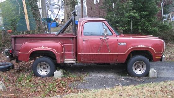

This is a profile shot of it. It has rust, probably every panel on it has something wrong with it, the engine hardly runs as of now and theres a power drain somewhere in it. I dont think we'll ever restore it due to it being to far gone, but were going to get it back to running and in decent shape so we can still enjoy it!

I think it's a keeper ! I like it ! As far as the power drain . Check to make sure your not leaving something on . One of the things you can check is to see if your brake light switch is sticking from sitting for so long . I had a Ramcharger do that to me one time . It drove me nut's because it wouldn't stick all the time .

You say power drain, how seriously? If it drains the battery in less than a day, then most likely it's a bad diode in the alternator. Remove thelargest wire from the alternator and see if the battery stays up. If so, then that's the problem. Remember that the largest wire goes directly to the battery and is hot all of the time, so make sure it doesn't touch any metal part of the truck. If the drain is slower, the first thing to do is disconnect the battery and if it still goes dead, then it's new battery time. Remember that many accessories have a continual current draw, such as newer radios. That's what keeps the preset stations memorized by the radio.
Welcome to the site, that is definitely a keeper, at least you will be enjoying driving it. Keep checking around to see what is being parted out and you will pick up a few bits and pieces to keep the old girl on the road.
